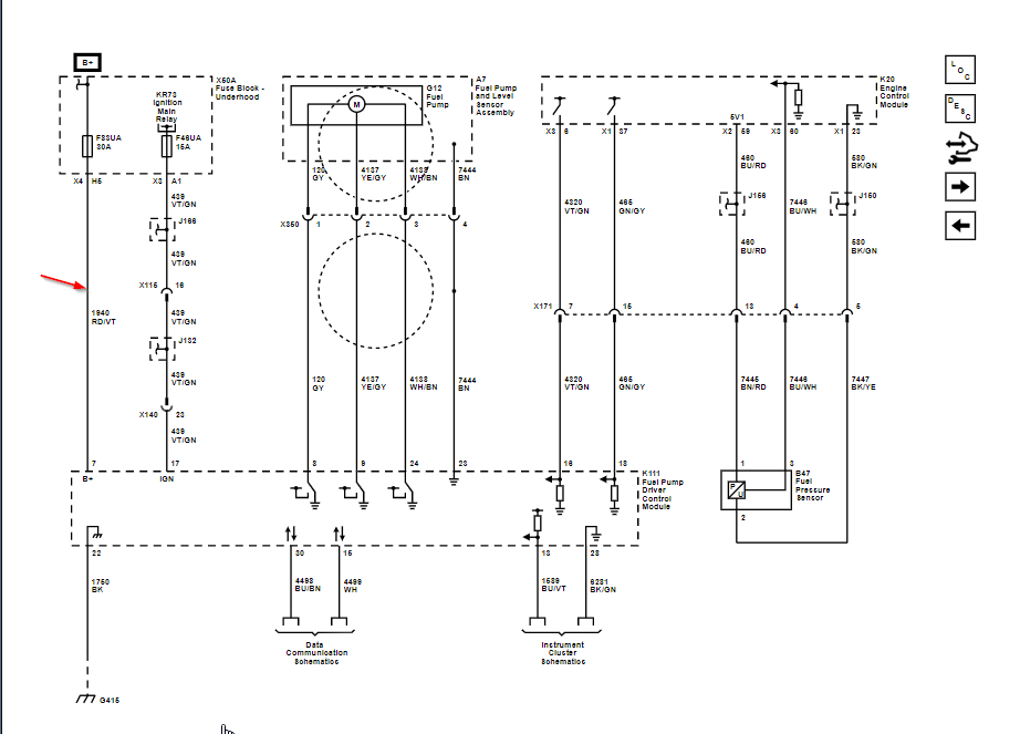

Is it possible to install a kill switch on the new generation 2020 Silverado? There doesn't appear to be a fuel pump fuse anywhere or a stand alone ignition fuse for that matter. Thinking things may be going thru the BCM. Anyway, any thoughts on where one might wire a switch?

Can you give a little more detail about why you would want to do this? It can be done but if it is for security reasons, it may not be needed. The only way someone can steal this truck is with your key. If you are worried about that then I can understand this switch.

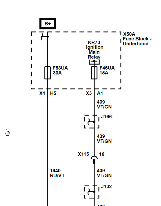

Also, I am assuming you want this wired to the fuel pump so that you have to have the switch on to power the fuel pump? If so, just mount your switch where ever you want in the cab and then run the wires to the B+ wire for the fuel pump which is shown in the wiring diagrams. Cut the wire and splice in each wire from the two position switch you just installed and now the only way the fuel pump control module gets power is when that switch is on.
I also attached a close up view of the fuel pump module fuse which is the fuse for the fuel pump as well. Everything is run through a module these days and in this case it is the fuel pump driver module.
Let me know if you have questions. Thanks
