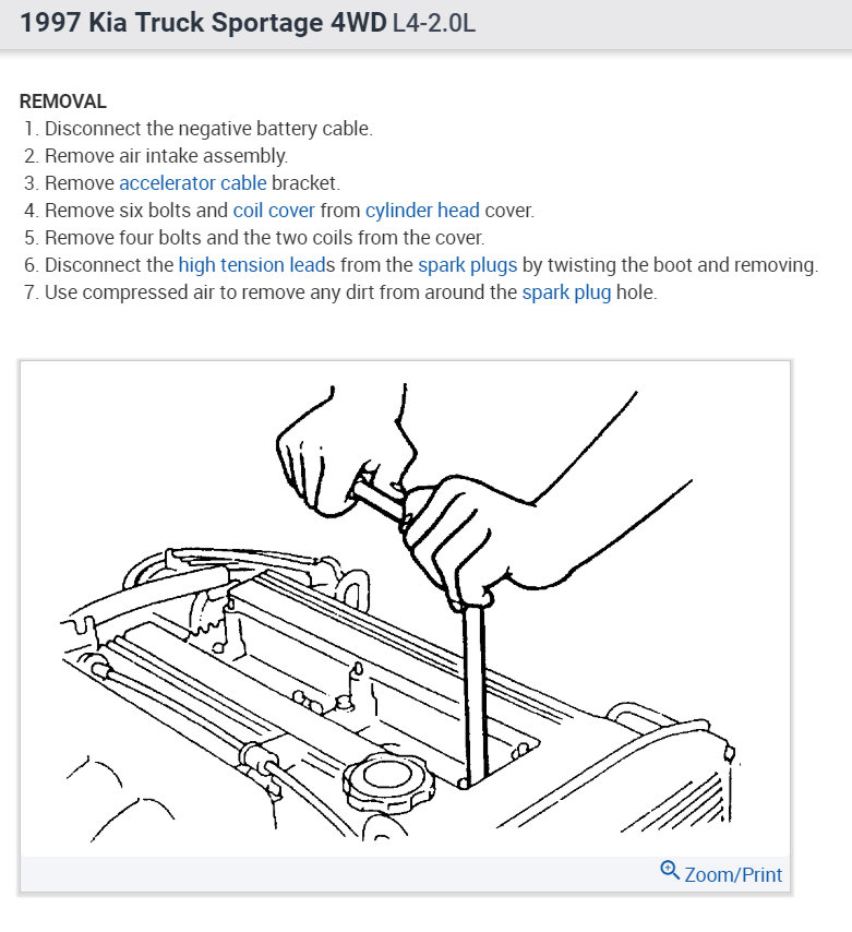

How many spark plugs are there and how to get to them?

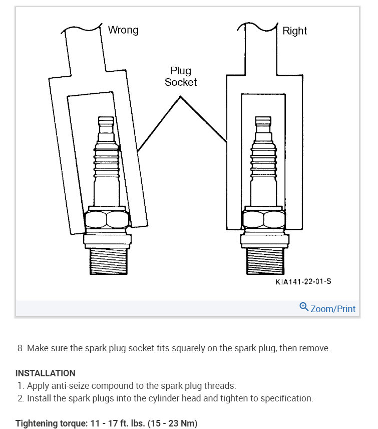

Here is a guide and a video of the job being done on a similar car with diagrams below to show you how on our car.
https://youtu.be/jvWqrAFQQmg
and
https://www.2carpros.com/articles/how-to-change-spark-plugs
Cheers
