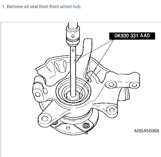

I have a 2004 Kia Spectra that is making a grinding noise from the front wheels. My mechanic told me today that it needed a new right front wheel bearing and it would cost $265 installed. Is that reasonable? I am supposed to have a 10 year, 100,000 mile power train warranty with Kia but don't know if it would cover the wheel bearing. He also said I have an oil leak at the valve cover that would cost $125. Again, reasonable? I have been smelling what I thought was gas in the front compartment when first starting the car up but he says it is probably the oil on the engine.

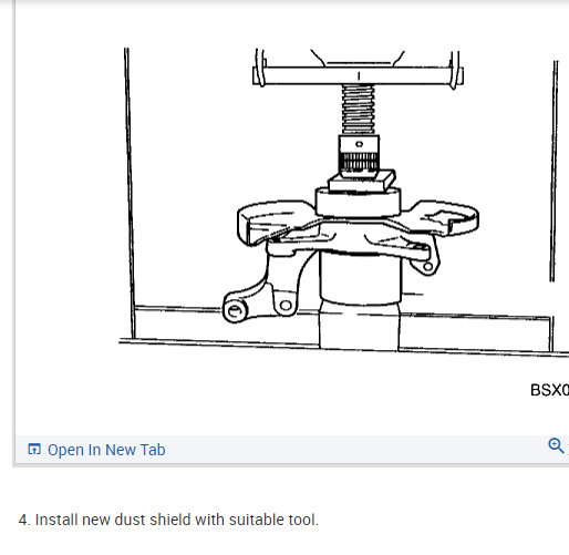

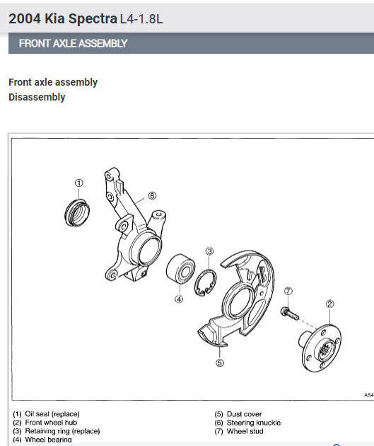

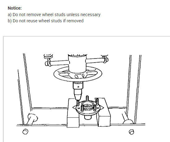

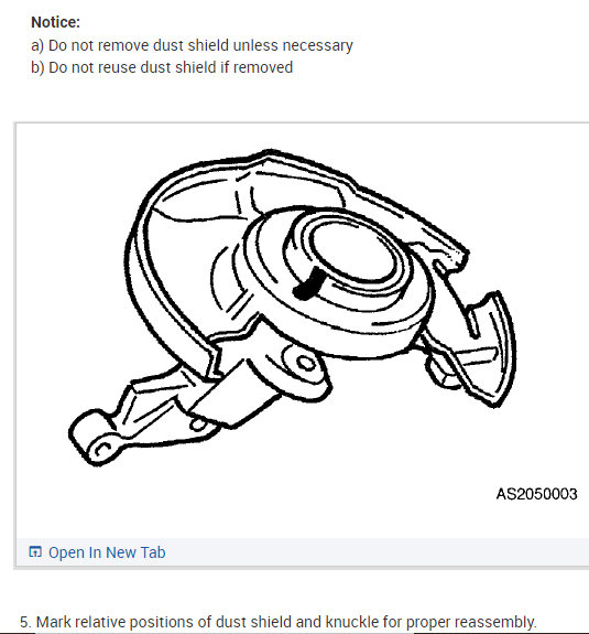

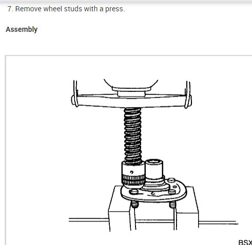

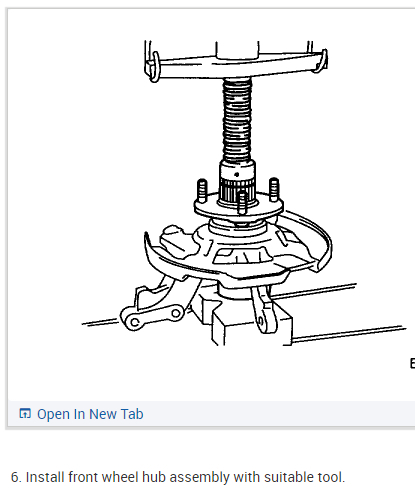

Yes, those are reasonable prices for the repair it's both covering parts and labor. Most shop labor rates depending on your area is $100.00 an hour. Here are tutorials for you to view regarding wheel hub and valve cover gasket replacement:
https://www.2carpros.com/articles/bearing-hub-replacement
https://www.2carpros.com/articles/replace-valve-cover-gasket

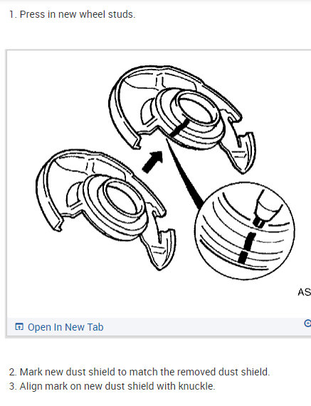

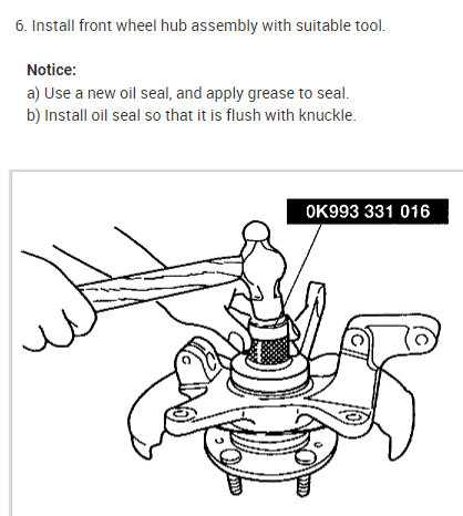

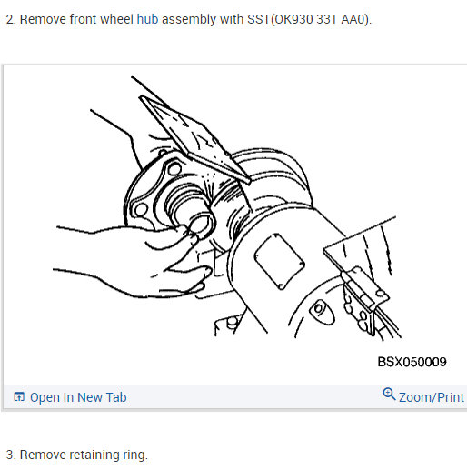

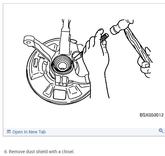

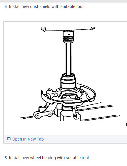

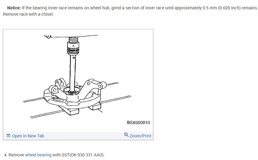

I've attached picture steps below for wheel hub replacement for your vehicle. Hope this helps and thanks for using 2CarPros.
