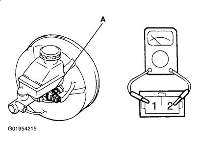

At first I noticed it if I put the car in gear and then took the emergency brake off. I stopped doing that and the light went off for a while. Now it's back on. I'd say 97% of the time it's on. Every now and then it's off. Do I need to worry about this? The brake is, obvsiouly, not engaged and I don't feel any difference in the driving or steering. Don't want to pay lots of money if it's a fuse or something.

Hello - Thanks for the info and getting back with me. This may be a couple of things - let's start with the easiest. Please check your brake fluid level and make sure it is at the proper level. The way your system works is if your brake fluid gets a little low, then the light will stay on. My thought is that is why it was on then off etc. So first check that. If that isn't it then it may be the switch....here is the test for checking the switch......... BRAKE FLUID LEVEL WARNING SWITCH 1. Remove the connector (A) from the switch located at the brake fluid reservoir. 2. Verify that continuity exists between switch terminals 1 and 2 while pressing the switch (float) down with a rod. Fig. 20: Testing Brake Fluid Level Warning Switch Continuity Courtesy of KIA MOTORS AMERICA, INC.
https://images.2carpros.com/forum/automotive_pictures/248015_Fig_20_1.jpg
Check the fluid first and then see how it does........if the fluid is okay then do the above then let me know.
