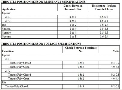

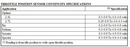

Well, if it were a fuel pressure problem, the symptoms would be the other way around. Good performance at low revs and poor at higher revs under load. I'm assuming you have not had a "check engine light". A problem with the cam sensor will usually trip the CEL, but many times a bad throttle position sensor won't. I'll see if I can find the TPS test specs and attach them to this post. I now sounds like the TPS may have a dead spot in it.

I do have CEL, codes P0300, P0301, P0302, P0303. Just misfire codes. Would a bad TPS cause misfires like that? Thanks for the spec sheet, I'll test the TPS as soon as I get some daylight.

Ok, TPS was slightly off the numbers you posted. I replaced it and cleared DTC codes. Started it up and it ran (didn't stall immediately like usual), but still very rough. After a couple minutes the misfire codes came back (cyl 1 & 3)

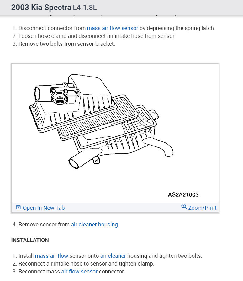

Working on my parents 03 kia spectra that has same misfire issues. The more i messed with it the more random the misfires became, especially on cylinders 1 and 3. Started looking at the coil pack harness connector and noticed one wire wasn't pushed in as much as the other wire. Come to find oit the connector has deteriorated and is falling apart. Hoping that will fix my misfires
Feb 17, 2019 at 11:07 PM
  • 55,433 POSTS
Yep it sounds like it will. here is a guide that can help. I have seen a bad MAF sensor cause this issue as well, check out the diagrams below.
and
https://www.2carpros.com/articles/how-to-replace-a-mass-air-flow-sensor-maf
