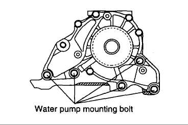

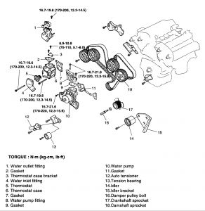

How do I R&R the waterpump on a 2004 Kia Sorento
Sunday, September 19th, 2010 AT 1:36 PM

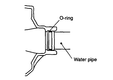

REMOVAL
Using the drain plug, drain the coolant.
Remove the drive belt and the engine coolant pump pulley.
Remove the timing belt cover, the auto tensioner and idler pulley.
Remove the water outlet fitting, the thermostat case and the water pump fitting.
Remove the engine coolant pump mounting bolts.
https://www.2carpros.com/forum/automotive_pictures/12900_w1_5.gif
Remove the engine coolant pump assembly from the cylinder block.

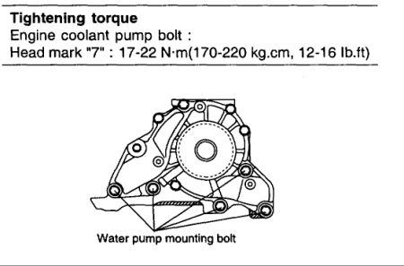

INSTALLATION
https://www.2carpros.com/forum/automotive_pictures/12900_w2_8.gif
Clean the gasket surfaces of the engine coolant pump body and the cylinder block.
https://www.2carpros.com/forum/automotive_pictures/12900_w3_9.jpg
Install the new engine coolant pump gasket and pump assembly. Tighten the bolts to the specified torque. Tightening torque
Engine coolant pump bolt:
Head mark "7": 17 - 22 Nm (170 - 220 kg-cm, 12 - 16 ft. lbs.)
Install the water pump fitting, the thermostat case and the water outlet fitting.
Install the auto tensioner and timing belt. Adjust the timing belt tension, then install the timing belt cover.
Install the drive belt, coolant pump pulley and then adjust the auto tensioner.
Refill the coolant.
