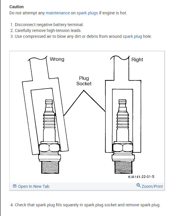

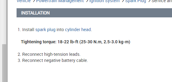

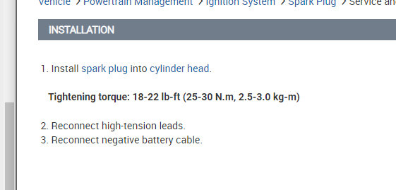

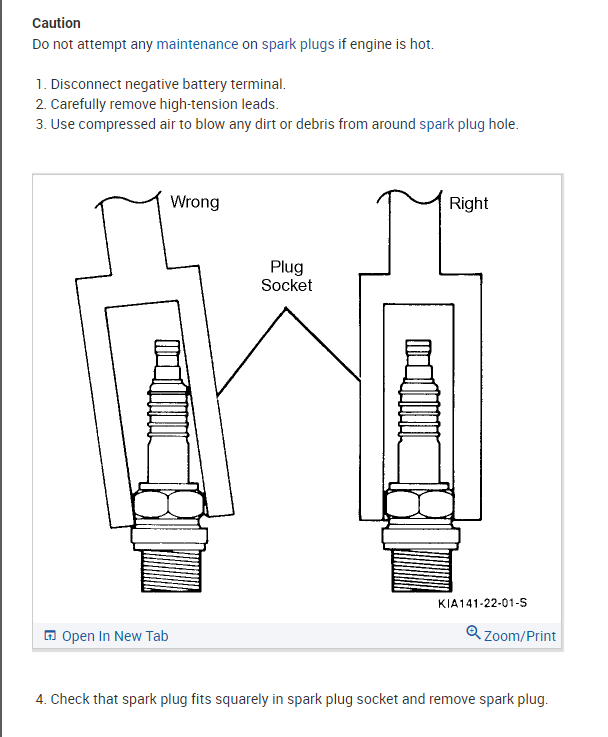

Is the spark blue in color? Sounds like the ignition system is shorted to the block and it is just arching across the balancer. That would be the only spark that would increase with RPM so I would suggest running through this guide and making sure you did not leave a plug wire disconnected.
https://www.2carpros.com/articles/how-a-harmonic-balancer-works
I attached the process below as well for the plugs that will help with any info on this.
Please let us know if you have questions on this.
Thanks
