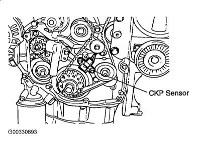

I keep getting a P0303 code. I have changed plugs, wires, coils, and injectors, and the code keeps coming back. The code always comes up twice if this means anything. The spark plug looks fine. I will check compression this weekend. Assuming that this is good, what next? The car runs and drives good. Help!

check/clean or replace the CKP CRANKSHAFT POSITION (CKP) SENSOR The Crankshaft Position Sensor is a Hall-effect sensor that senses the Crank angle (piston position) of each cylinder and converts it into a pulse signal. Based on the input signal, the ECU computes the engine speed and controls the fuel injection timing and ignition timing. Fig. 107: Locating Crankshaft Position (CKP) Sensor

I only have one CRANKshaft position sensor listed for the 4 cylinder model ... (you may be getting mixed up with the CAMshaft position sensor) .. the CRANKshaft sensor is located behind the timing belt covers just above the crankshaft/timing belt pulley and has a long wiring harness going up to the top of the engine .. this can be a very tricky part to replace as you have to thread the wiring loom .. the book time (labor) for this repair/replacement is 2.7 hours ! Hope this helps

Thanks Dave. I took your advice and replaced the CPS, as well as the timing belt and balance shaft belt. 2.7hrs? Wow! Let's just say that it took me that long to remove it! Anyway, the code is back. Any further suggestions? If it means anything, I will say that the low idle after the car is warmed up fluctuates a little bit, but it always has.
