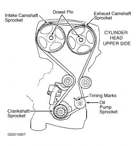

replacing timing belt. How do you adjust timing on vehicle

Put engine no.1 piston on its compression stroke align markings as you see below before you put the belt on.
