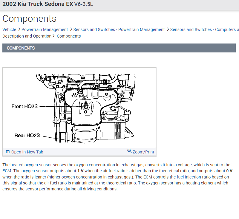

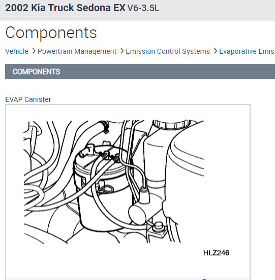

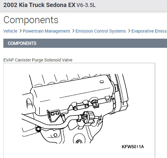

Warm up catalyst efficiency below threshold (bank 2) and evaporative emission system leak detected (gross leak/ no flow.
Sep 13, 2021 at 10:57 AM
SQM
  • 6,383 POSTS
The warm up catalytic efficiency below threshold typically points to a bad oxygen sensor. You should have 2 oxygen sensor on that bank 2 (sensor 1 and sensor 2). The code number will tell you which one might be the issue.
https://www.2carpros.com/articles/how-to-test-an-oxygen-sensor-02-sensor
The EVAP gross leak typically points to a cracked hose in the EVAP system, it can also be the vent valve staying open all the time. Any time a 'gross' leak is detected it is due to a large enough leak that the EVAP system cannot stay pressurized.
https://www.2carpros.com/articles/evap-system-code-repair
Let me know what was those code numbers and I can provide you with he factory recommended diagnostics to get this resolved.
