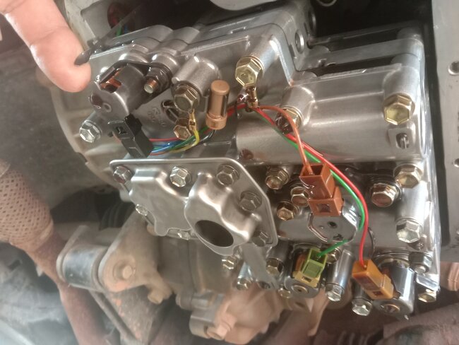

When the fluid was changed the pan and filter were removed and cleaned. The attached pics are of the solenoids.
If replacing solenoids is considered necessary, then I need a recommendation for a reliable supplier that will ship with an online order. Solenoids are not available from parts suppliers locally.

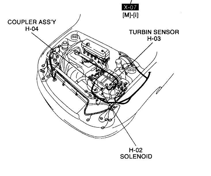

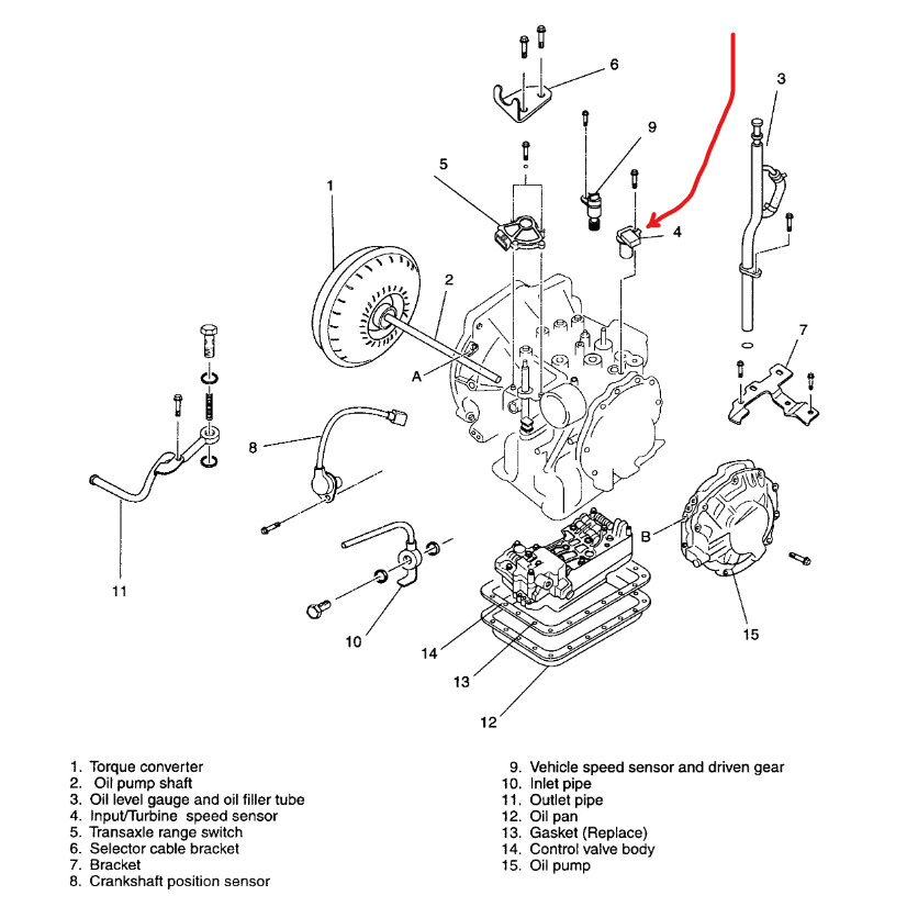

I have seen the turbine shaft speed sensor go bad and not leave a code. here is the location for the sensor so you can check it out. Check out the images (below). Please let us know how it goes.
Jul 17, 2023 at 6:59 AM

Hi Ken, Thank you for your prompt reply.
You suggest replacing the Turbine Shaft Speed Sensor.
Does the gear shifting behavior that I describe match the symptoms of a failing TSS sensor?
I ask because I do not have access to car parts stores that you enjoy in the USA. Parts usually have to be ordered online from more developed countries.
Do you have a part number etc., that I would need to order this part?
I cannot see the sensor, I need to remove the air filter box/duct, battery support, coolant water hose etc., to gain access. If I have difficulty identifying it, I will send pics.

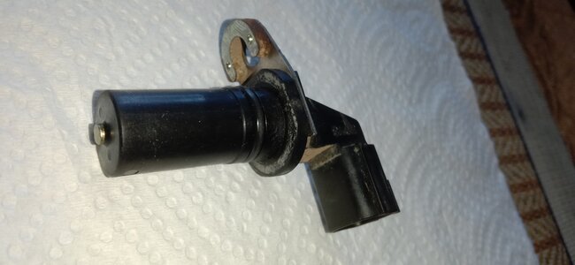

In heavy rain I got the sensor out, pic attached.
Can you tell me if this sensor can be tested and how to do before I try and find one overseas online?
Thanks.
Jul 18, 2023 at 2:59 PM
  • 55,399 POSTS
Sure, though it is not a 100% test use a voltmeter on OMHs and attach them to the terminals. it should be about 0.2 OHMs if the sensor is good, if it is over 1.0 ohms replace the sensor.
