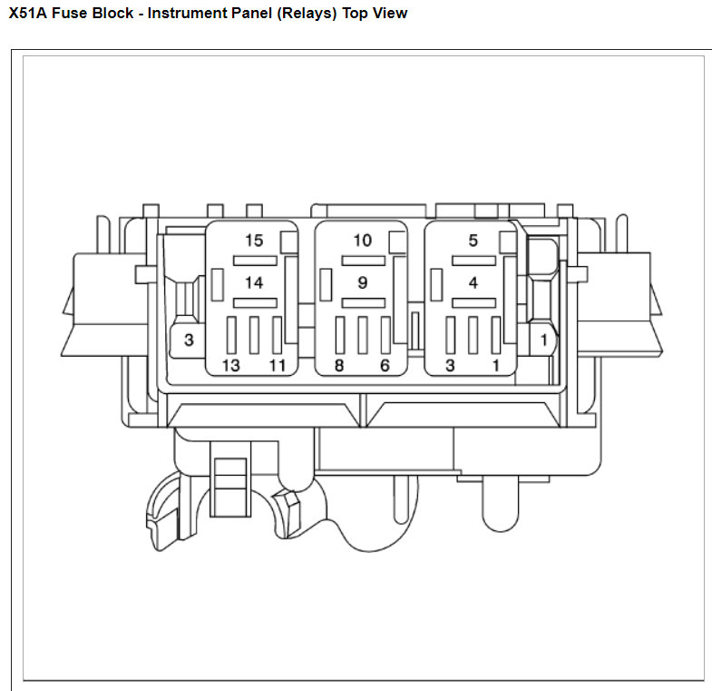

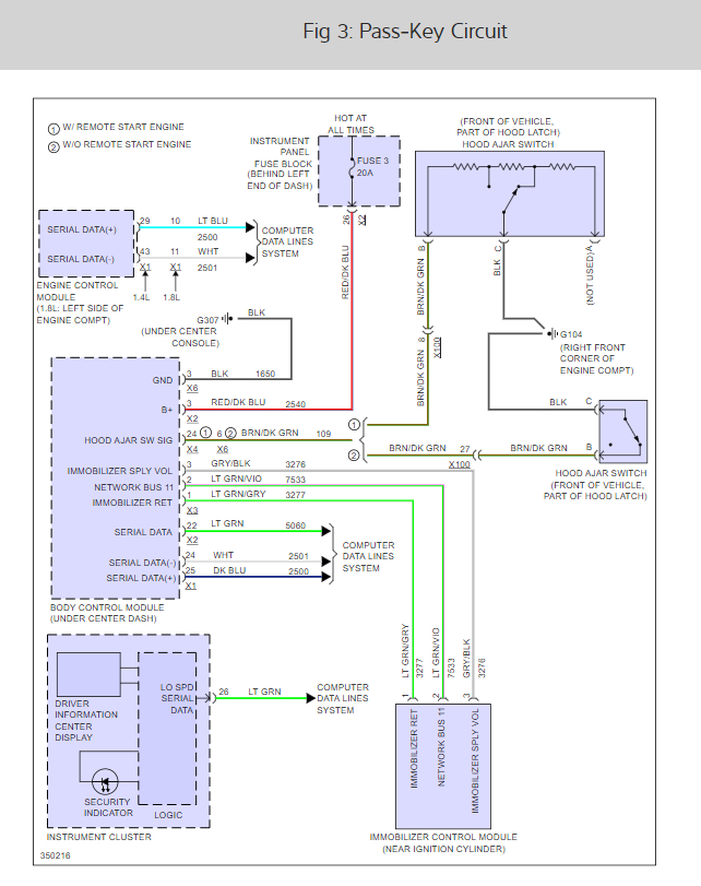

Lets start by checking for power at fuse #3 here is a guide to help us get started and the fuse location with the wiring diagrams for the immobilizer so you can see how the system works.

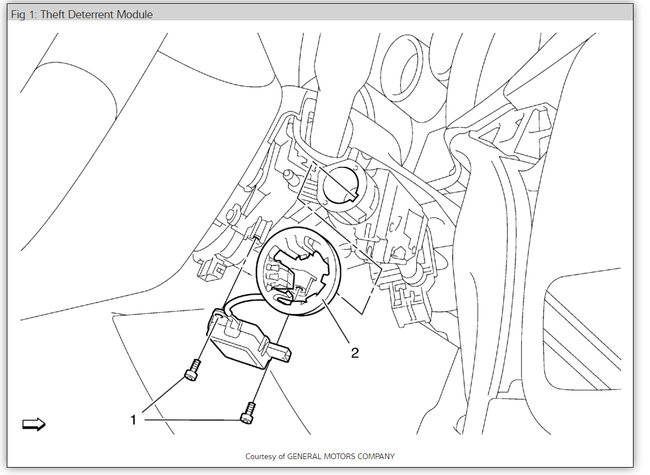

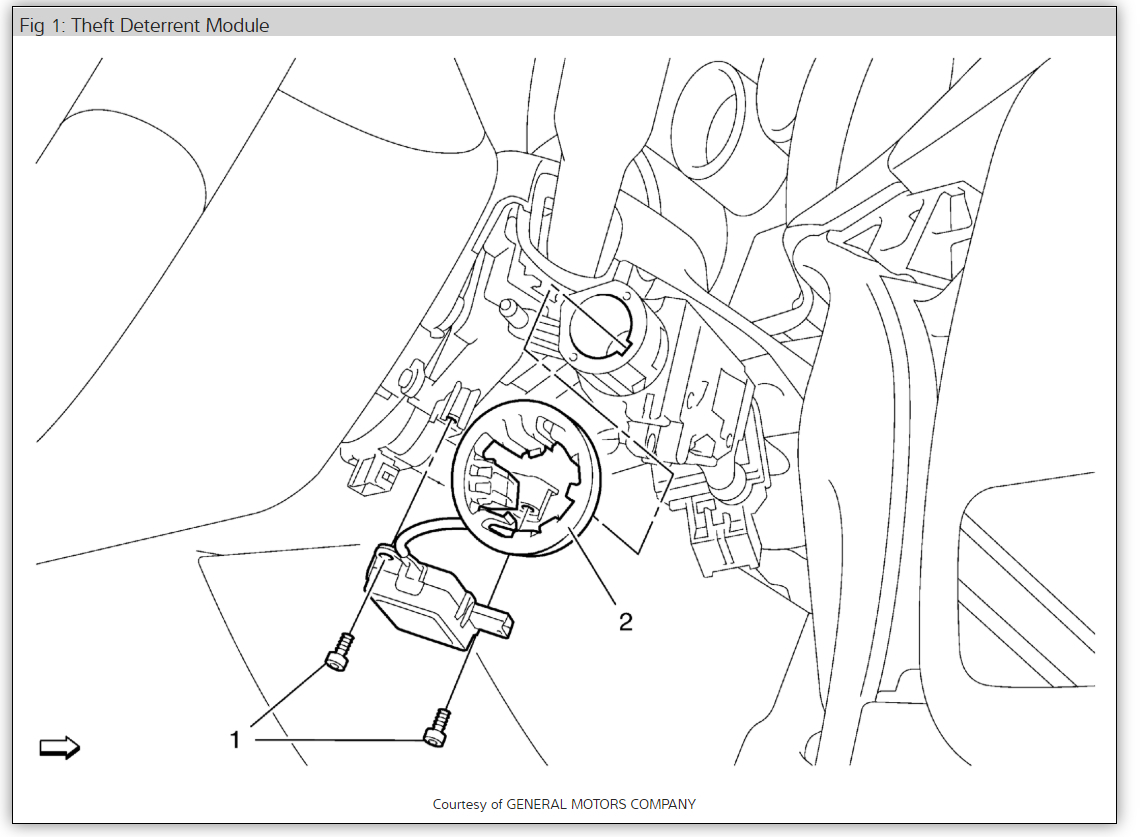

If the fuse is okay It sounds like the immobilizer module is out which will need to be programmed in which should cost about $130.00 here is the location as well.
Check out the diagrams (Below). Please let us know what you find. We are interested to see what it is.
