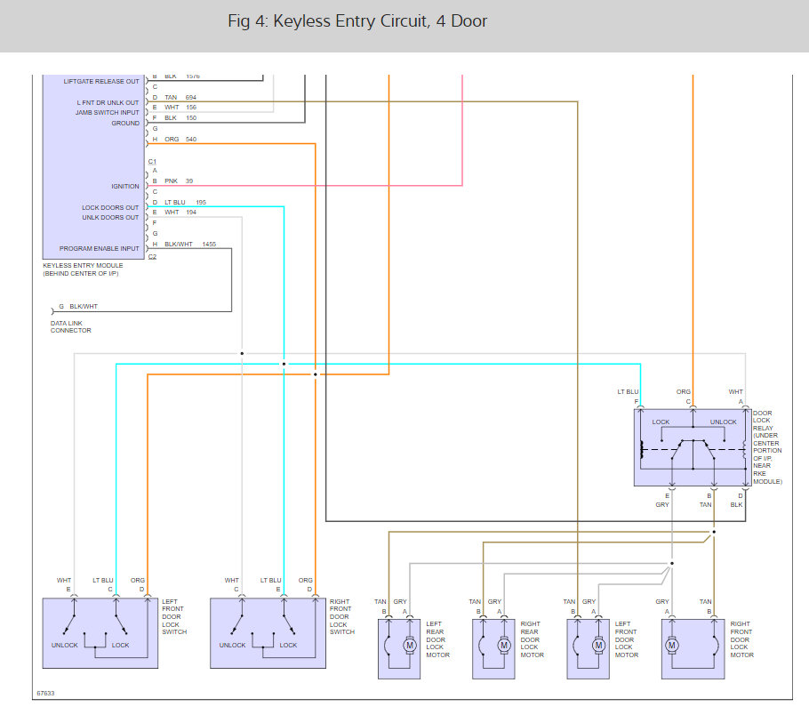

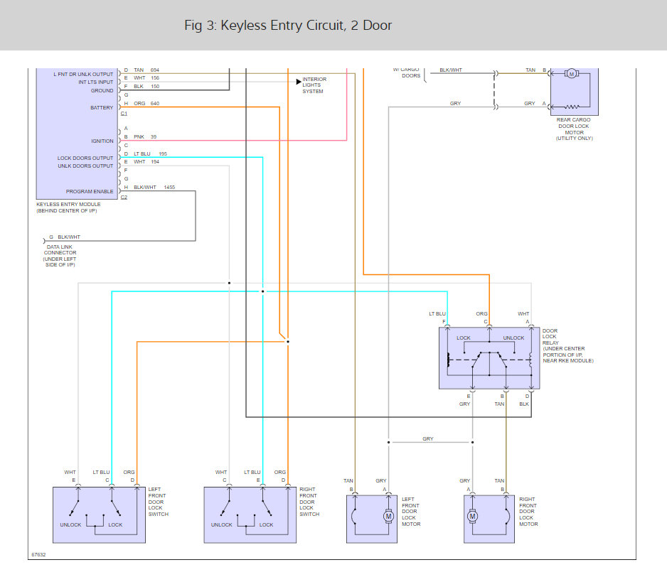

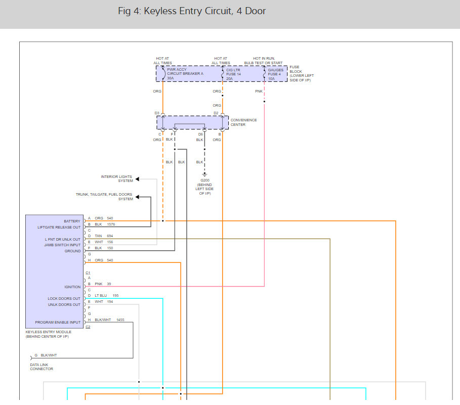

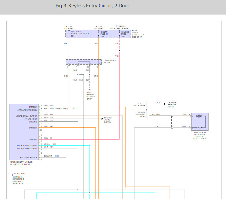

Keyless entry stopped working reset remote still does not work.
Sep 12, 2018 at 4:20 AM
  • 55,746 POSTS

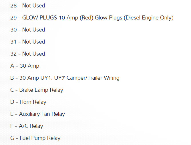

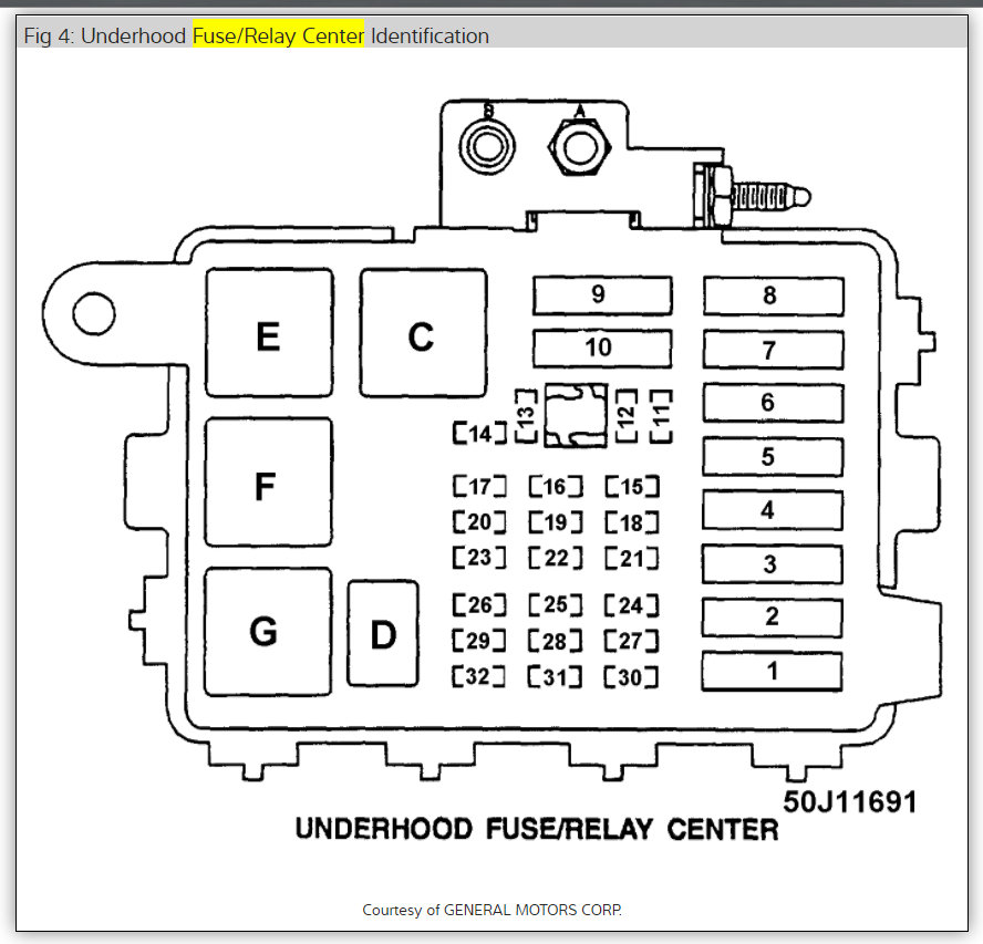

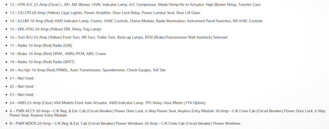

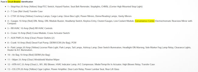

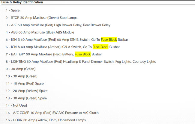

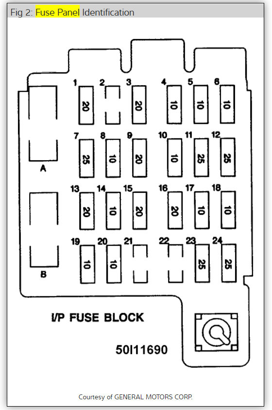

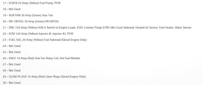

Hello, lets start by checking fuse #4, #14 and circuit breaker "A" in the fuse panel which runs the system. Here is a guide to help us get started and the key-less wiring diagrams so you can see how the system works and the location of the fuses:
