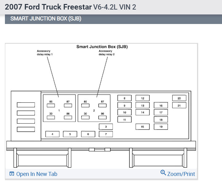

The Key fob started working sporadically and only from close range. Bought new fobs. New fresh batteries. Programed the fobs and they've worked no better. Now no fob will work. Zero functionality. I guess it's the module, but I can't find any location data for the location. By how the fobs worked, when they worked, I assume it's somewhere near the driver's door.
Is there a process I need to be aware of when I change the module? Like reprogramming etc.?
Thank you so much!

Here is the information we have on the location and replacement instructions for the alarm control module.
The Alarm control module is part of the SJB (smart junction box) behind the left side of the dash.
Cycle a key in ignition to RUN. Enter Security Access on the PATS control function module. Select "Parameter Reset" and then Exit Security Access. Perform a PCM Keep Alive Memory (KAM).

Check out the images (below). Please let us know if you need anything else to get the problem fixed.
