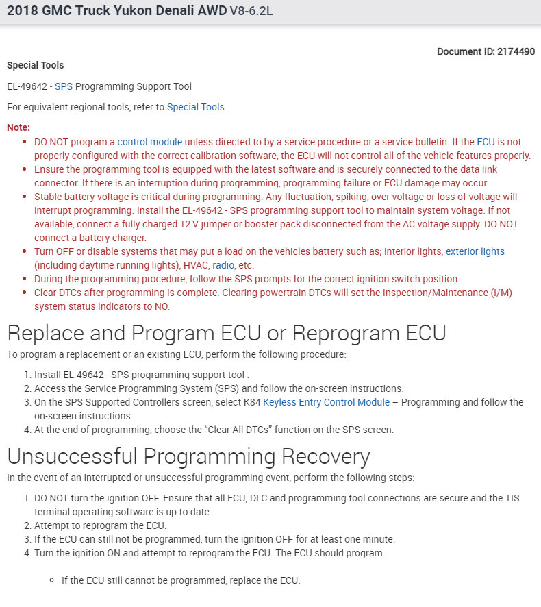

When any of the components gets replaced, the vehicle needs to be programmed to accept the new components. Otherwise, it will not work. It can even trigger the anti-theft system and keep the vehicle from starting at all. Programming does require special equipment.

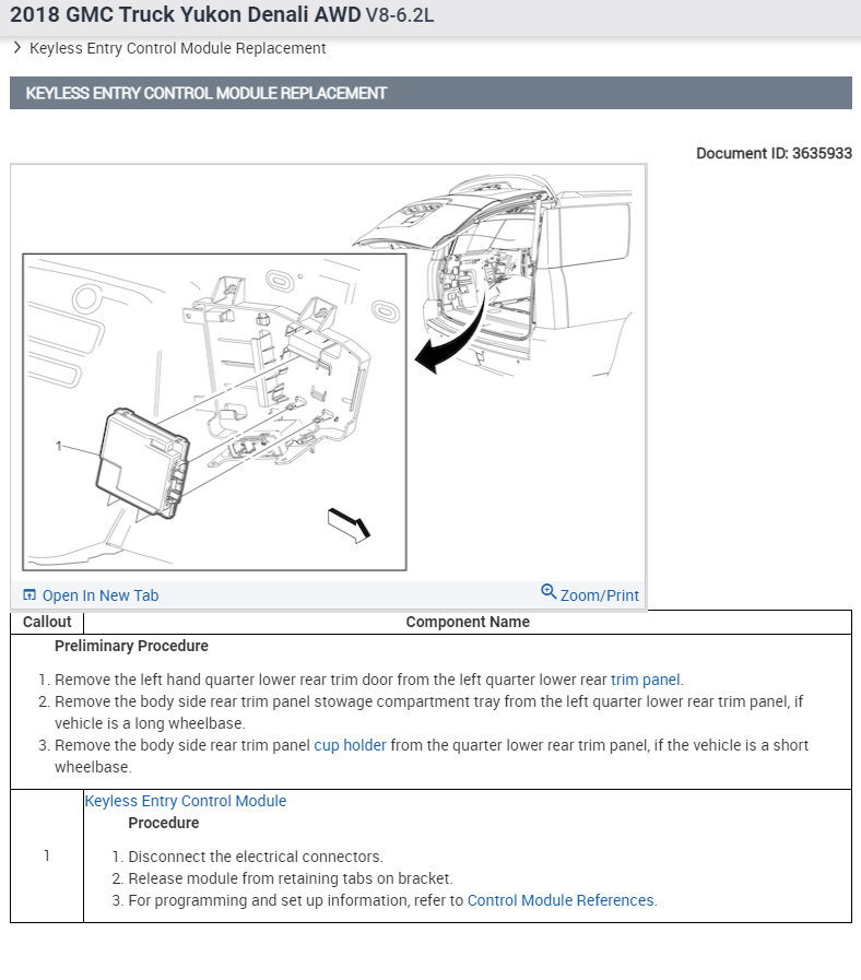

The keyless module is located in the cargo area (I have attached diagram below for your reference)
It will be worth checking for any loose connection. However, you do not want to unplug the module as it can trigger the anti-theft system.
