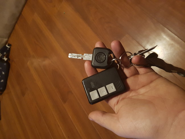

When I press lock on the fob, it locks, unlocks, and then locks. And repeat for unlocking, I can still get in no problem, just all of a sudden today it started doing it three times every time I pressed the button. Any advice? Could it be cause of a problem?
Dec 31, 2016 at 4:35 AM
MHPAUTOS
  • 31,937 POSTS
does it do this with both fobs?
Dec 31, 2016 at 7:13 AM
GORDON R TAYLOR
Only one fob.
Dec 31, 2016 at 12:35 PM
MHPAUTOS
  • 31,937 POSTS
If the second fob is okay i would be suspecting the fob itself as the problem, they often give out if they are used constantly. contact your dealer for a price on a fob and relearn.
