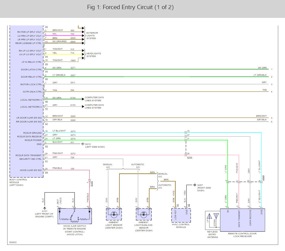

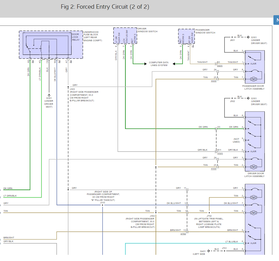

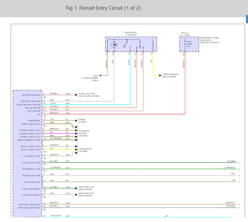

I have a key fob that is able to lock the doors but not unlock due to the button being broken. when I unlock the doors manually it sets off an alarm until I start the vehicle. even locking the doors manually inside the vehicle, it sets off the alarm when unlocking it. what is the issue?
Feb 28, 2018 at 1:30 PM
  • 55,381 POSTS

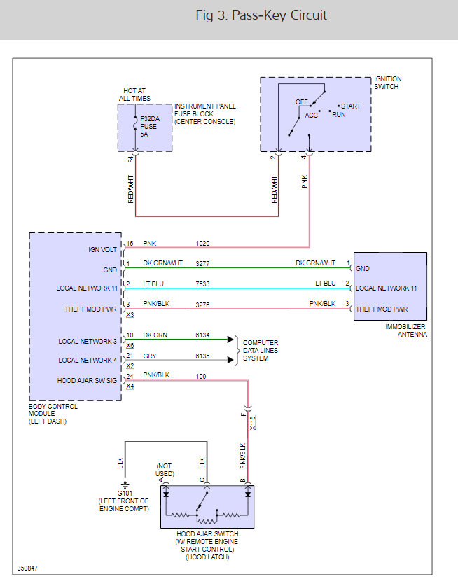

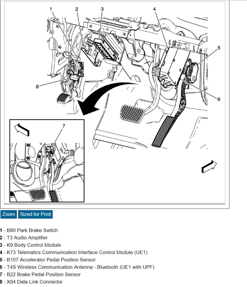

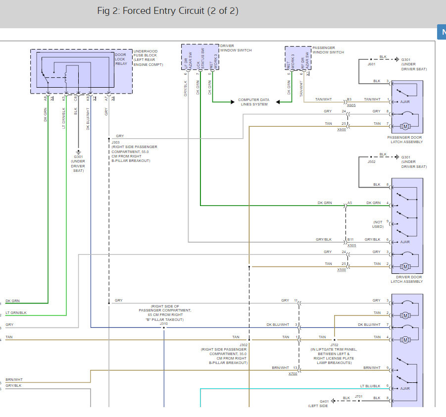

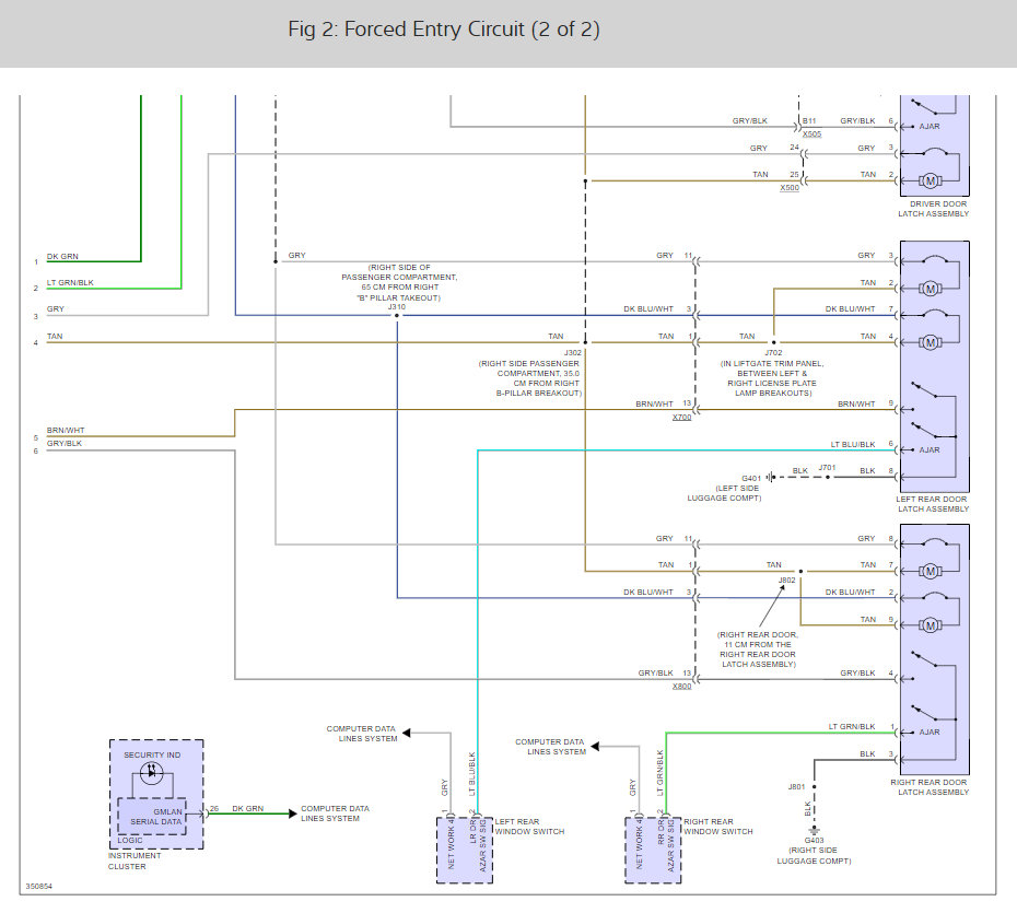

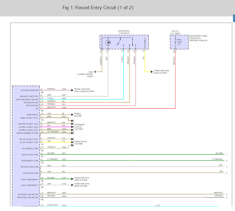

If the fob button is broken this can be the cause of the security system confusion. If the button is not stuck down my next step would be to replace the drivers door latch because the micro switch inside the latch goes bad causing the system to think the door is open all the time does the interior lights come on when the malfunction is happening?
Test the switches int he doors by following this guide
and check out the diagrams below for the security system so you can see how the system works.
If everything checks out all trails lead to the BCM which when you replace it it will need to be programmed in.
