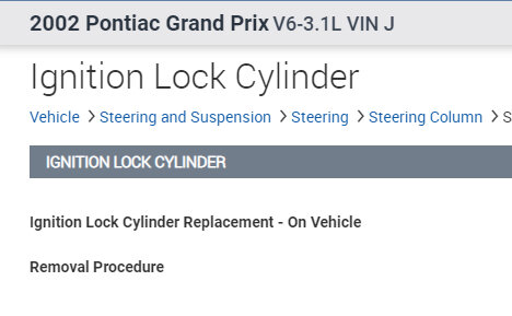

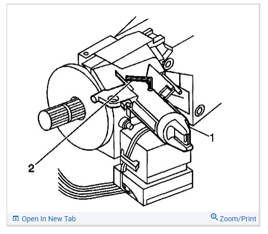

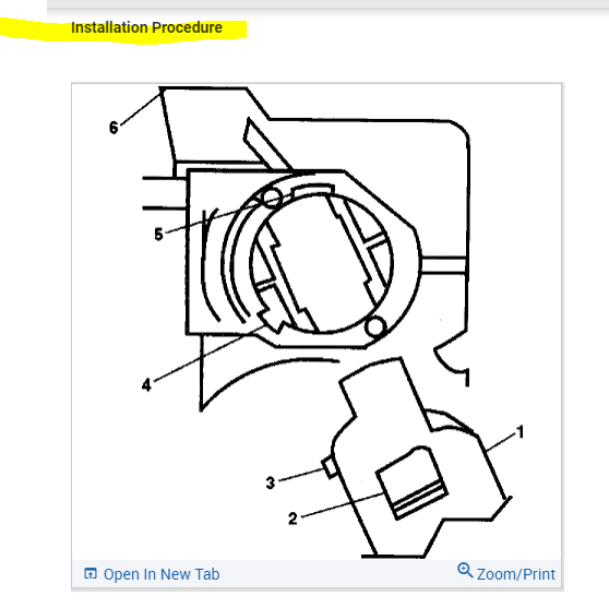

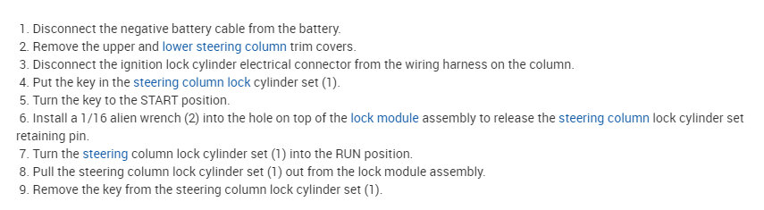

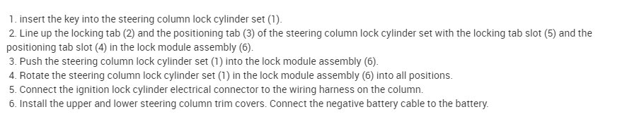

You are very welcome. At this point, the only thing I can say is the ignition lock cylinder needs to be replaced.
We have two things to deal with. First, to remove the cylinder, the key needs to be in the start position which isn't possible. (Battery disconnected). Since you can't get it to move and it is being replaced, we will need to force it.

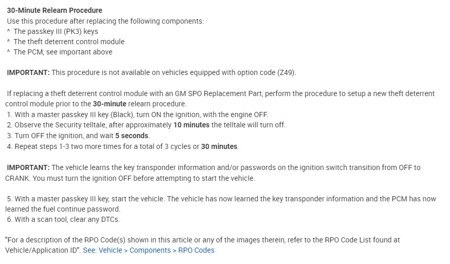

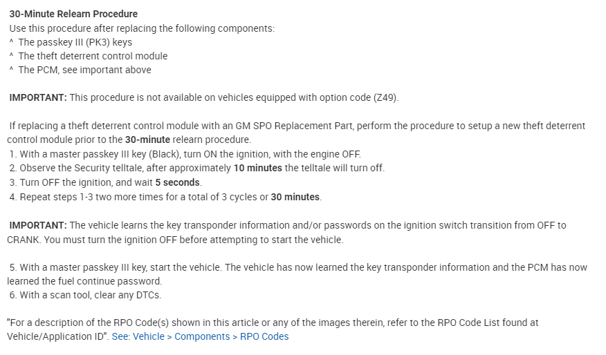

Next, if you have the anti-theft (VTD/Vehicle theft deterrent), the new key will require programming of the VTD module to recognize the new transponder in the new key. They don't make this easy.
I Attached the directions for replacement below. Take a look through them and let me know if you have questions.
Take care.,

How would I go about forcing it to the on position ?
Mar 2, 2023 at 1:19 AM
  • 110,248 POSTS
You can drill out the tumbler or use a screwdriver to force it to turn.
