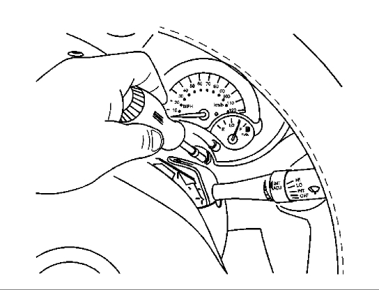

To do that you disconnect the battery negative connection. Then you remove the upper steering wheel trim cover.

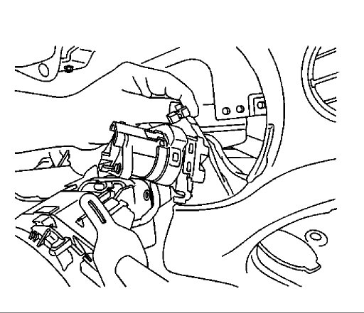

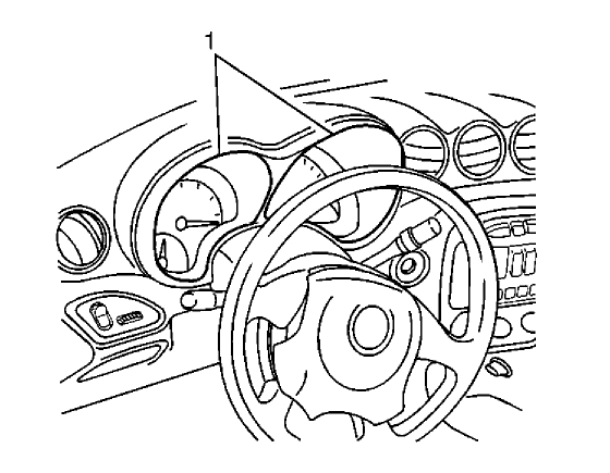

Then the instrument cluster trim panel and the cluster itself. (pictures 1-3)

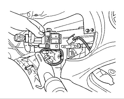

Now you remove the accessory trim panel the one around the radio and the center stack. To do that you use a thin screwdriver to remove the ignition switch bezel and then use a trim stick to pop the retainers that hold the trim in place free. Disconnect the electrical connectors at the top and rotate the trim and set it aside. (picture 4)

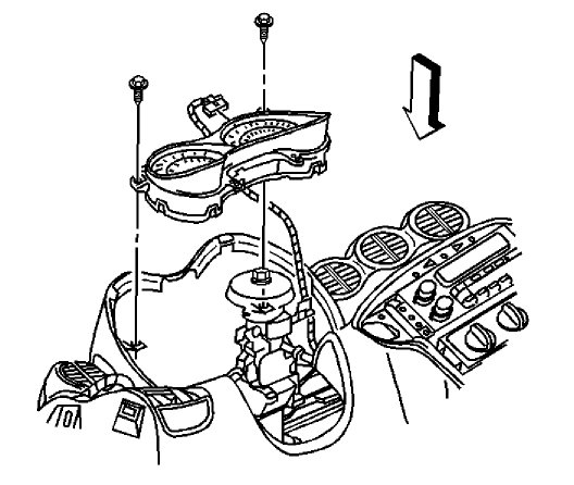

Now you can get to the ignition switch bolts to remove it and drill out the lock cylinder. Remove the bolts and the electrical connections, Disconnect the park lock cable connection and remove the switch. pictures 5 and 6)

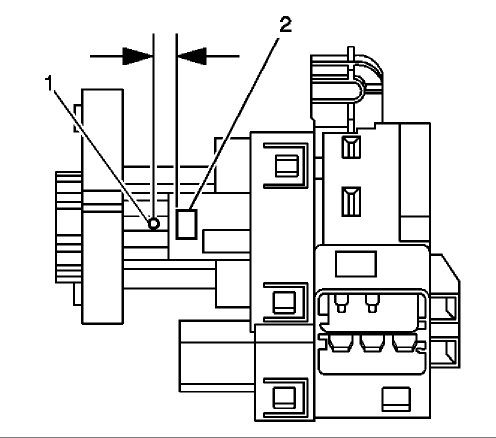

12.2. Locate the surface for the ignition lock cylinder release button (2) on the plastic ignition switch housing and center punch a location (1) on the rib 9.5 mm (3/8 in) rearward, toward the key entry end, from the cylinder release button. (picture 7)
