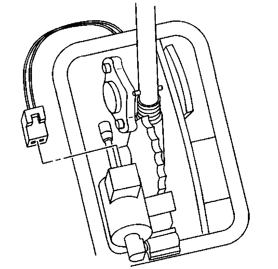

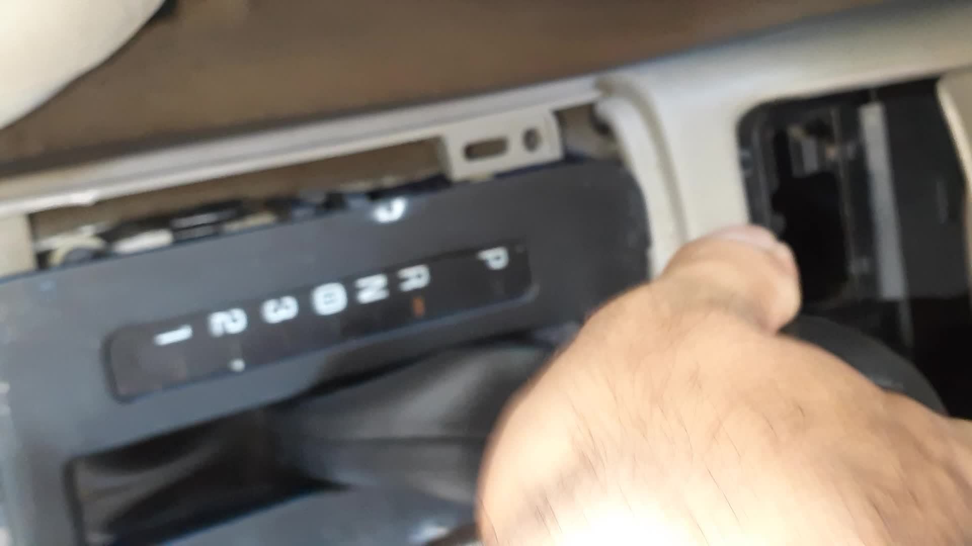

I think what they are referring to is the neutral safety switch. That is what prevents the engine from starting unless the transmission is in park or neutral.
I need you to check if the shift lock is preventing the actual shifter from fully returning to park. I am going to provide the directions for replacing the switch. I am not suggesting it be replaced, but this is all I have to help guide you to it. Once you get the console apart, see if there is anything binding.
________________________________________________
2001 Buick Regal V6-3.8L VIN K
Floor Shift
Vehicle Power-train Management Transmission Control Systems Actuators and Solenoids - Transmission and Drive-train Actuators and Solenoids - A/T Shift Interlock Solenoid Service and Repair Procedures Floor Shift
FLOOR SHIFT
Automatic Transmission Shift Lock Actuator Replacement (Floor Shift)
Removal Procedure
pic 1
1. Disconnect the negative battery cable.
2. Remove the center console.
3. Disconnect electrical connector from the shift lock control for the automatic transmission (AT).

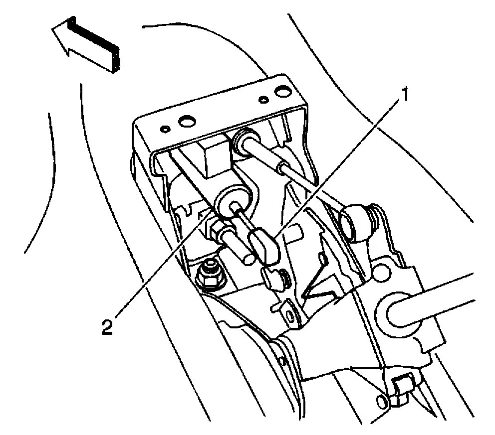

pic 2
4. Remove both ends of the AT shift lock control from pivot points (1).

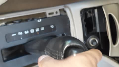

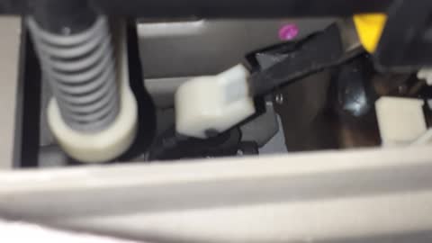

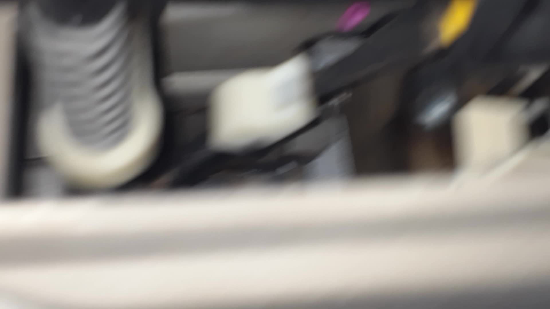

I looked under the shifter assembly and it looks good. Nothing looks like it's binding. Here are a couple of videos:

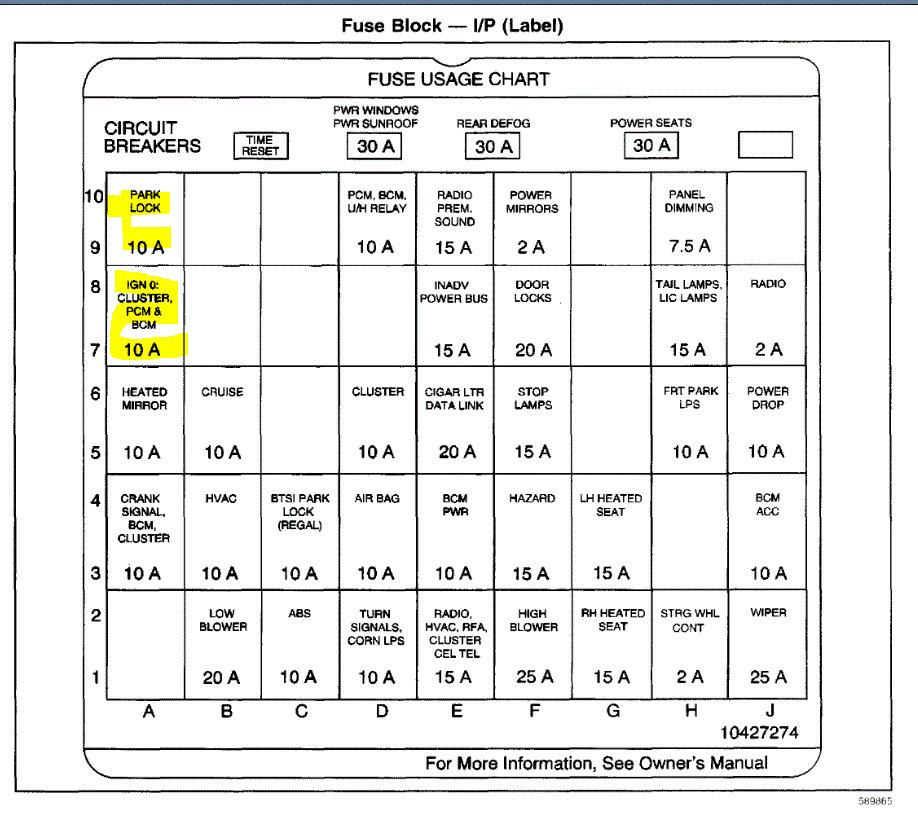

In the vehicle fuse panel, check the two fuses I highlighted below. Also, take a quick look at all fuses to see if anything is bad.
Aug 18, 2020 at 12:05 PM
INTOSILENCE1
  • 79 POSTS

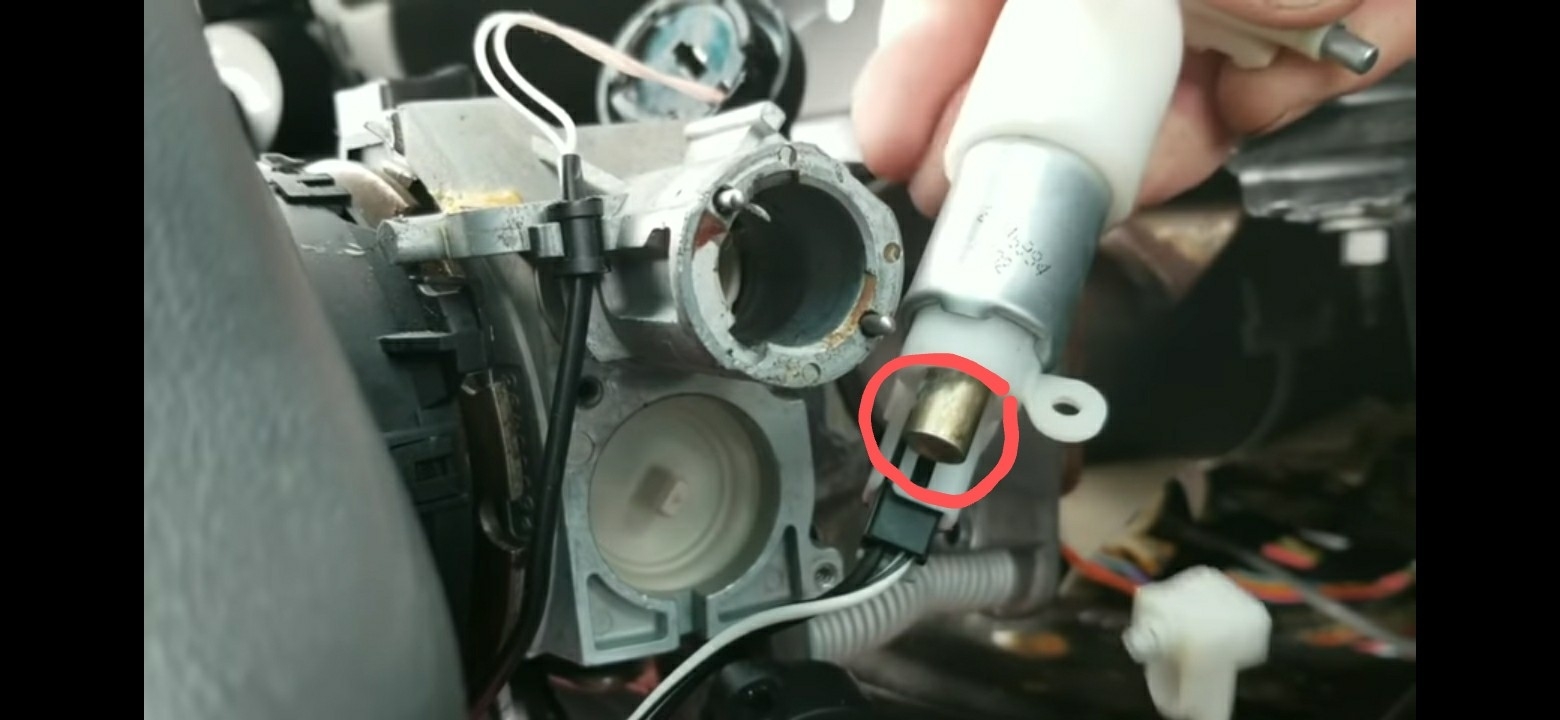

All the fuses were good. What I ended up doing, I just put zip ties on the little gold cylinder that you push up on from underneath the column. Now that it's always pressed in, I can turn the lock cylinder back and remove the key.
Aug 20, 2020 at 7:35 AM
  • 110,248 POSTS
That's an interesting repair, but if it works and you are comfortable with it, great!!! LOL
