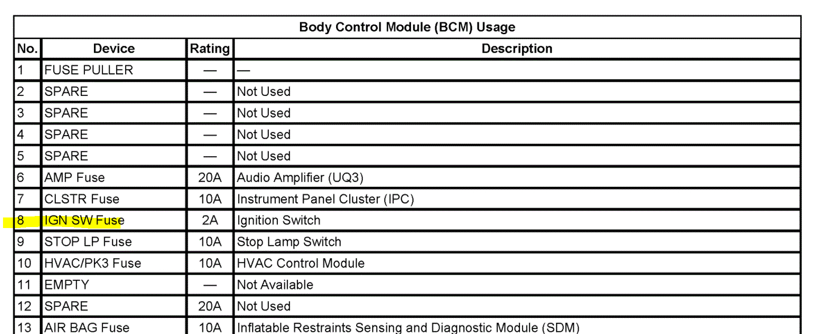

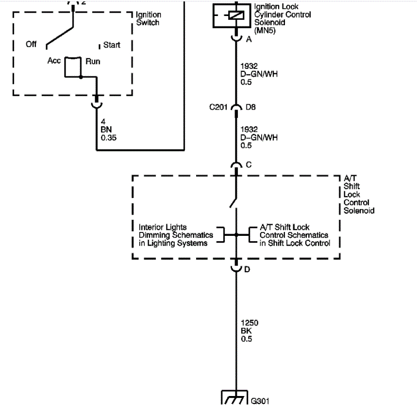

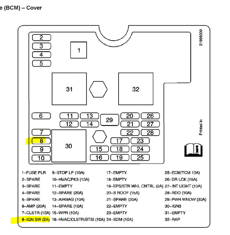

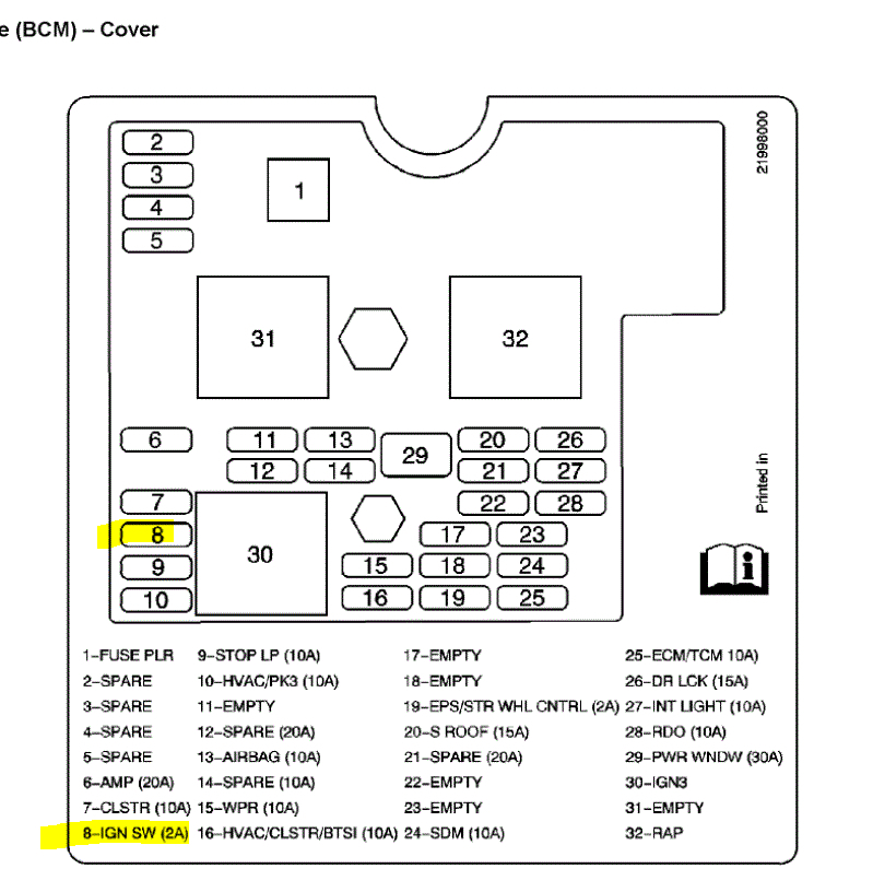

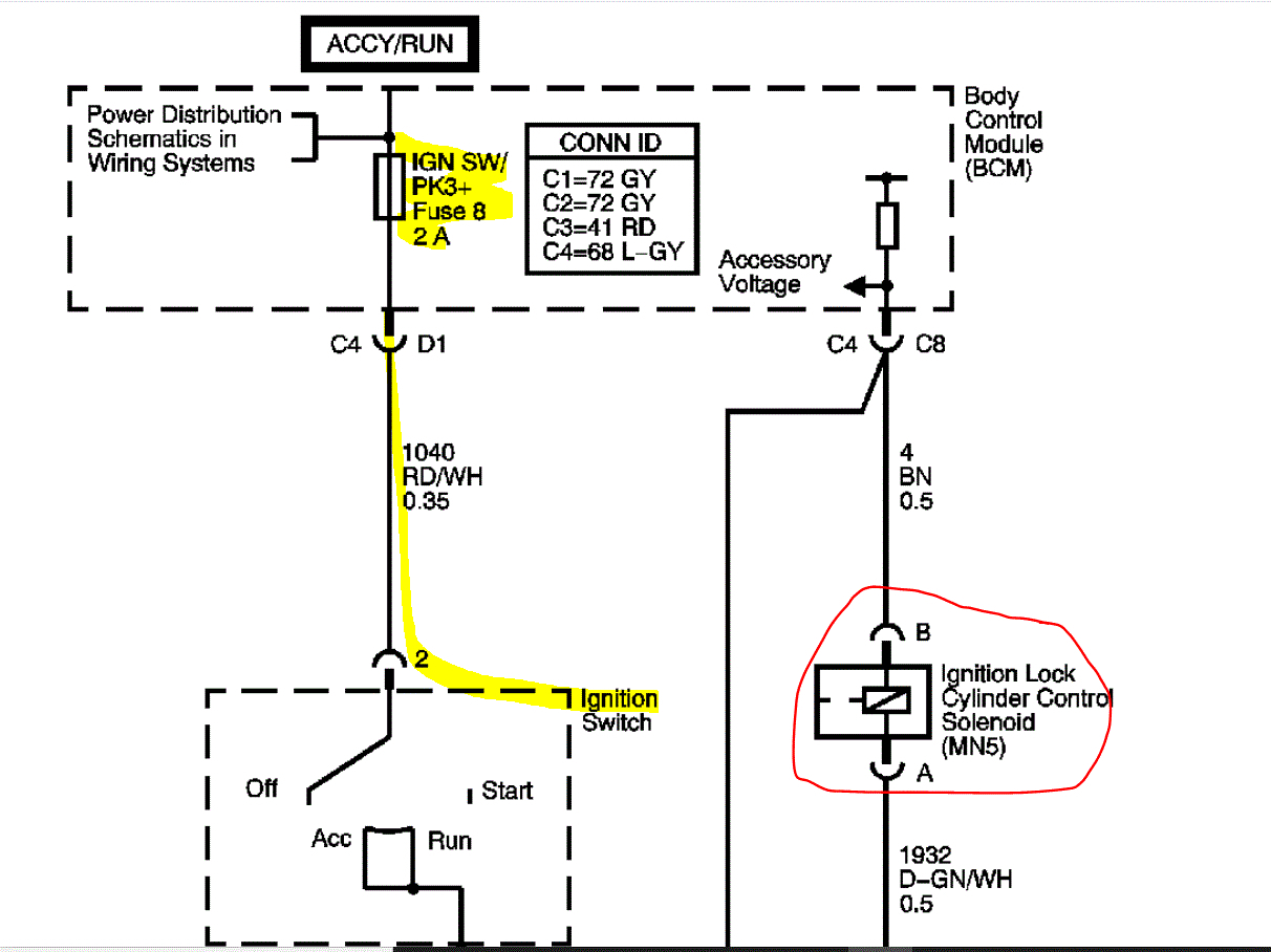

Also, locate the interior fuse box and check fuse number 8. It is only a 2 amp fuse, so it doesn't take much for it to blow. Inspect its condition. Also, confirm there is power to and from it.
Here is a link to help:
I attached the wiring schematic and fuse box locations below to help you locate the fuse.
See pic below.
