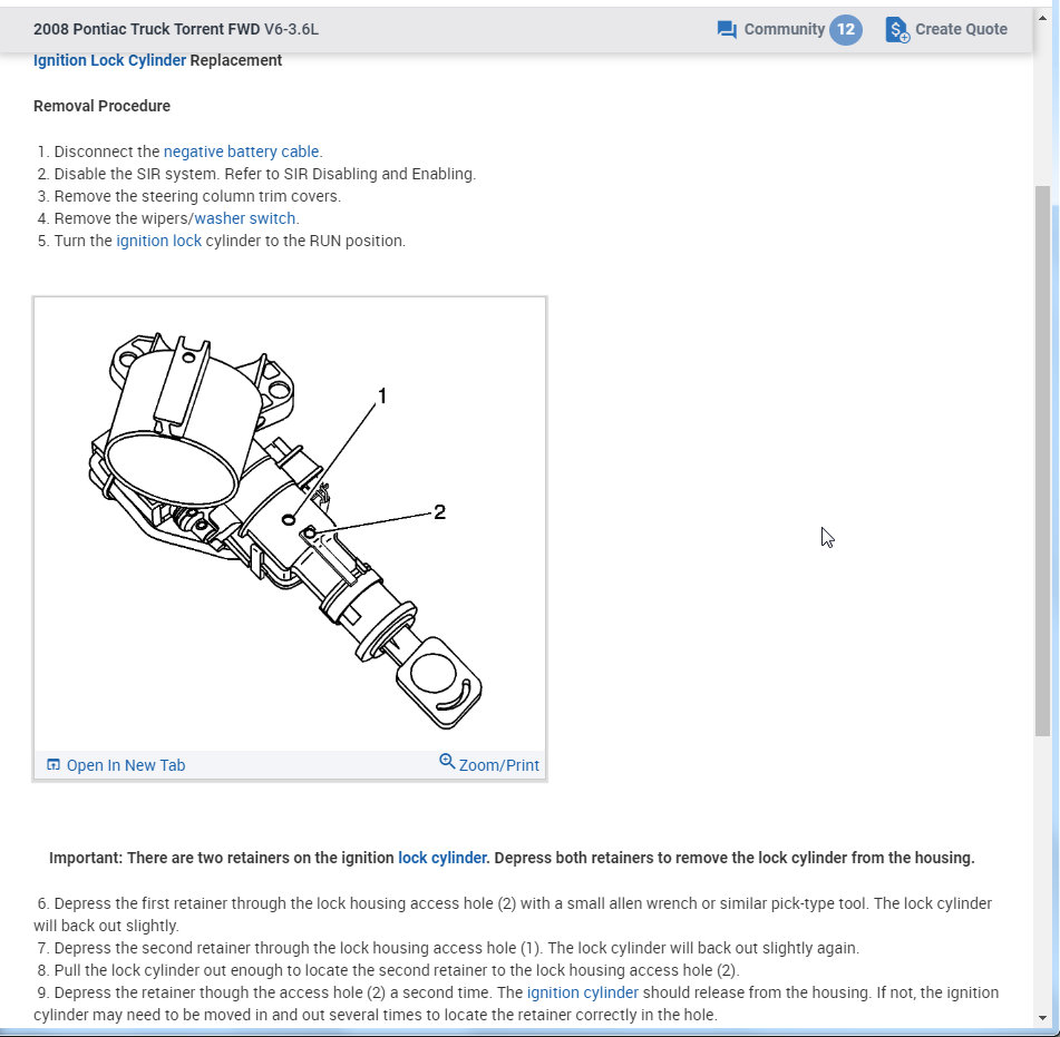

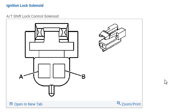

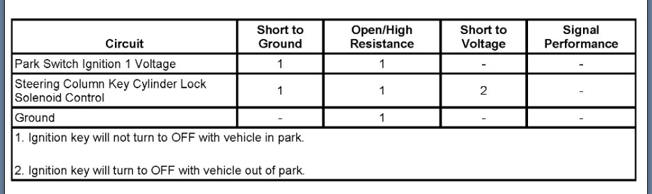

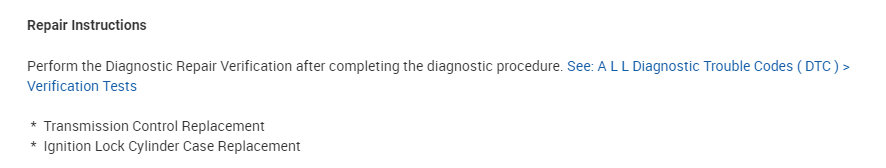

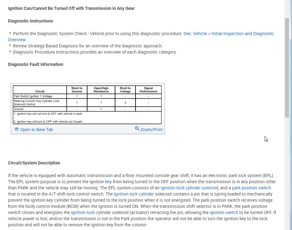

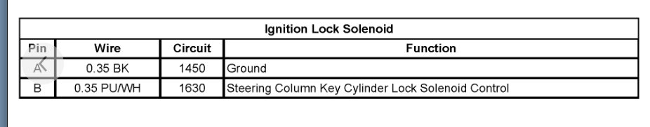

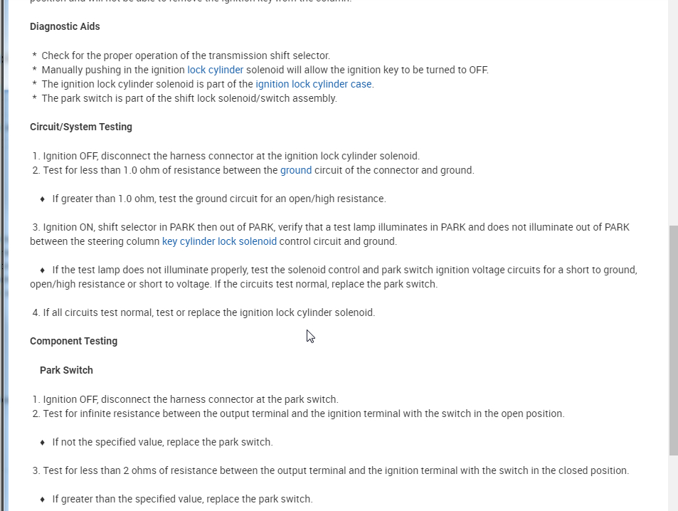

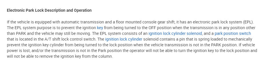

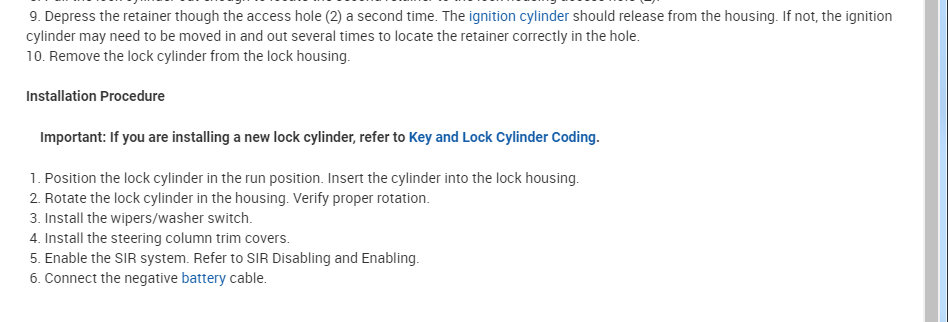

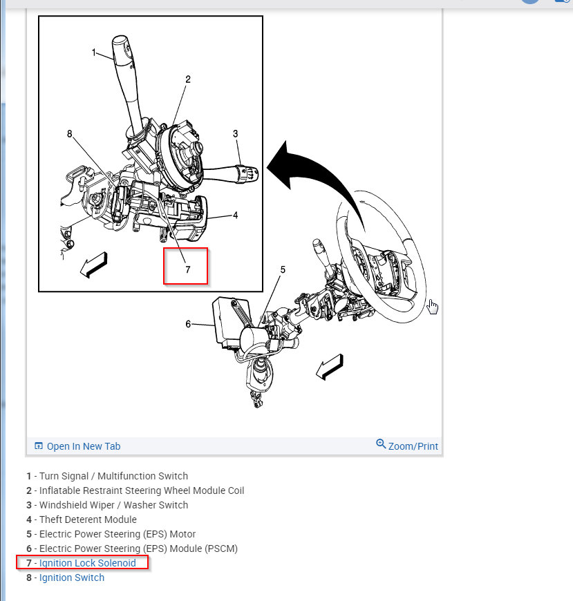

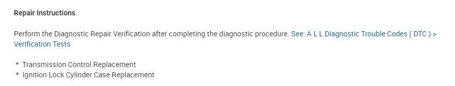

Okay. That is good info. I attached the info on the ignition lock cylinder solenoid. More then likely this is your issue. Let's run through this info and testing and we can confirm this is the issue.
Lastly I attached how to replace the cylinder case if we find that it is not wiring.
