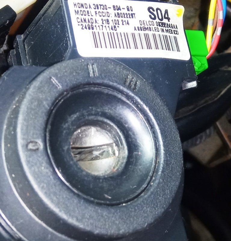

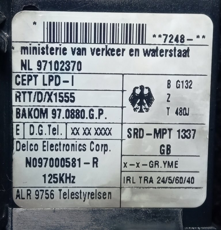

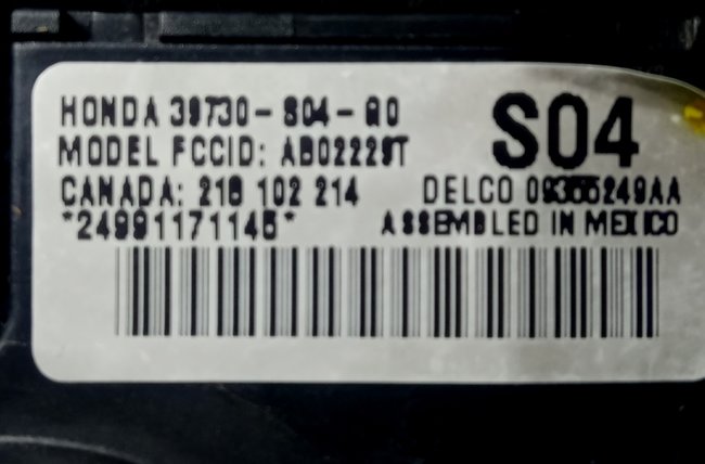

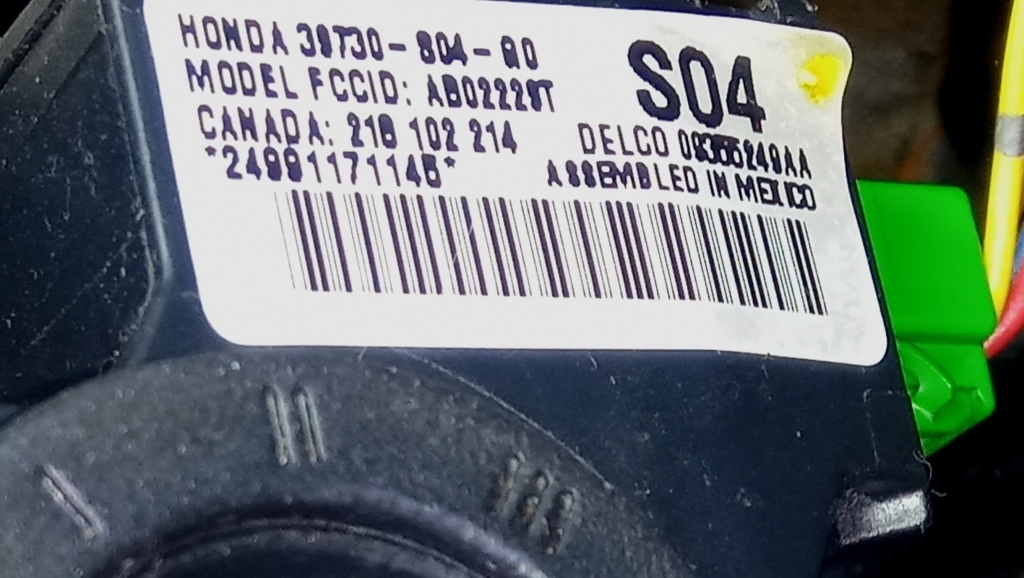

Hello again Joe, check the attached pictures of the ignition switch key sensor, the Honda part number is 39730-S04-G0.

Thank you again for your answers, talked to the locksmith again, he agrees that the mechanical repairs to the lock cylinder pins should not affect the electronic key sensor, he suggested cleaning the contacts. It's a small plastic plug, will try tomorrow to unplug, plug again which I have already done so.
If the sensor is replaced, do you know if this requires reprogramming the keys, computer, etc? -Am looking for the replacement Honda Part # 39730-S04-G0.

Try cleaning to see if that does anything. However, if you already have, it shouldn't be an issue. As far as replacement, to the best of my knowledge, it will need reprogrammed. You really don't need to get a Honda part, but in all honesty, I suggest it. Otherwise, you'll most likely end up with crazy issues.
