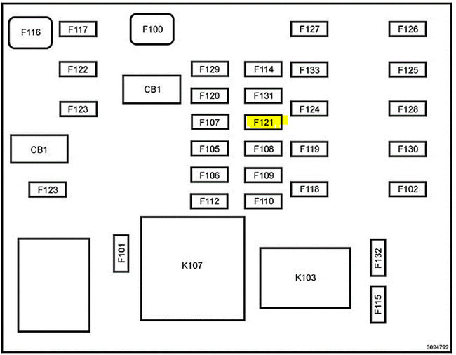

The fob will lock and unlock the vehicle but when I try to start it it says key not detected. so I changed out the battery it’s still the same thing.
Apr 25, 2021 at 10:57 PM
  • 110,240 POSTS

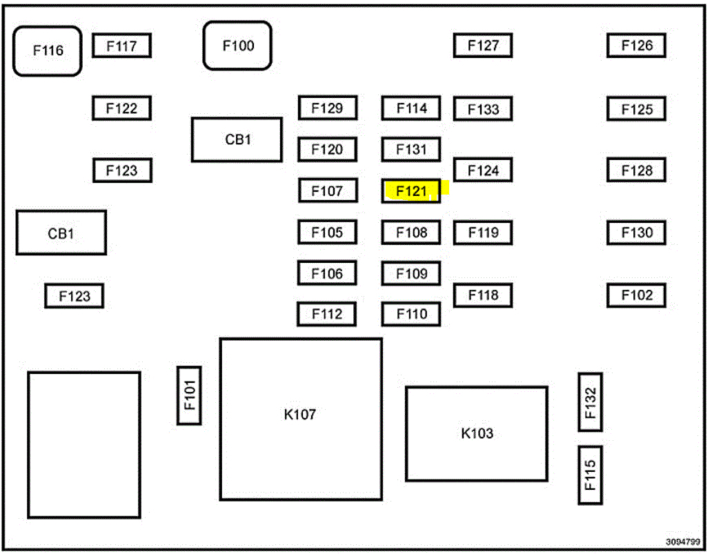

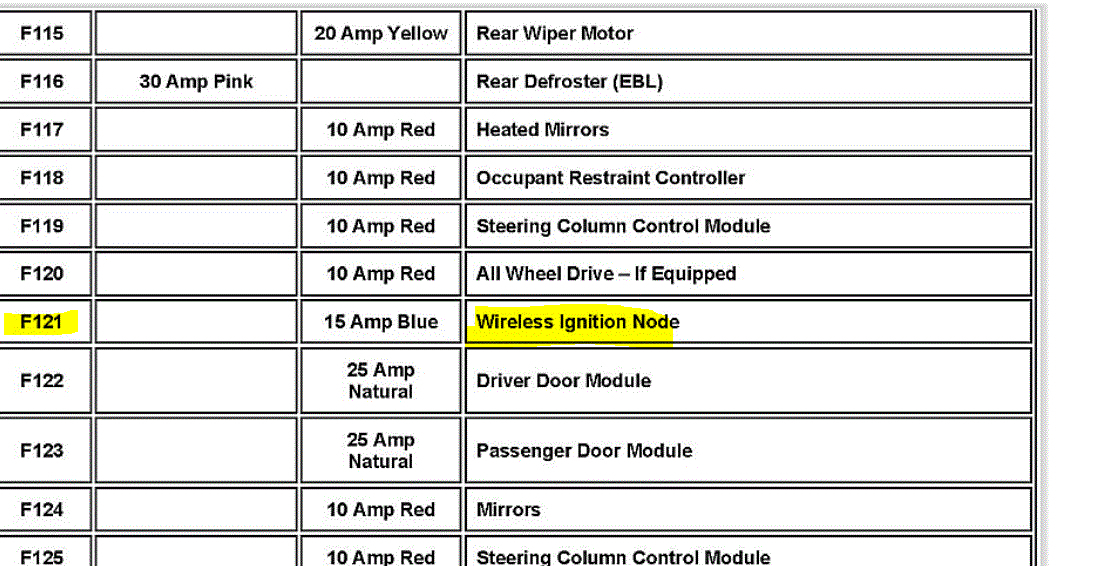

If it indicates the key is not recognized, I need you to have the computer scanned for diagnostic trouble codes. There are a number of possible issues. The one thing I can suggest is to check the wireless ignition node fuse. It is fuse number 121 and located in the fuse box in the vehicle. See the two pics below.
When you check the fuse, first make sure it isn't blown. If it is good, then I need you to confirm there is power to and from it. Here is a link you may find helpful when testing:
