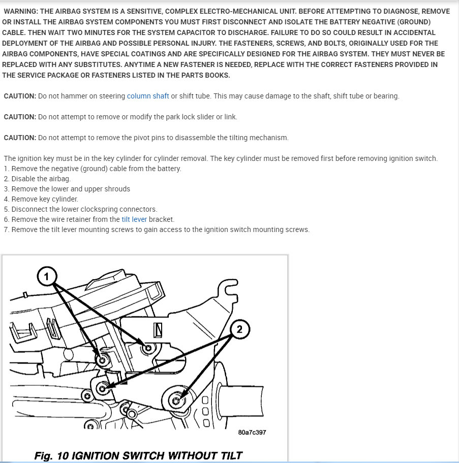

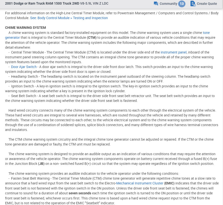

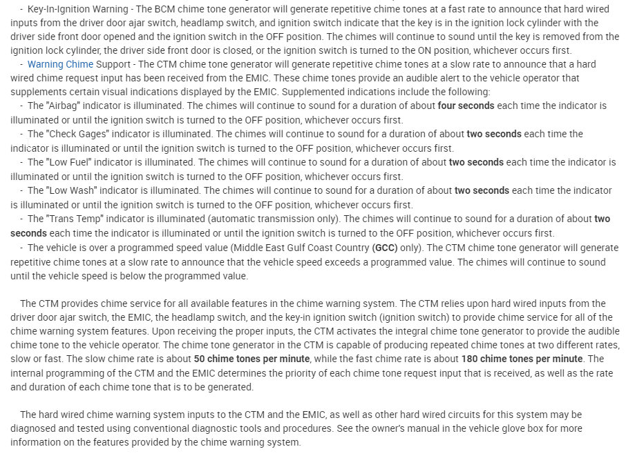

Hi JJ,

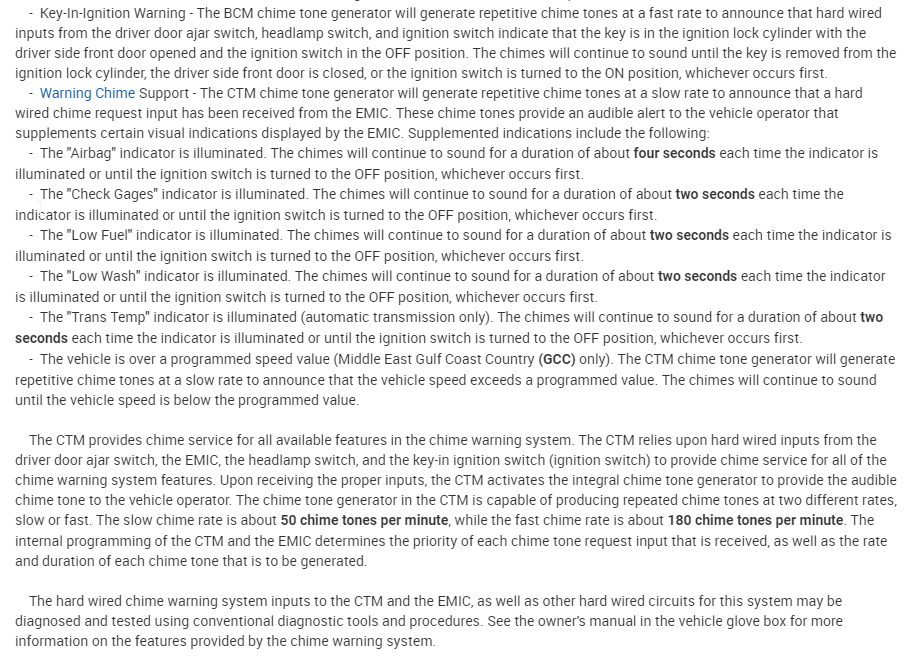

I attached the system description which gives a pretty detailed account of why this chime goes off. Give it a read (twice if needed, like me) and then apply it to what is happening.
Based on what you are saying if the chime is the slower chime described then it is either telling you that the CTM thinks the door is ajar, keys are left in the ignition, or the seat belt is unbuckled.
I am not sure but I think the door ajar only happens if the keys are in the ignition. If that is correct then it is unlikely it is the door switch. If not, then it is just as possible as the ignition switch thinking the keys are in the ignition. I am pretty confident that it is not the seat belt chime.
If the noise stops when you turn the ignition, I would suspect the ignition switch because under normal operation, I believe the door ajar will continue the chime even when the ignition is on.
Basically, there are a couple things to test but I suspect the ignition switch is your issue. Let me know what you find.Thanks

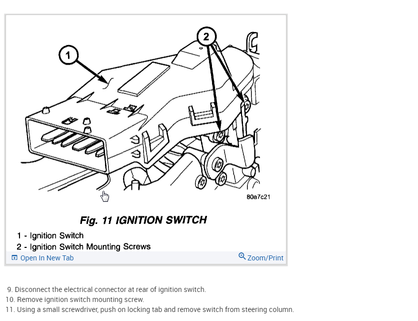

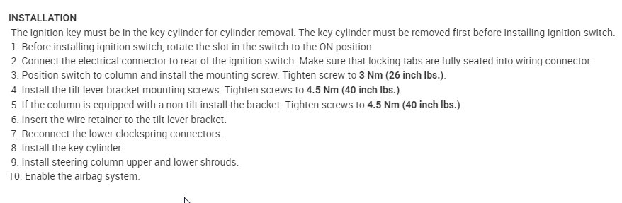

Unfortunately, the chime is coming from the central timing module itself so the only way to disable it would be to disconnect this module and I am not sure what the complete result would be. I do know that this would disable all the alarms including the seat belt, door ajar, headlights are on with no key in ignition, and the key left in ignition.

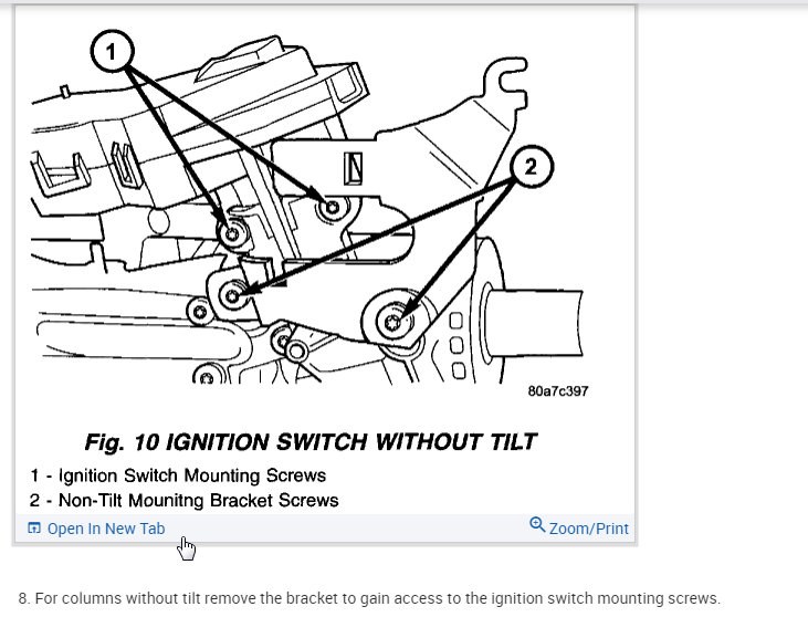

If you change the ignition switch then you can code the new one to match your key so you don't have to change everything. If you haven't done this before, I would recommend having it done because if it is off then your key won't work and obviously your vehicle will be disabled where ever it is until that is fixed.

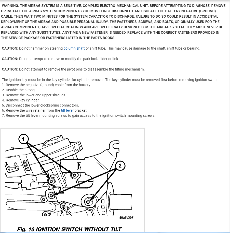

Sorry I don't have better news, but the most likely cause is the ignition based on this information and the best course of action I would take is to replace the ignition.

Okay. I am just going off of what the service information says. It reads that the door ajar and ignition warnings are separate chimes.
The way you need to confirm what your issue is, would be to hook up a scan tool and monitor these systems.
Based on this, the CTM could very well be the issue. Unfortunately, there just isn't enough information with out using a scan tool to be definitive.
