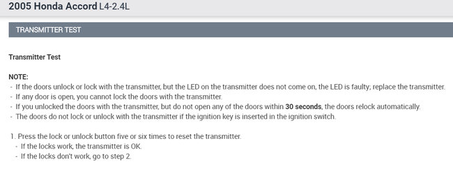

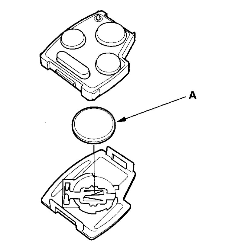

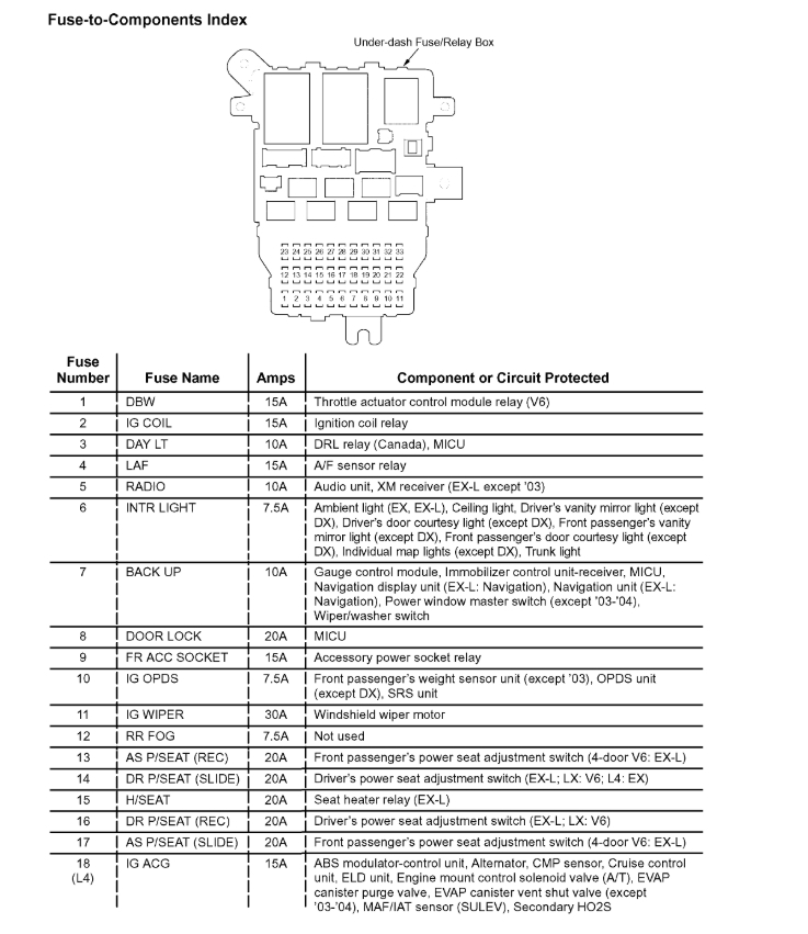

I replaced the battery in my key fob, and it still does not work. It occurred to me that the receiver is in the master door control cluster, which I also replaced. Is there any way to program the receiver?
Sep 4, 2019 at 2:53 AM
  • 55,770 POSTS
The battery can only go in one way. Here is how the alarm system works and how to program the remote with diagrams below:

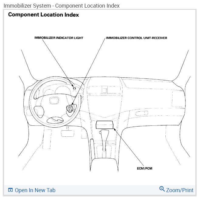

Immobilizer Key Registration
NOTE:
- The HDS is required for registration of the immobilizer keys.
- Check for aftermarket electrical equipment that can cause problems with transponder operation.
- The immobilizer control unit-receiver can store up to six immobilizer Keys.
Add a new key
1. Have a registered key, a new immobilizer key, and the first pass word from the IN system.
2. Connect the HDS to the data link connector.
3. Turn the ignition switch ON (II).
4. Select "IMMOBILIZER" from the "SYSTEM SELECT" menu.
5. Select "Keys", then "Add 1 key".
6. Do the registration according to the instruction of HDS screen.
7. Check if the engine can be started by the newly registered key.

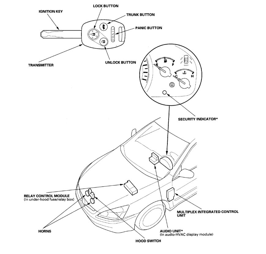

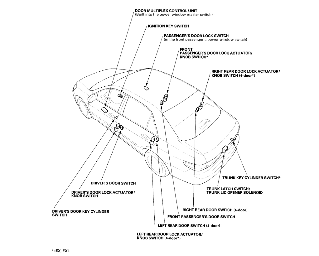

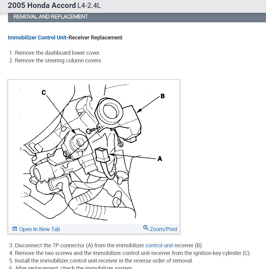

I still cannot get 2 original keys or two new keys to operate the door locks remotely after following all programming instructions. I have not yet taken the new keys to a locksmith, nor have I tried to do anything about the immobilizer until I get the transmitters working. You supplied drawings and instructions at the end of the post for removing and replacing the Immobilizer Control Unit in the steering column. I am confused about whether this indeed needs to be replaced since my original keys start the car. I am also confused about what and where the referenced MICU (Multiplex integrated control unit) and the Door Multiplex control unit (keyless receiver) are located and what they do. These items seem to be a part of my issue. As I originally mentioned, I replaced the master window/lock control unit in the driver side door some time ago and do not have the original unit any longer (and looking back, that's when everything stopped working)
Sep 9, 2019 at 3:32 AM
  • 55,770 POSTS

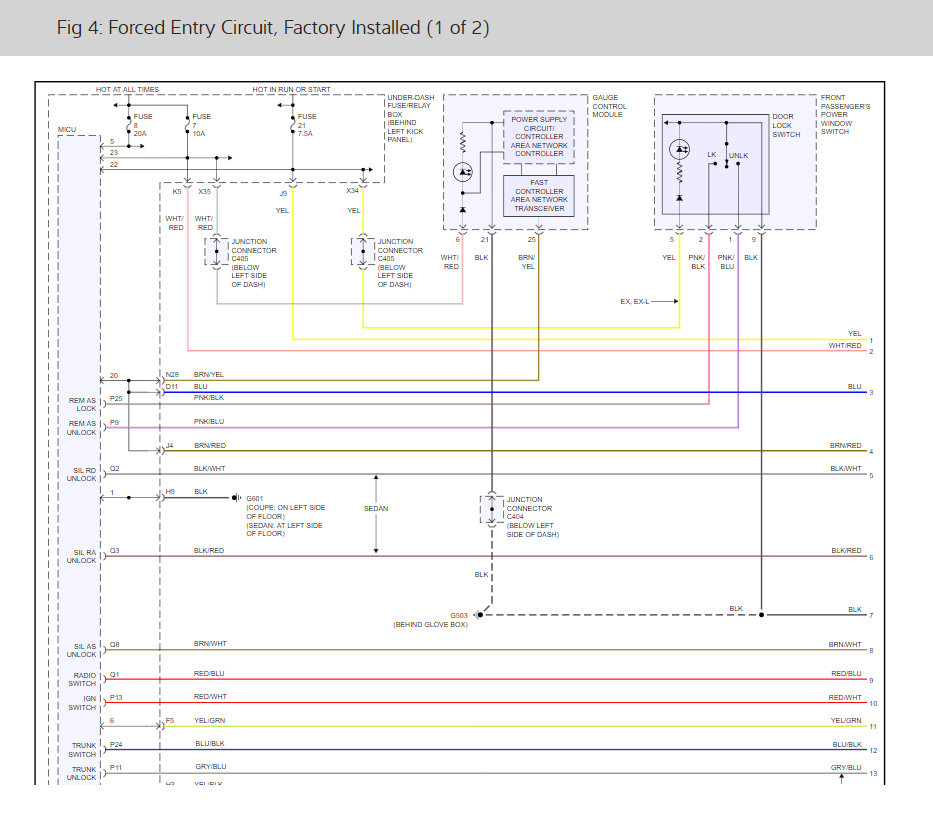

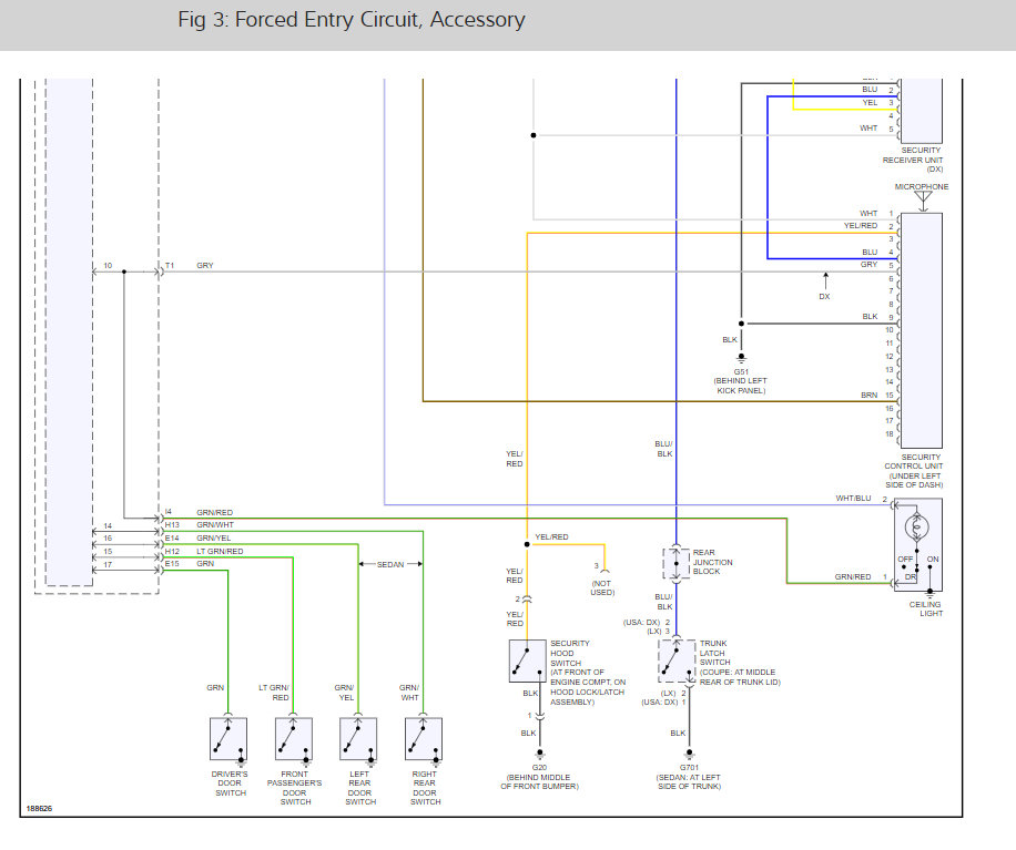

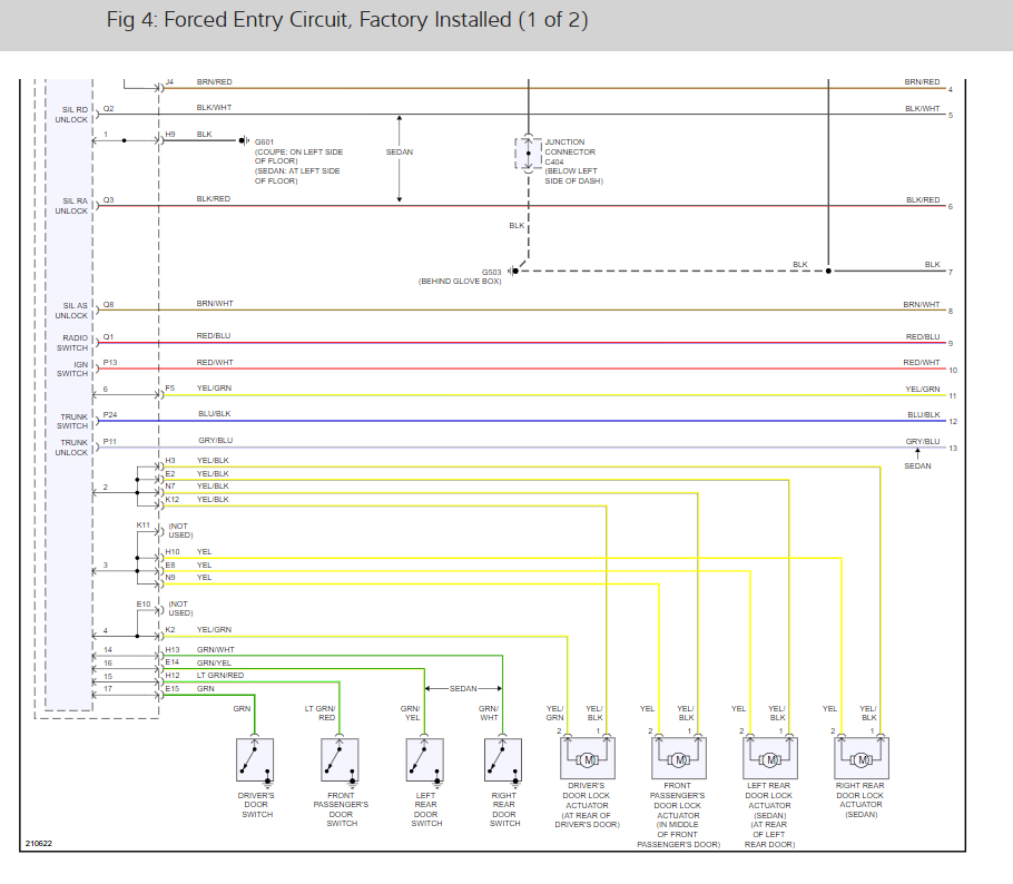

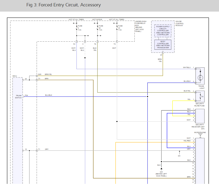

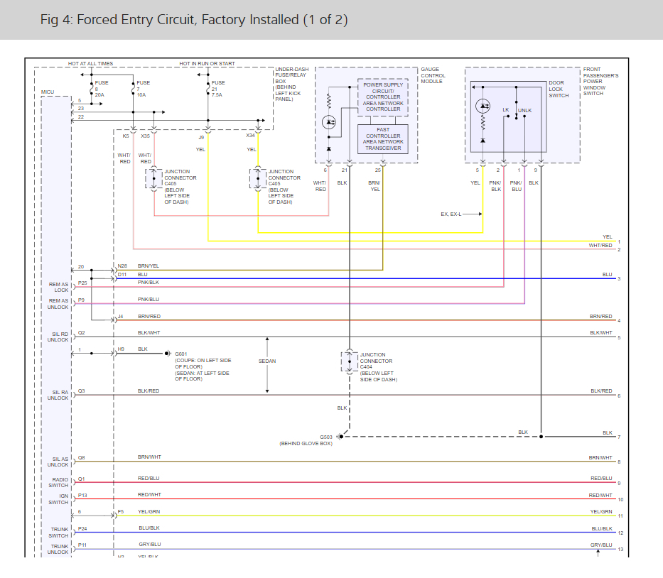

Both the MICU (Multiplex integrated control unit) and the Door Multiplex control unit (key-less receiver) work in the CAN system we need to run a scan to see which one is bad. here is a video of the job being done:
https://youtu.be/InIlnsjOVFA

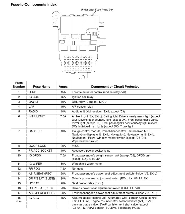

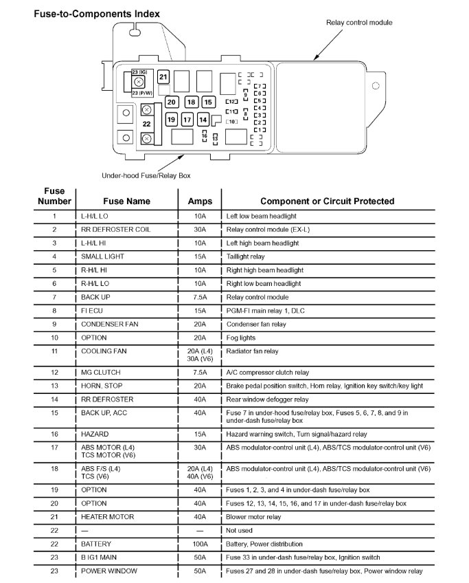

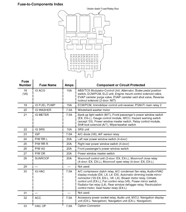

Lets check fuses 8,7 and 21.

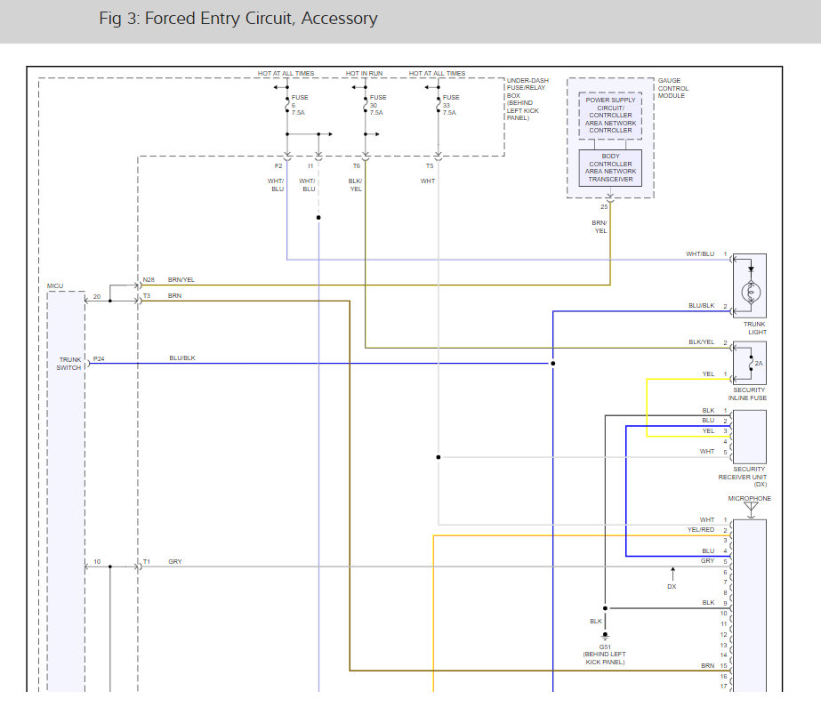

Here are the security system wiring diagrams so you can see how the system works with the fuse and security system component locations. Check out the diagrams (below). Please let us know what you find.
Sep 9, 2019 at 4:16 AM
MTNMAN1982
I actually took the master door unit out and checked all connections. When I re-installed it, I was able to get the keys to go into program mode and got them programmed! For some reason, I believe the built in antenna was not recognizing the signal from the remotes. Now I need to get the new keys cut and get the immobilizer to recognize them. Thanks!
