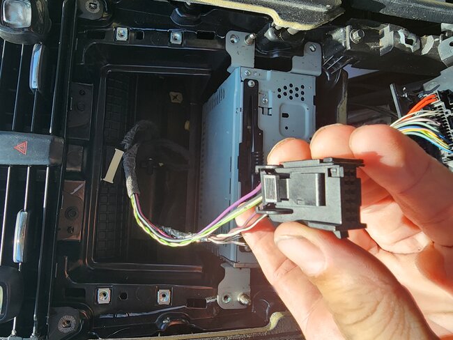

I was installing a new stereo and had a friend messing with a wire that came out of the wire harness, trying to find where it goes. Must have tried the wrong slot cause now my key fobs don't work. Trying to start the car it says no key detected. None of the buttons warm either. It's push button start. Only way it will start is by putting the key in the cup holder, it's some method of starting it if the key fobs dead. It's not dead. Just tried new batteries. Please help.

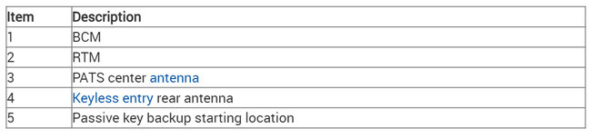

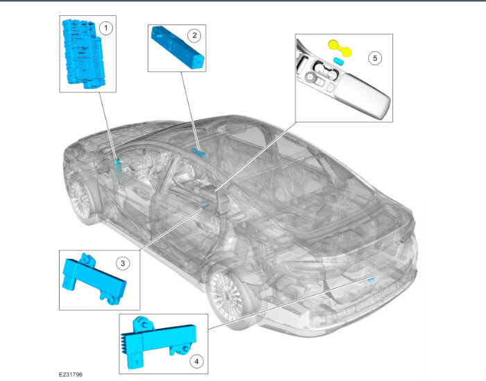

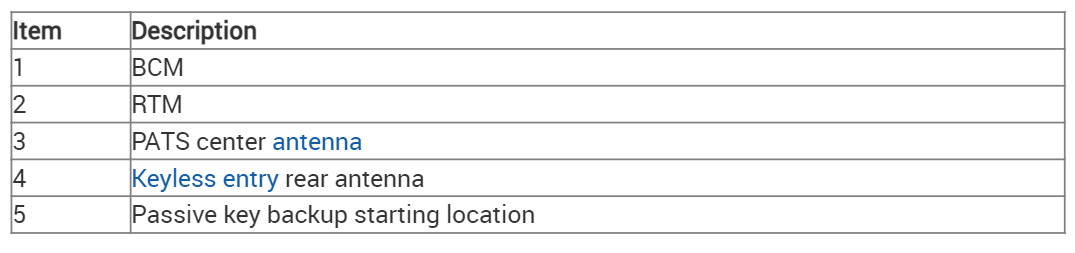

I attached two pics below. The first one identifies the PATS (passive anti-theft system) components and their locations. Pic 2 is the legend for the parts shown in the picture. Let me know what your friend was closest to when the problem occurred.

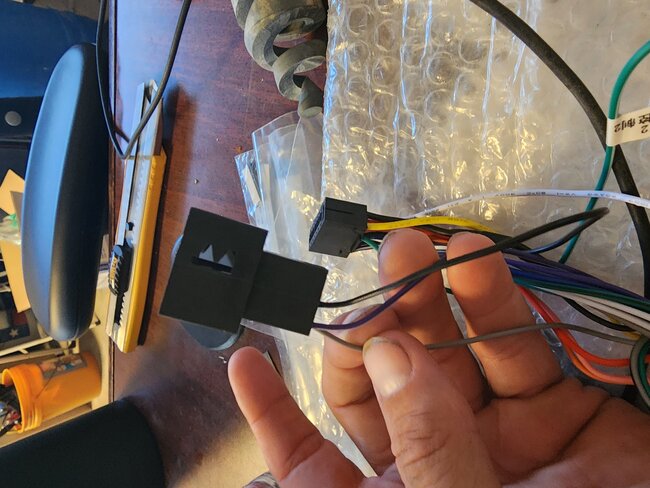

I am posting a picture of the connector that I'm sure the short is connected with. And a picture of the wire harness that was supposed to connect with. The purple wire came loose from the harness with the pin intact. My friend tried sticking it in holes on the connector that leads into the dash, and it shorted out something. Also note the connector in the dash is the one that goes to the back of my original radio screen. It's a 4-inch sync screen.
