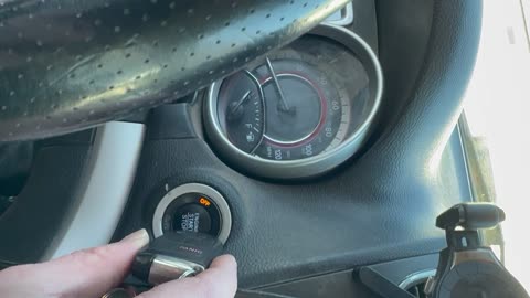

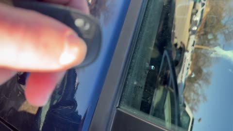

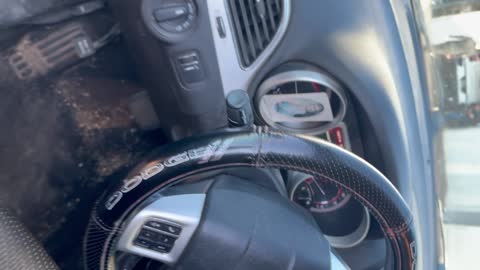

Key fob will lock and unlock doors but is not detected when trying to start, even when pressing fob against button. No DTCs, rf hub communicates good through WiTech. Vehicle starts no problem with aftermarket remote start. Also, fob battery is good at 3.05 volts.

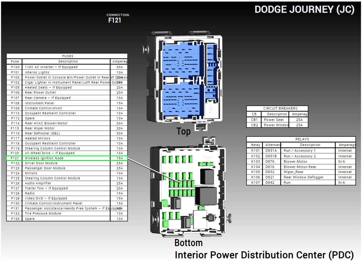

The "aftermarket remote start", did this problem happen ever since it was installed? Let's check the fuse #f121 which runs the system here is a guide to help and I have included the fuse location in the diagrams below. See if the fuse has power as well.

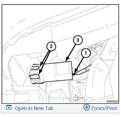

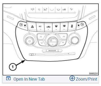

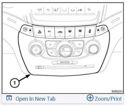

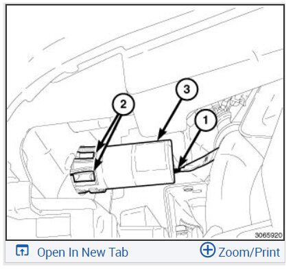

I have seen the keyless ignition node module go out and cause this problem, but to be sure we should do a CAN scan. You can get a CAN scanner (Controller Area Network) which will work on most cars from Amazon.
https://youtu.be/u-4syLc-ifQ

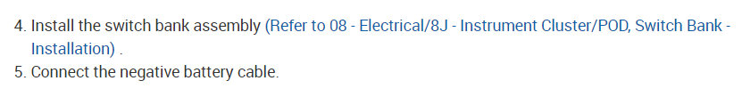

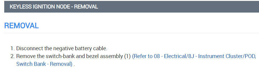

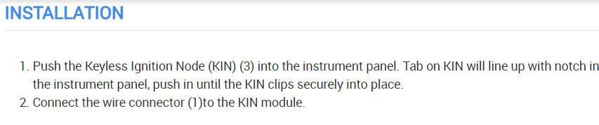

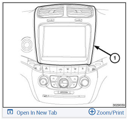

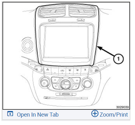

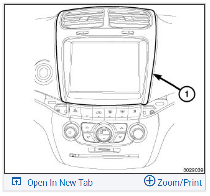

Here is how to replace the keyless ignition node module in case a code comes up for it. Check out the images (below). Please upload pictures or videos in your response to the problem so we can see what's going on.

The remote start never interfered with the fob signal, was installed about 2 years before problem. I hooked the car up to WiTech scanner at the dodge dealership I work at, I have no codes for rfhub module or ignition node. I have a gut feeling the fob went bad but want to know for sure before I spend the money to get one. Fuse 121 is good, do I need to check any voltage to it?

The description sounds like the fob failed but I would try to erase and program it back in because even a dead fob should still start the car when it's held up to the button. At that point the reader in the button reads the RFID tag in the fob and tells it if you have a valid fob. Because that also isn't working, I would start there. I would also look at the remote start and see how they bypassed the fob reading to start the engine. Depending on how that works it might have failed and is now blocking the OE reader from actually working. Wouldn't be the first time I have seen that. Did a DEI remote start a couple months ago, it had an internal failure and while it would still start the engine the car wouldn't start with the button. Ended up removing the remote start and programming the original fobs back in to repair it.
