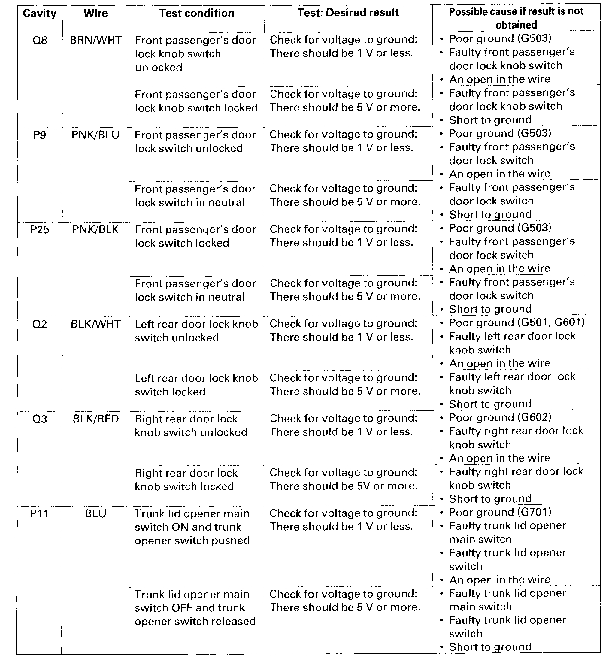

OEM Key fob wont connect to my car. Tries connecting but wont work when i press lock or unlock.

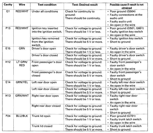

IF that doesn't help and you know the battery is good in the fob, we need to check the brains of the system. The key-less transmitter depends on a multiplex integrated control module to work. With that being said, testing it is somewhat time consuming. Here are the directions. The attached pictures correlate with these directions.
__________________________
Control Unit Input Test
1. Before testing the keyless entry/security control functions, troubleshoot the multiplex integrated control system.
Multiplex Integrated Control Unit
2. Remove the left kick panel.
See Picture 1
3. Disconnect the under-dash fuse/relay box connectors.
NOTE: All connectors are wire side of female terminals.
4. Inspect the connector and socket terminals to be sure they are all making good contact.
- If the terminals are bent, loose or corroded, repair them as necessary, and recheck the system.
- If the terminals look OK, go to step 5.

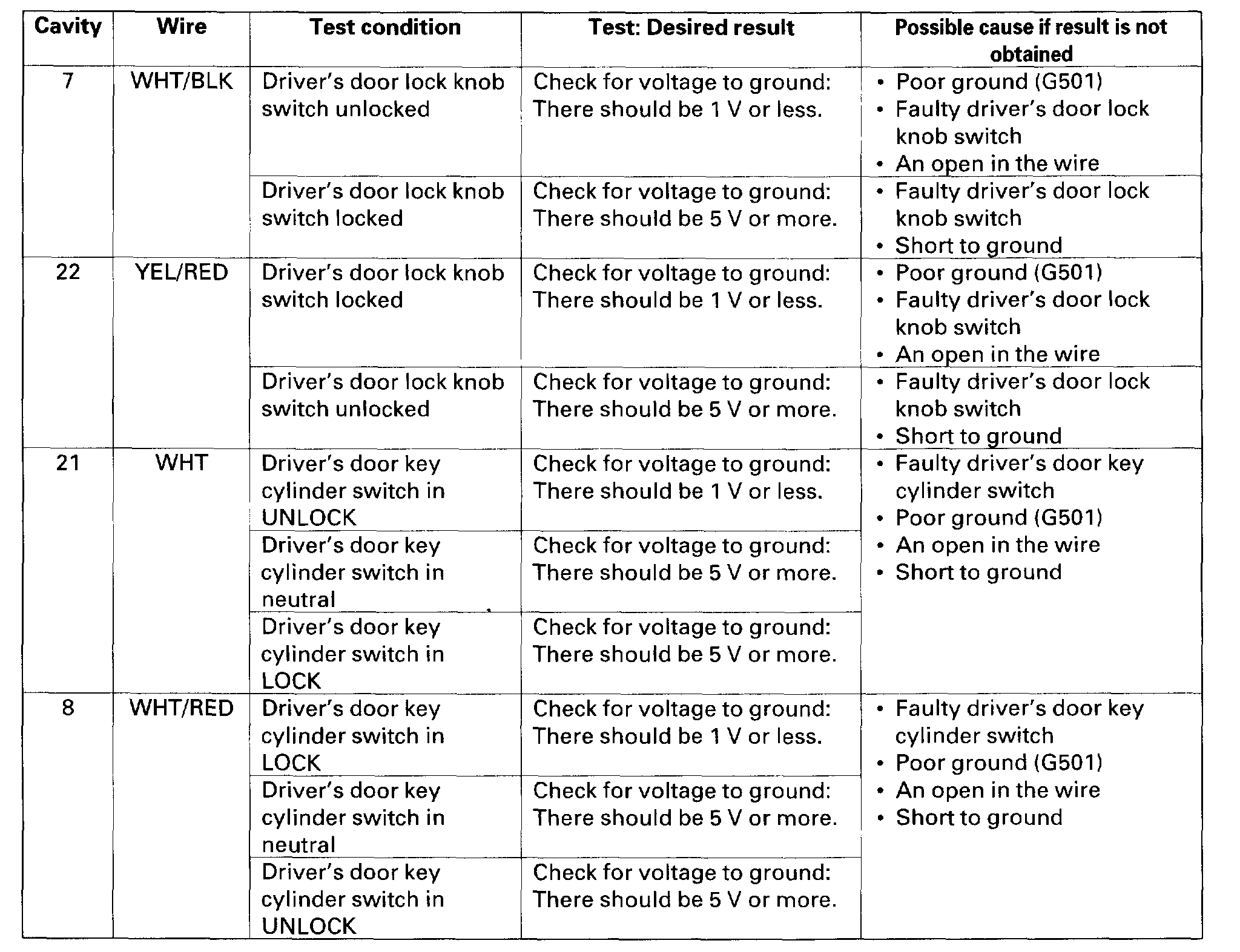

See Picture 2

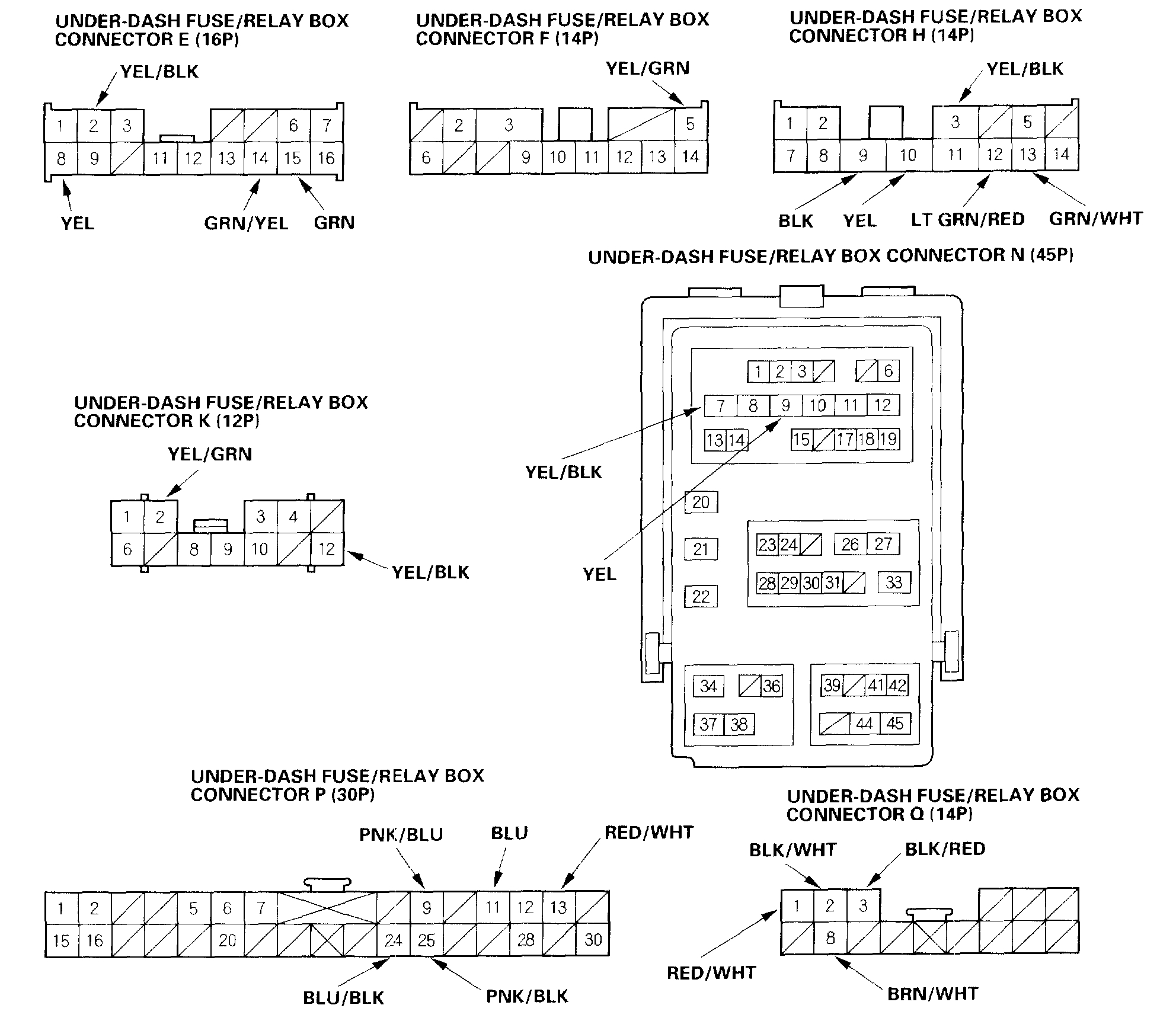

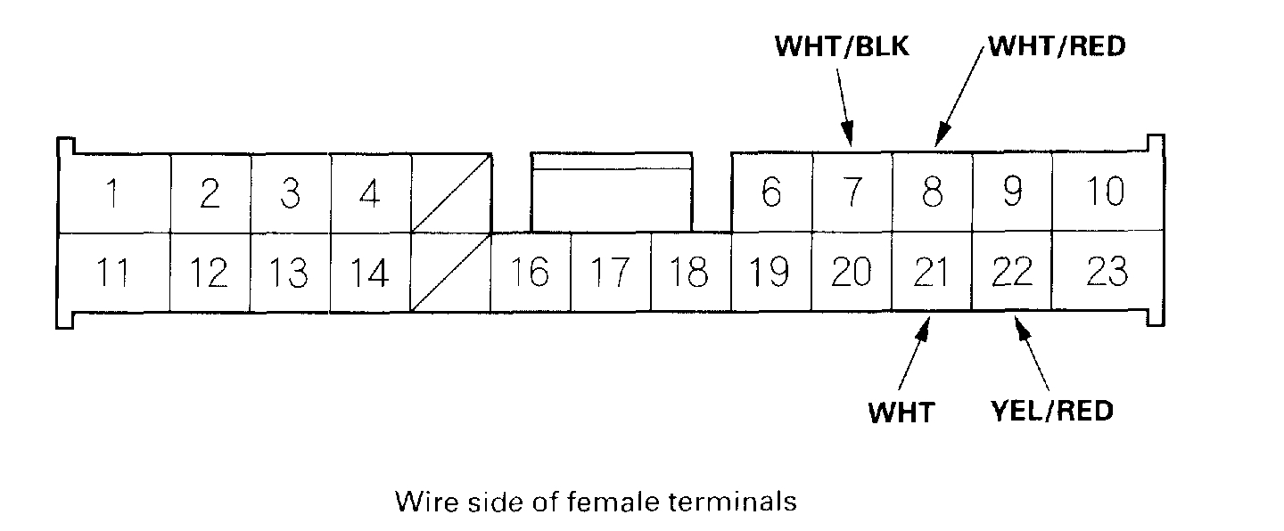

5. With the connectors still disconnected, make these input tests at the connectors.
- If any test indicates a problem, find and correct the cause, then recheck the system.
- If the input tests prove OK, go to step 6.
See Picture 3
See Picture 4
6. Reconnect all connectors to the under-dash fuse/relay box, and make these input tests at the appropriate connectors on the under-dash fuse/relay box.
- If all the input tests prove OK, go to step 7.

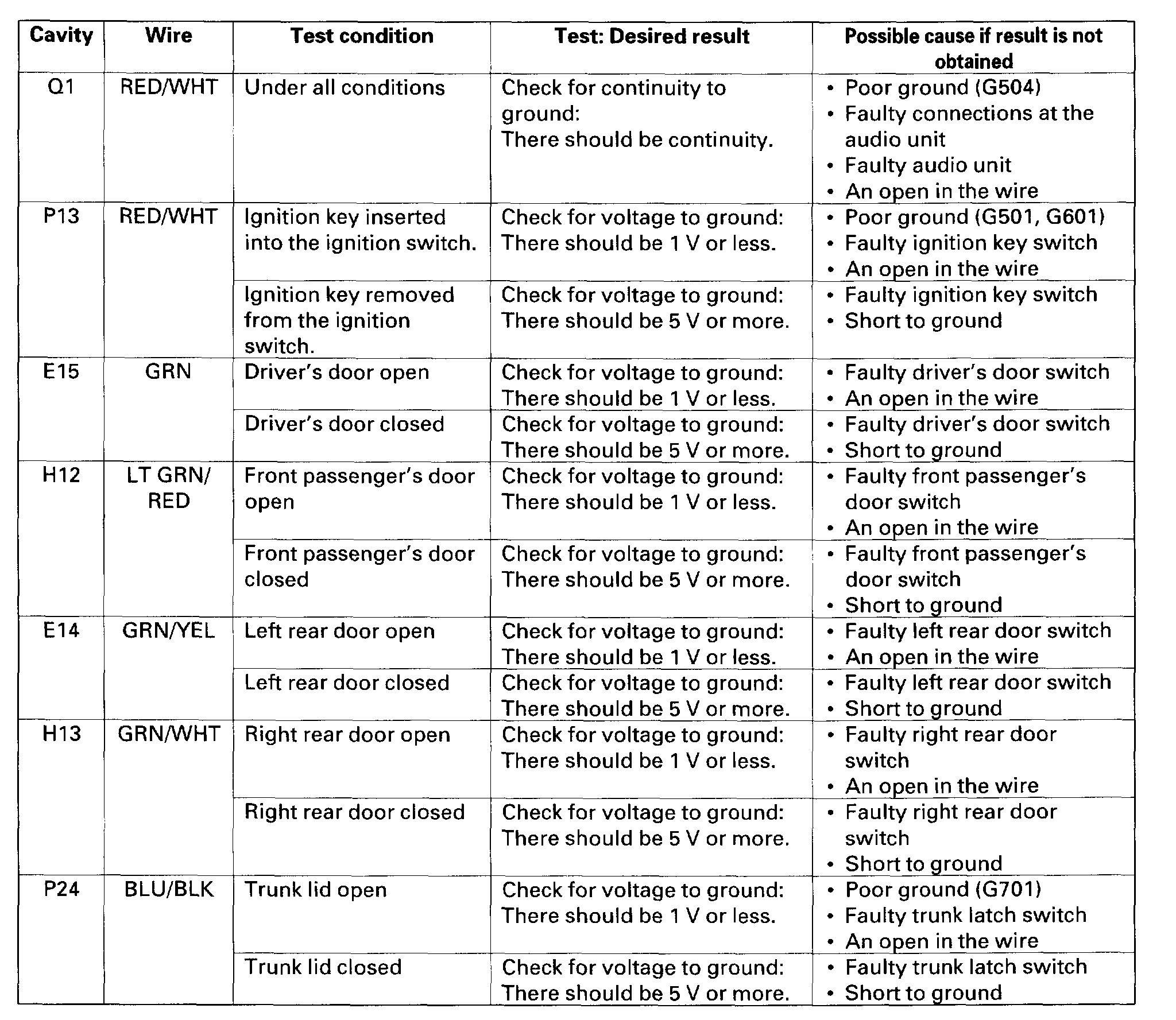

7. Remove the driver's power window switch panel.
See Picture 5

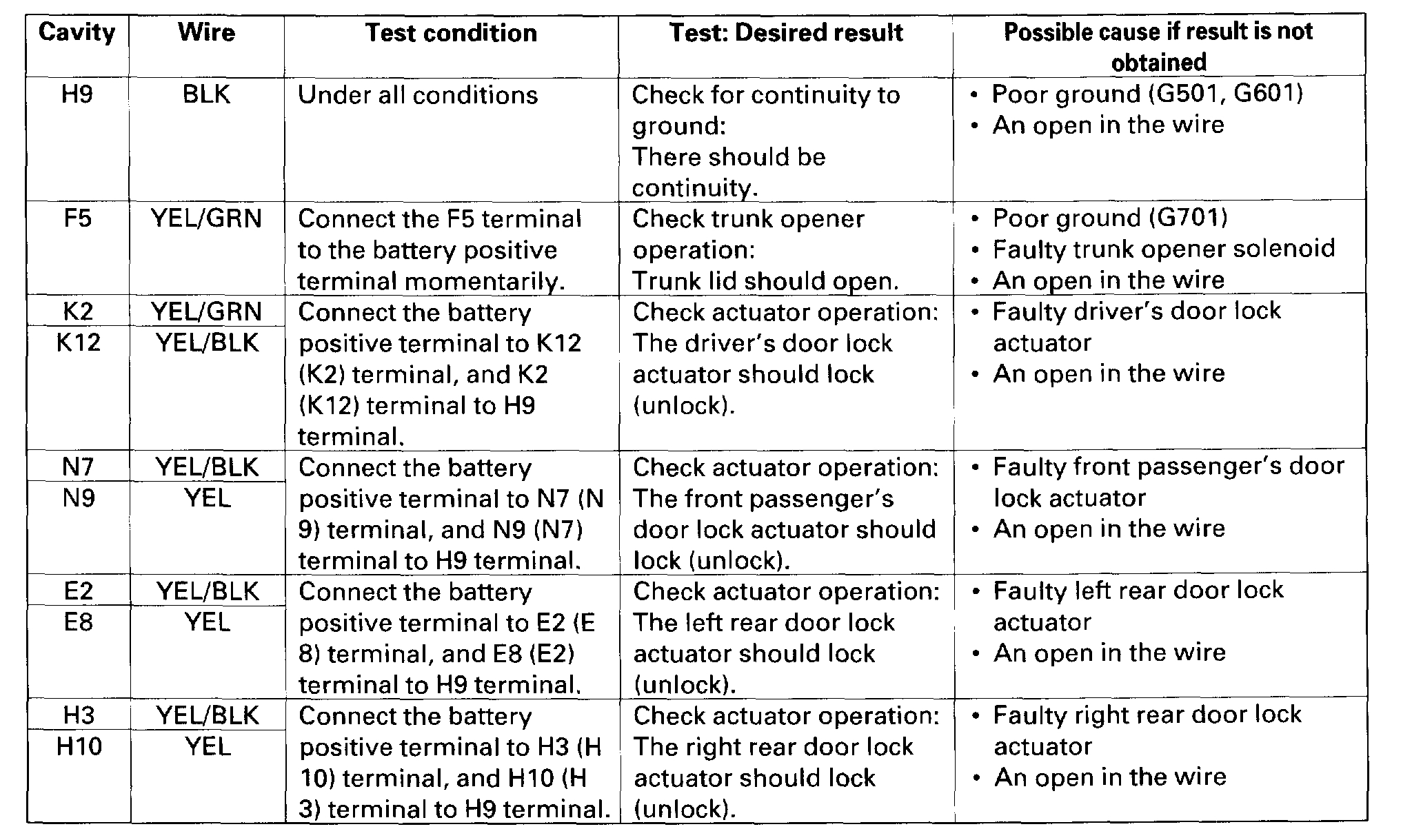

8. Disconnect the 23P connector from the power window master switch.
9. Inspect the connector and socket terminals to be sure they are all making good contact.
- If the terminals look OK, go to step 10.
See Picture 6
10. Reconnect the connector to the door multiplex control unit, and make these input tests at the connectors.
- If all the input tests prove OK, go to step 11.
11. If all the input tests prove OK, and no DTCs were found during MICS troubleshooting (B-CAN System Diagnosis Test Mode A), go to the B-CAN system input and output index. If multiple failures are found on more than one control unit, replace the under-dash fuse/relay box (includes the MICU). If input failures are related to a particular control unit, replace that control unit.
