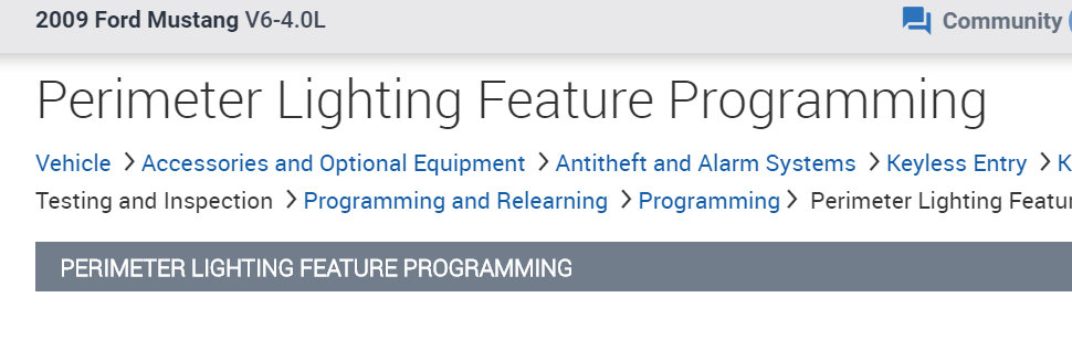

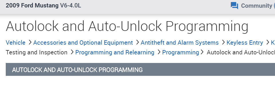

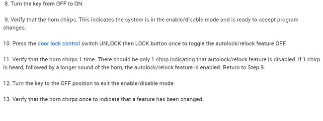

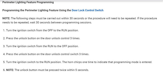

Recently my key fob stopped working so I went out to go buy a new one and tried programming it myself and wasn’t a success. so I went to my local car dealer and they couldn’t fix it nor program it either. I’m not sure if I should schedule an appointment with a Ford dealer or keep trying.
Jul 24, 2019 at 5:35 PM
SCGRANTURISMO
  • 4,897 POSTS

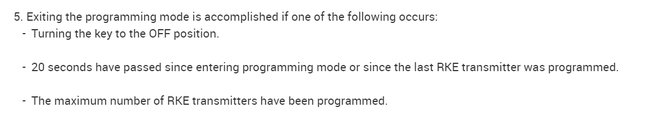

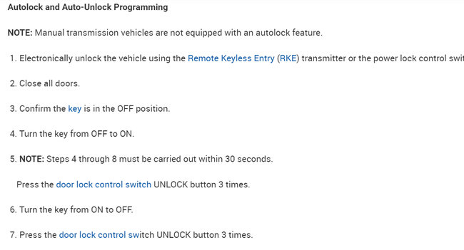

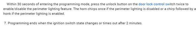

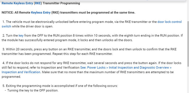

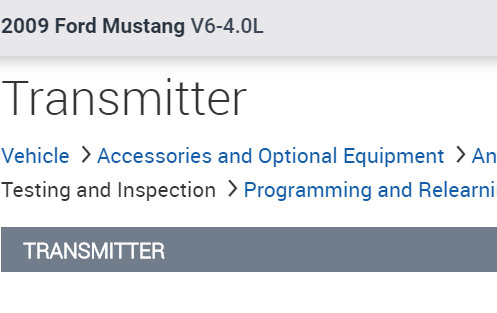

I have included the information that you requested in the diagrams down below. Please go through all three of these guides to get your key fob reprogrammed correctly, the first time, without having to go to the dealership. This is the same information that is available to the dealership's technicians. Please go through these guides and get back to us with how everything turns out.
