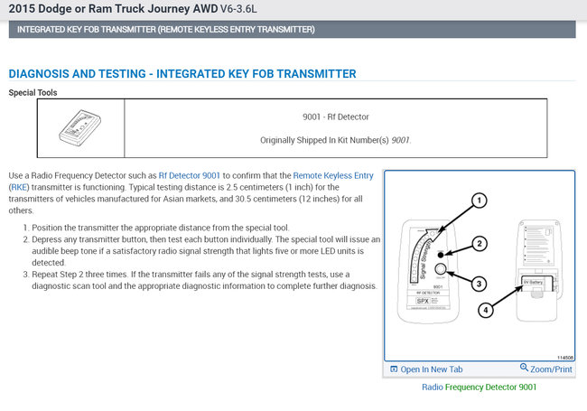

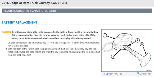

My car battery drained about 30 days ago right before vacation. I changed the battery today and everything works fine. If I walk away for a bit and come back, my wireless entry fob (that unlocks door and sets alarm) does not work until I get to door, and it unlocks by handle. Car starts and everything and then fob works again until I get out of range and then acts like it's dead again until I repeat procedure. What could be causing this?

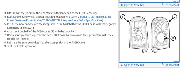

It sounds like the fob battery is weak so the range is not what it should be, here is how you can change the fob battery in the diagrams below.
BATTERY
The FOB with Integrated Key (FOBIK) transmitter is powered by a single 3-volt lithium and manganese dioxide button cell battery, which can be removed and replaced without special tools. (Refer to 08 - Electrical/8N - Power Systems/Power Locks/TRANSMITTER, Integrated Key FOB - Standard Procedure) . The international standard battery type designation is: CR2032. This battery type is available at many local retail stores. Typical battery life is approximately three years.
CAUTION:
Do not handle the batteries any more than necessary. Hands must be clean and dry.
RANGE
Normal Remote Keyless Entry (RKE) transmitter operation range for vehicles manufactured for domestic markets is up to 20 meters (66 feet) away from the vehicle. On vehicles manufactured for export markets, normal RKE transmitter range is up to 10 meters (33 feet) away from the vehicle. If a domestic market vehicle is equipped with the optional factory-installed Remote Start System, the normal transmitter range is increased to up to 91 meters (300 feet). Please note that the actual RKE transmitter range values may be better or worse than specified above, depending upon many possible variables in the environment at the specific time and location that any RKE transmission is attempted.
