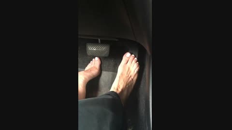

Hi, i am a mechanic but not yet a certified one. i already been on this site before for my wife's car brakes. but this time i just want to know some thing. Why do some cars keep on rolling when the engine is off even when pressing the brakes?

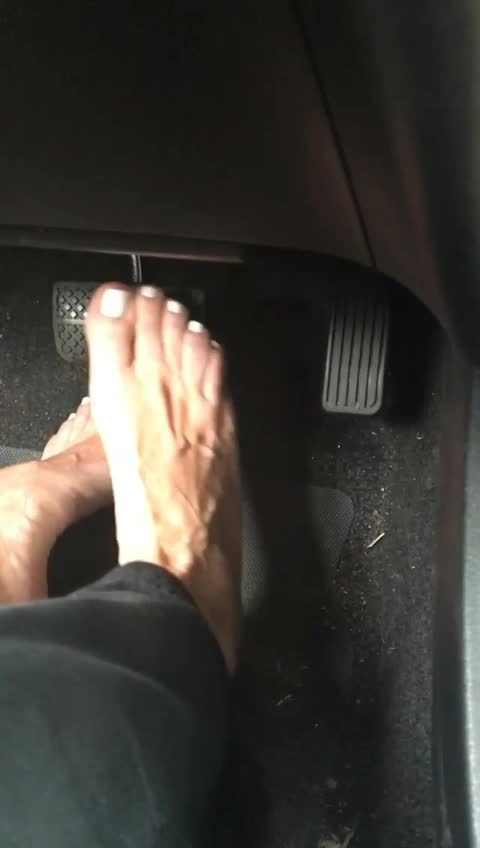

No i mean when the car is on park the brake pedal is easy to push and goes all the way down, but when start driving it goes back to normal again.

I just want to know why i goes all the way down when in park.

Wait i will send you a video. it's on my wife car before she starts to drive.

That what i wanted to know it goes all the way down first, but she starts to drive it is normal again.

You are most likely building pressure again in the system. At first, it may be bypassing the plungers in the master cylinder. After the first time, it pumps back up.
I definitely saw what you are talking about. If there are no leaks and the master cylinder is staying full, suspect it is bad.
