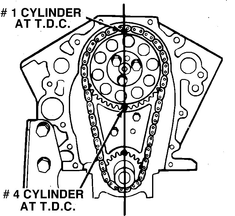

Replace timing chain, now in won't start. lined everything up like it was. Does it have a computer?

First, take a look at these directions. They explain how the chain is replaced. The attached pic indicates the timing mark alignment.
_________________
1984 GMC Truck S15/T15 2WD P/U V6-173 2.8L VIN B 2-bbl
Timing Chain Replace
Vehicle Engine, Cooling and Exhaust Engine Timing Components Timing Chain Service and Repair Procedures Timing Chain Replace
TIMING CHAIN REPLACE
Fig. 7 Valve timing marks
Pic 1
1. Remove front cover as described under ``Front Cover, Replace.''
2. Place No. 1 piston at top dead center with marks on camshaft and crankshaft sprockets aligned, Fig. 7.
3. Remove camshaft sprocket bolts, then remove sprocket and timing chain. If sprocket does not come off easily, tap lower edge of sprocket with a plastic mallet.
4. Install timing chain on camshaft sprocket. Hold sprocket vertically with chain hanging down and align marks on camshaft and crankshaft sprockets.
5. Align dowel pin hole in sprocket with dowel pin on camshaft, then install sprocket on camshaft.
6. Using camshaft sprocket attaching bolts, draw sprocket on camshaft. Torque bolts to 15 to 20 ft. lbs.
7. Lubricate timing chain with engine oil, then install front cover as outlined previously.

I did all that buddy and did it twice to make sure I didn't do nothing wrong and still nothing. it sounds like it's just free spinning.
