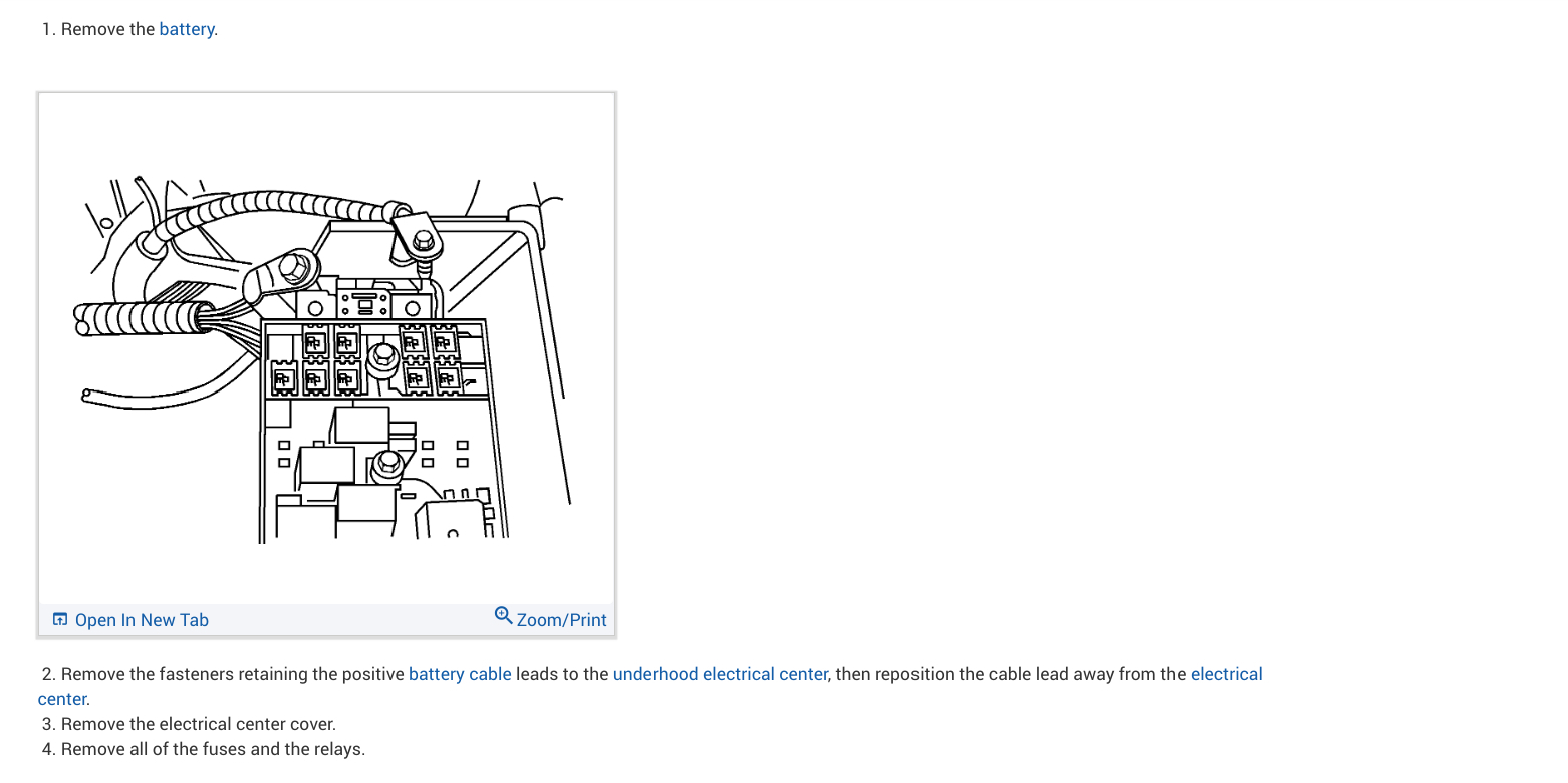

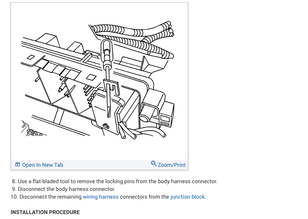

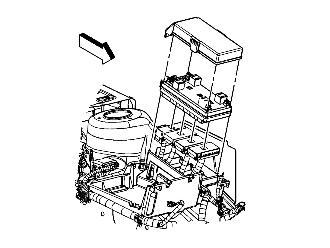

After extensive testing, I noticed multiple loose (and about to fail) relays and fuses in the block in the engine compartment. Putting the ignition key in the on position and touching certain fuses and relays caused intermittent loss of power to multiple systems (mainly the cranking, starting and ignition). I have access to another block from a compatible G6. Should I proceed with the "transplant?" And will I need reprogramming of any sort? Other issues?
Jan 31, 2020 at 9:03 PM
SCGRANTURISMO
  • 4,897 POSTS

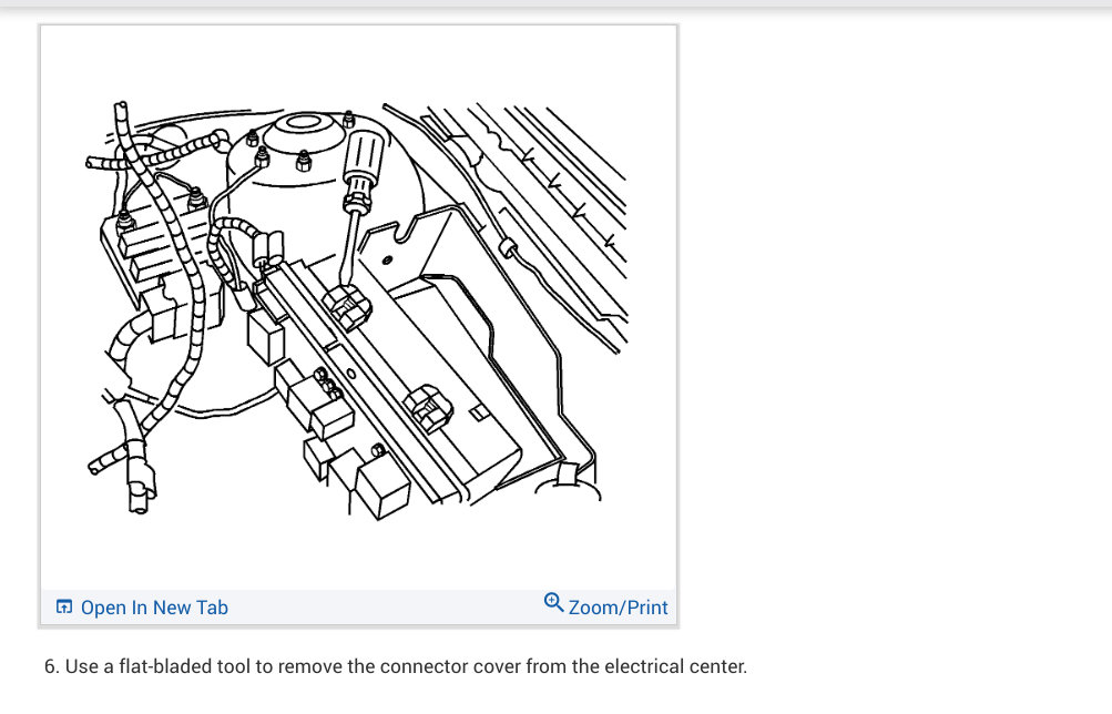

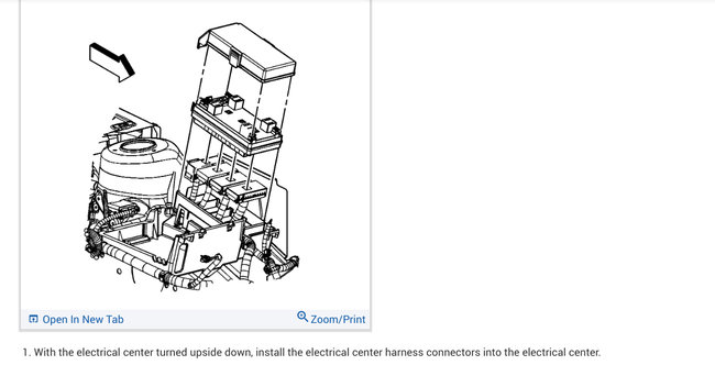

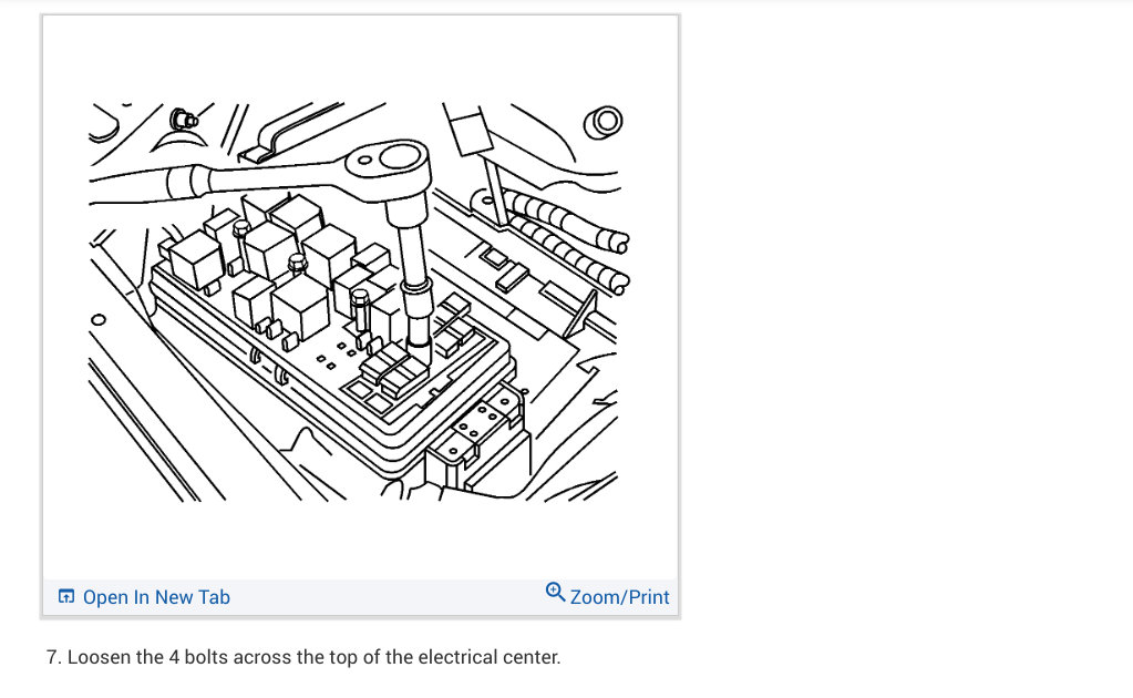

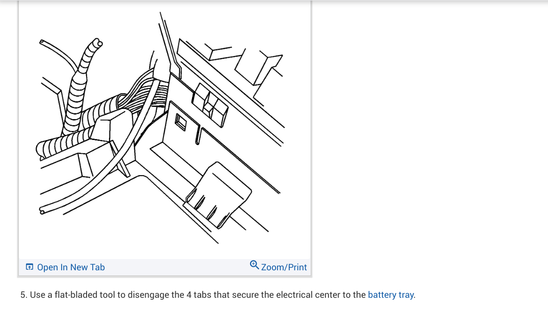

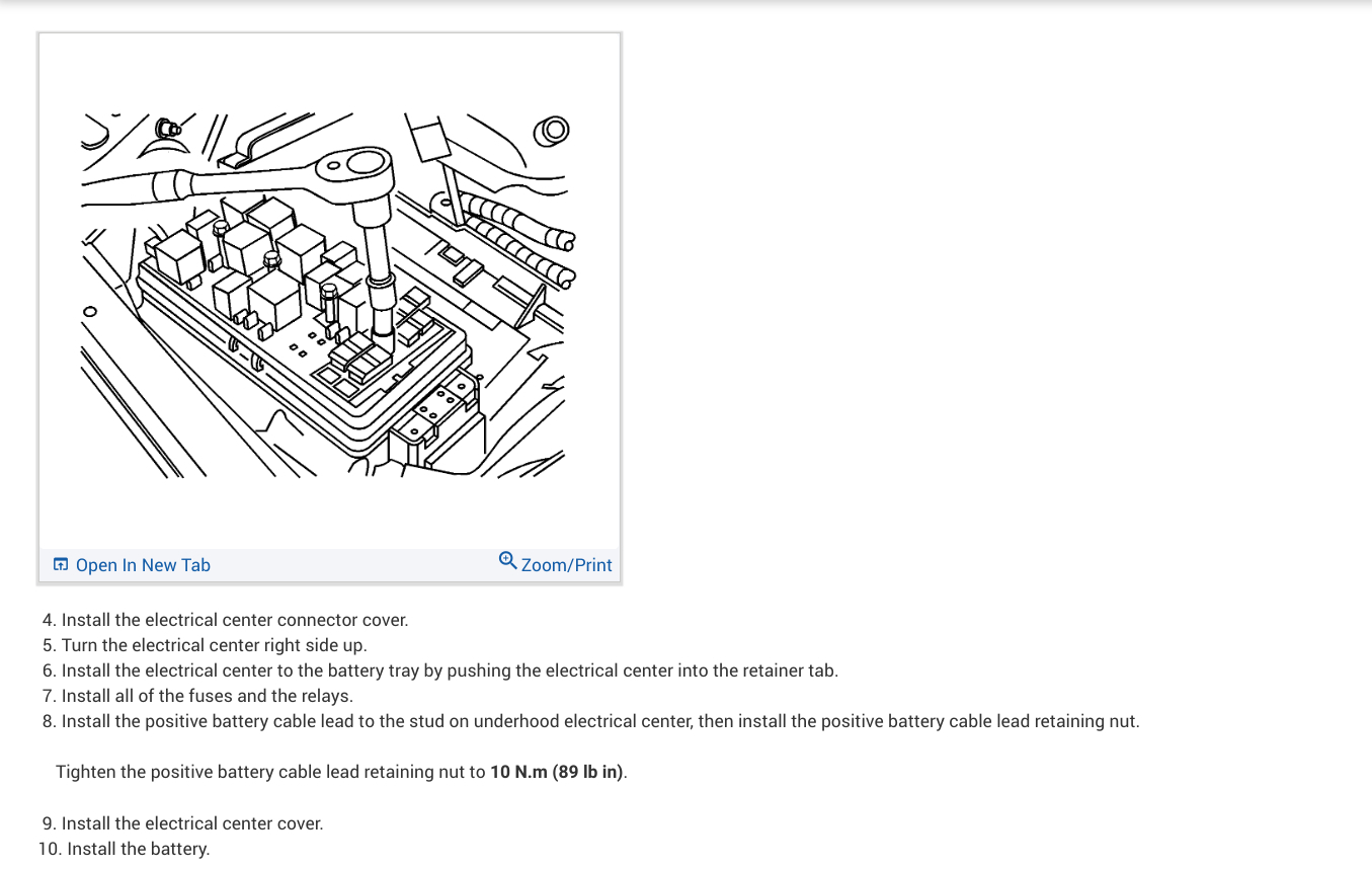

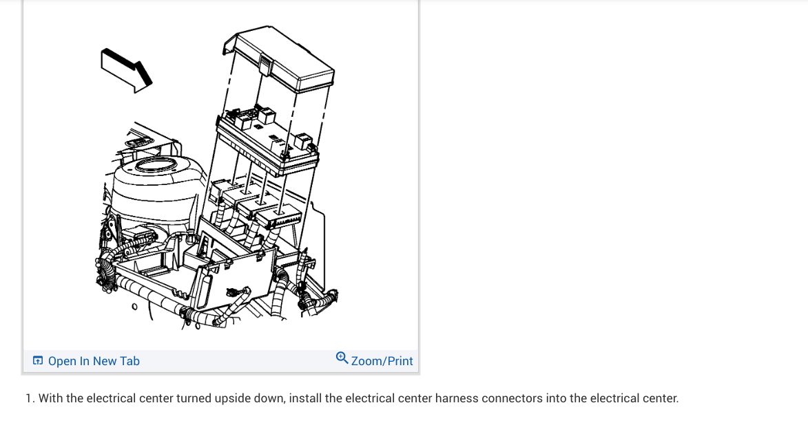

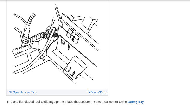

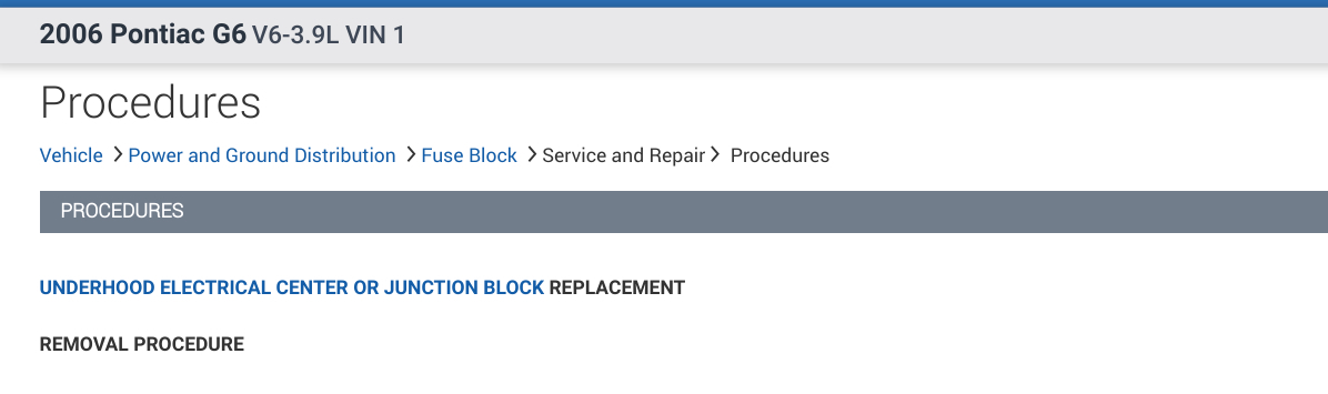

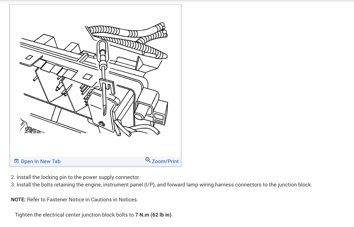

Sure. There is no reprogramming or any other sort of after action function that will need to be done. In the diagrams down below I have included the instructions from the vehicle manufacturer for the removal and installation of the junction box for your vehicle. Please go through this guide and report back with how everything turns out.
Thanks,
Alex
