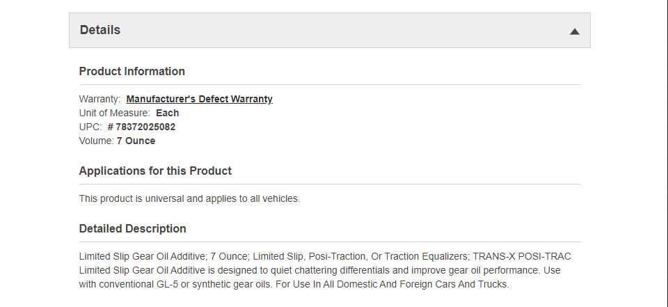

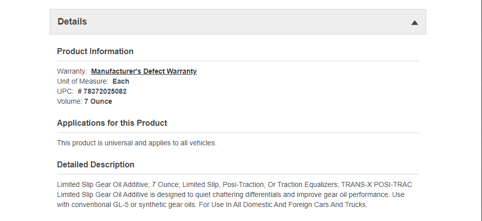

What I would try before you do anything is adding an additive to the transmission fluid called a friction modifier. Basically this is designed to soften the clutches so they don't vibrate just like conditioner for your hair.
What is causing this shudder is a clutch that is grabbing and not slipping like it should. So if you can add a 4-7 oz bottle to the transmission fluid and then you need to put about 100 miles on it before it works into the clutches.
Take a look at the description to one commonly available. Please let me know if you have questions. Thanks
