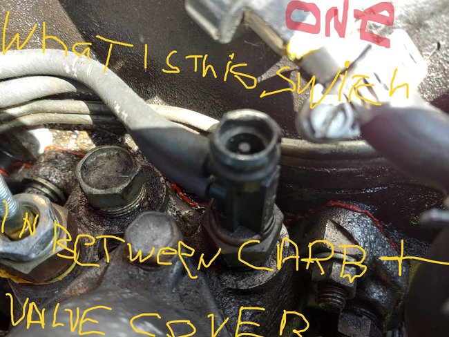

Joe, I can't find the BVSV valve below.

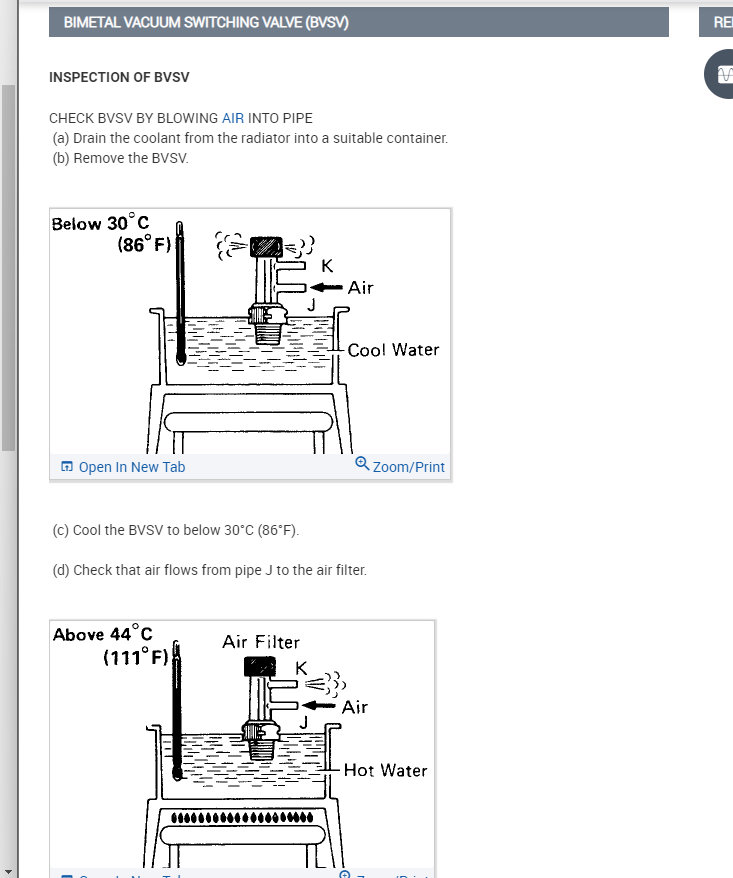

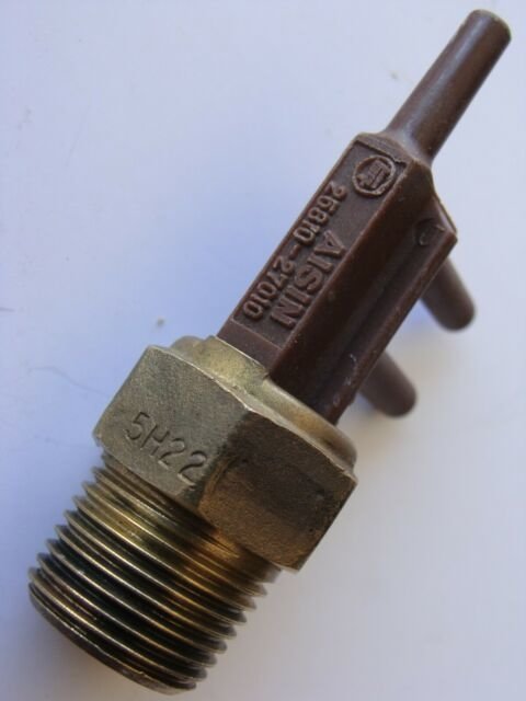

Are you saying you can't find it to replace it, or you can't find one to buy it?
I ran a quick search and found this one but please make sure the fitment is correct even though it appears it is.
https://www.toyotapartsdeal.com/oem/toyota~valve~bimetal~vacuum~switching~no~1~25810-27010.html

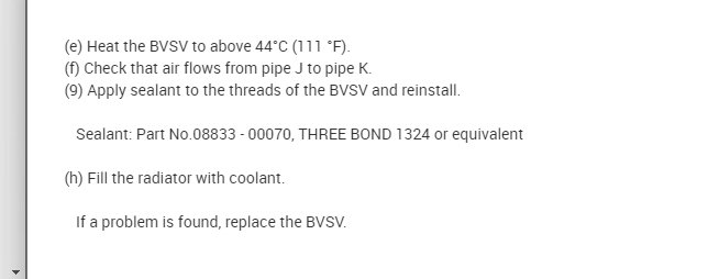

Also, just to be sure it needs to be replaced I am attaching the testing that you can run and find out.
Let me know if I misunderstood. Thanks

Kenny K, sorry I did not answer you; your response went to my Gmail account I don't check it a lot sorry. I need the ones in the pictures below, picture one has three lines running to it the top fitting in the picture is broken off.

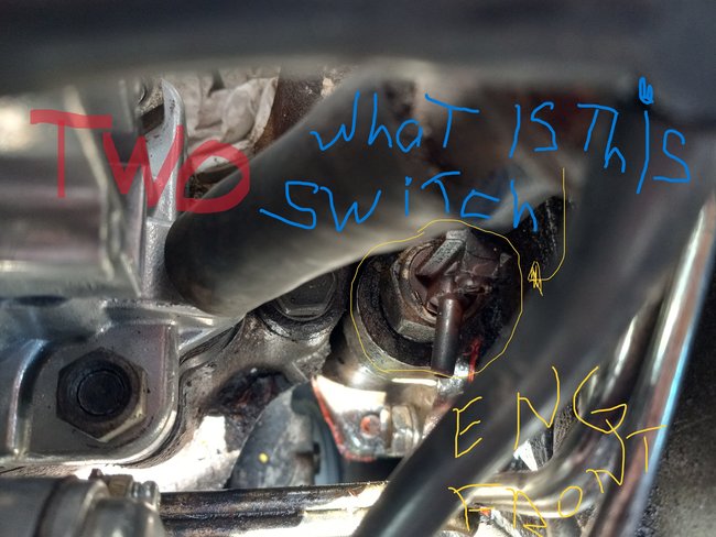

Picture two switches at the front of the truck has two lines running to it, one of the fittings is broken off. Remember the truck is an 87 Toyota pickup, the engine in the truck is a 93-fuel injected converted to a carburetor.

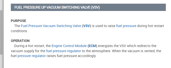

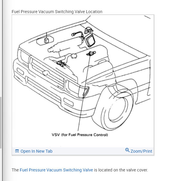

Looks like the first is called a ported vacuum switch and is used for fuel pressure control.
Here is a link to one that I found:
https://www.rockauto.com/en/catalog/toyota,1993,pickup,2.4l+l4,1277984,electrical-switch+&+relay,ported+vacuum+switch,4604
I attached info below on this one.
Can you give me a little more detail on the second one? Maybe try to see what the valve is connected to. Is it an exhaust tube or where does the tube run to?
I am just not finding anything on the front of the engine that looks like this, so I am not sure yet. If we know what this is connected to then I will have a better idea what it could be. Clearly it is a vacuum controlled switch, but I am not sure what its purpose is yet.

I will see what I can do, the truck is not at my house give me a couple of days.
