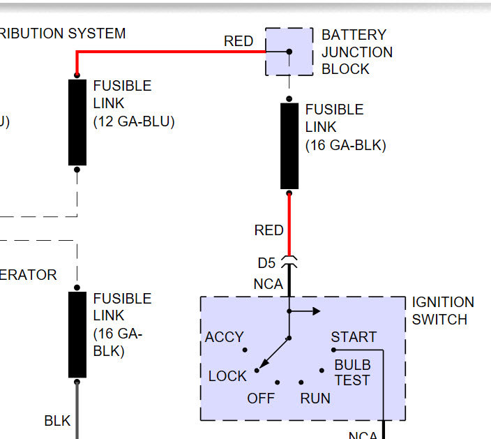

Lights will not come on car will not start. I have power from my battery but when I turn the key over no lights no ignition nothing, all fuses are fine in the cab. Cannot locate the other fuse box if there even is one. Need help, tried jumping the battery but still nothing.

Check the fusible links in picture. One goes to starter relay off of the generator. See picture.

I have check everything all relays but still no power. Alternator is maybe three months old.

The truck cranks like it wants to start but doesn't. When I turn the key over to the on position no dash lights or gauges move or come on and no sound from the fuel pump either not sure if the two are related or not I am thinking that the pump may be bad but not wanting to keep throwing money at the same problem. Can you help in any way PLEASE?
Friday, January 3rd, 2020 AT 2:47 PM (Merged)
  • 52,797 POSTS
Look at the fusible links at the battery. Your loss of power turning the key on indicates something is wrong. Once you resolve the power issue, I bet the fuel pump will come on line
