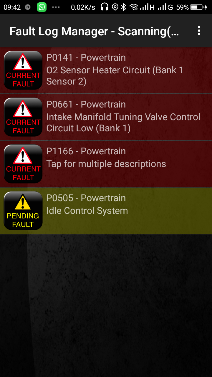

vehicle will not drive above 40 mph. As soon as it want to exceed 40 mph it starts jerking. Sometimes it may start the jerking at 20 mph.

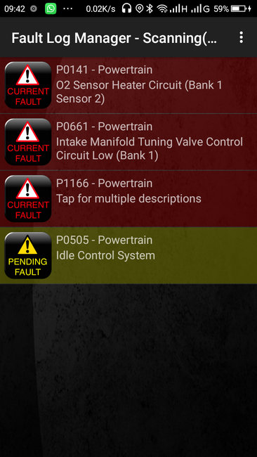

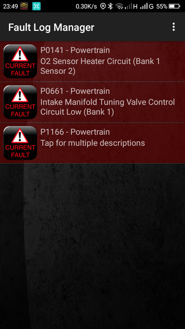

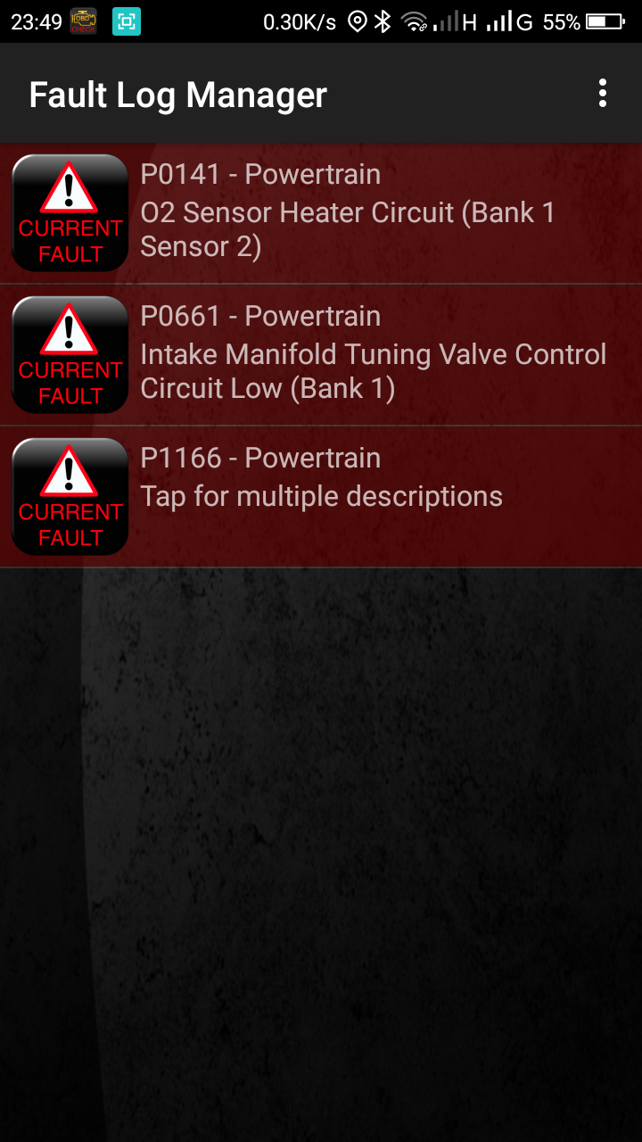

MYCRV2002
The check light is on. Have read it with a scanner and got some error codes. But the idle control has been resolved, is just that the others have been giving me much headache.

Welcome back:
Have you done anything with either of the sensors related to the codes? For example, have you checked connections and wiring for damage or corrosion?
I see you have a scanner. I will provide the directions for trouble shooting the trouble codes. If you need help, let me know. You indicate you have a lot of knowledge, but if you need anything, let me know. The attached pics correlate with the directions. Also, If I was doing this, I would most likely start with the IMRC (intake manifold runner controller).
Also, if you can provide the short and long term fuel trims, it would be helpful.

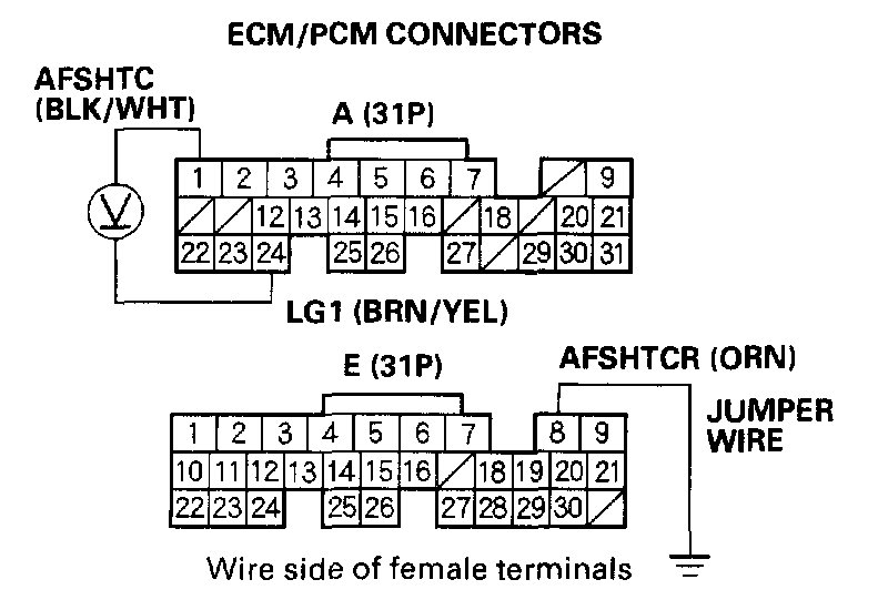

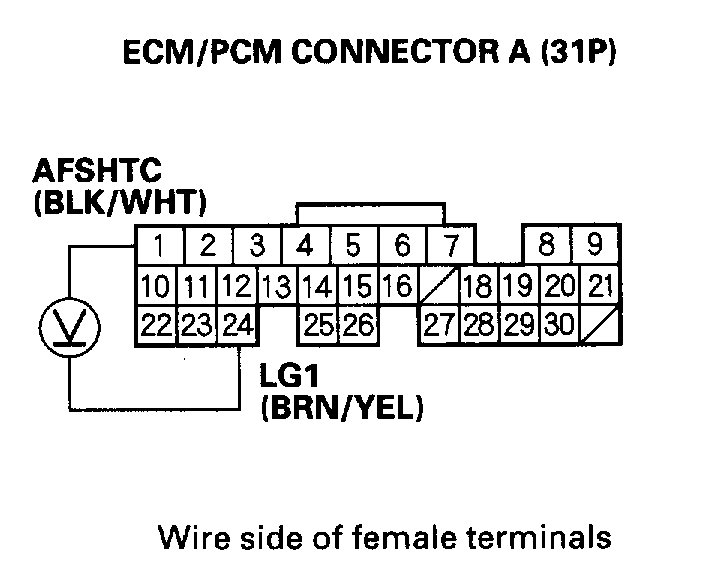

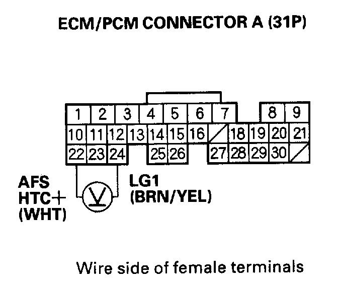

Code
P1166
Vehicle ALL Diagnostic Trouble Codes ( DTC ) Testing and Inspection P Code Charts P1166
P1166
DTC P1166: A/F Sensor (Sensor 1) Heater Circuit Malfunction
1. Reset the ECM/PCM.
2. Start the engine.
Is DTC P1166 indicated?
YES - Go to step 3.
NO - Intermittent failure, system is OK at this time. Check for poor connections or loose terminals at the A/F sensor (Sensor 1) and the ECM/PCM.
pic 1

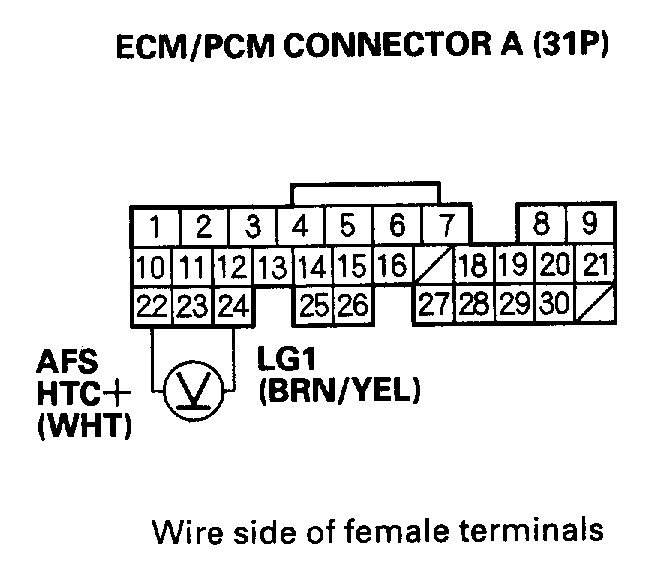

3. Measure voltage between ECM/PCM connector terminals A1 and A24, 30 seconds after the ignition switch is turned ON (II).
Is there battery voltage?
YES - Update the ECM/PCM if it does not have the latest software, or substitute a known-good ECM/PCM, then recheck. If the symptom/indication goes away with a known-good ECM/PCM, replace the original ECM/PCM.
NO - Go to step 4.

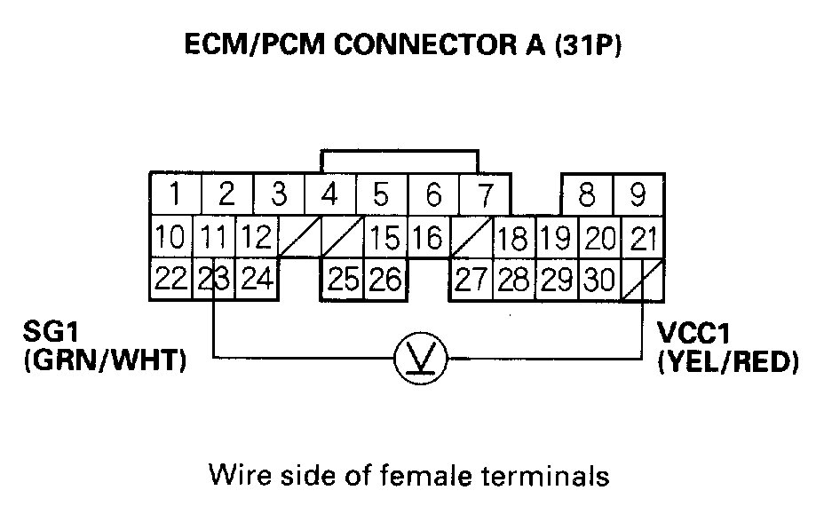

pic 2
4. Measure voltage between ECM/PCM connector terminals A22 and A24.
YES - Go to step 5.
NO - Go to step 9.

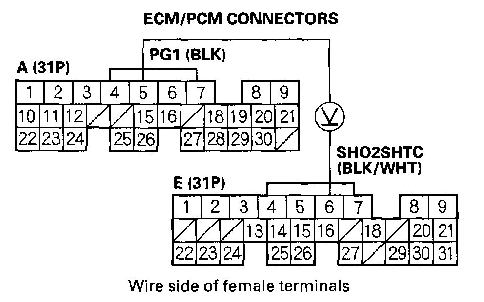

5. Turn the ignition switch OFF.
6. Disconnect ECM/PCM connector A (31P).
7. Turn the ignition switch ON (II).
pic 3
8. Connect ECM/PCM connector terminal E8 to body ground with a jumper wire, then measure voltage between ECM/PCM connector terminals A1 andA24.
YES - Update the ECM/PCM if it does not have the latest software, or substitute a known-good ECM/PCM.then recheck. If the symptom/indication goes away with a known-good ECM/PCM, replace the original ECM/PCM.
NO - Repair open or short in the wire between the A/F sensor (Sensor 1) and the ECM/PCM (A1).

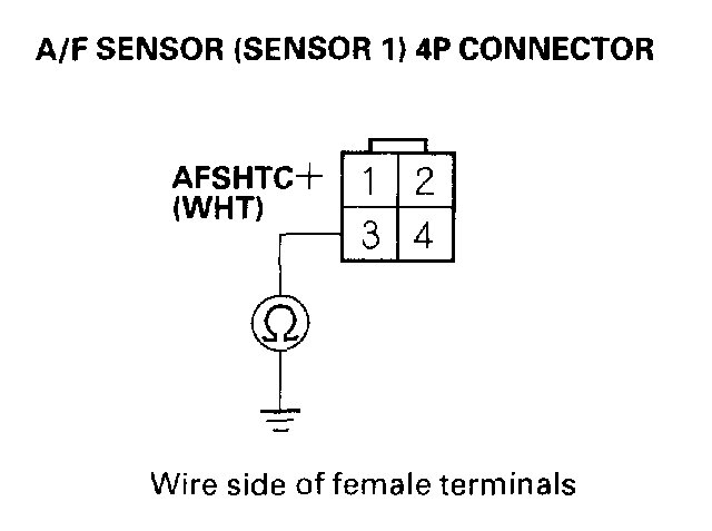

9. Turn the ignition switch OFF.
10. Disconnect ECM/PCM connector A (31P) and the A/F sensor (sensor 1) 4P connector.
pic 4
11. Check for continuity between A/F sensor (Sensor 1) 4P connector terminal No. 3 and body ground.
Is there continuity?
YES - Repair short in the wire between the A/F sensor relay, A/F sensor (Sensor 1), and the ECM/PCM (A22).
NO - Go to step 12.

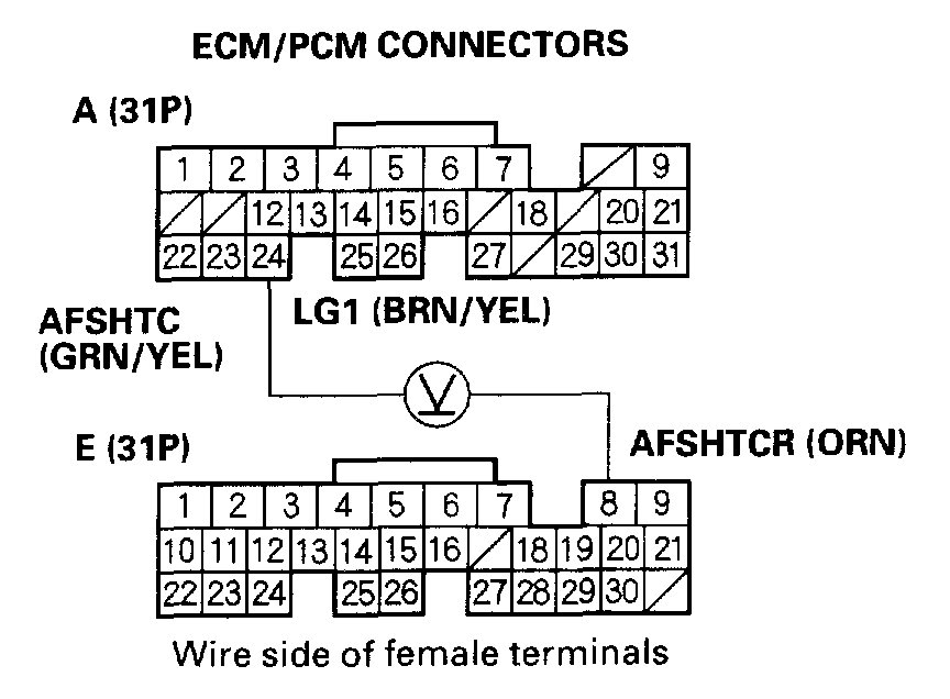

12. Turn the ignition switch ON (II).
pic 5
13. Measure voltage between ECM/PCM connector terminals E8 and A24.
YES - Repair open in the wire between the ECM/PCM (A22) and the A/F sensor (Sensor 1) or A/F sensor relay.
NO - Go to step 14.

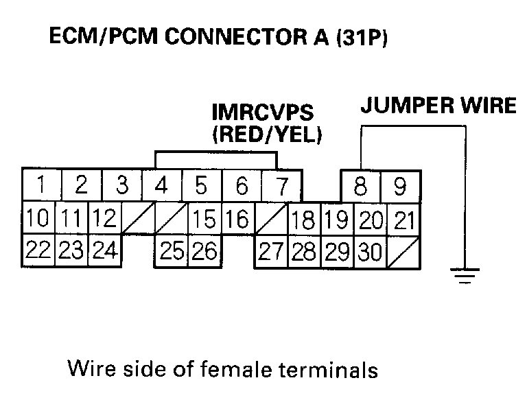

IMRC = Intake manifold runner control. I have a feeling this is the root of the problem.

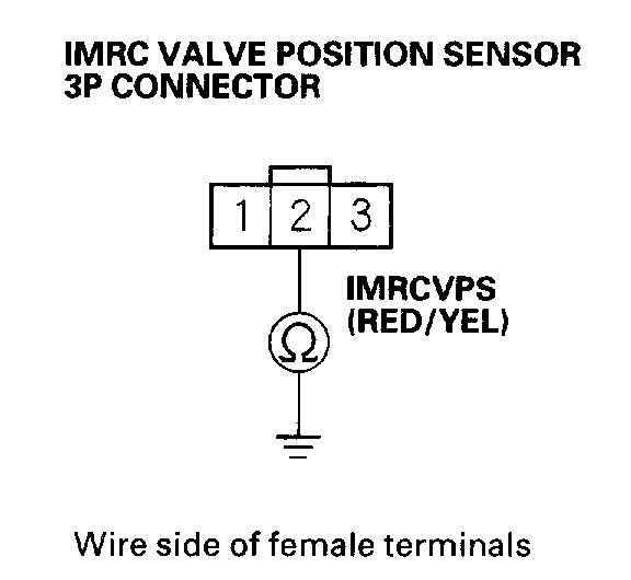

Code
P0661
Vehicle ALL Diagnostic Trouble Codes ( DTC ) Testing and Inspection P Code Charts P0661
P0661
DTC P0661: IMRC Valve Position Sensor Circuit Low Voltage
Is DTC P0661 indicated?
YES - Go to step 3.
NO - Intermittent failure, system is OK at this time. Check for poor connections or loose terminals at the IMRC valve position sensor and at the ECM/PCM.

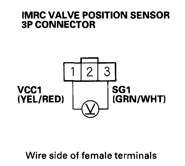

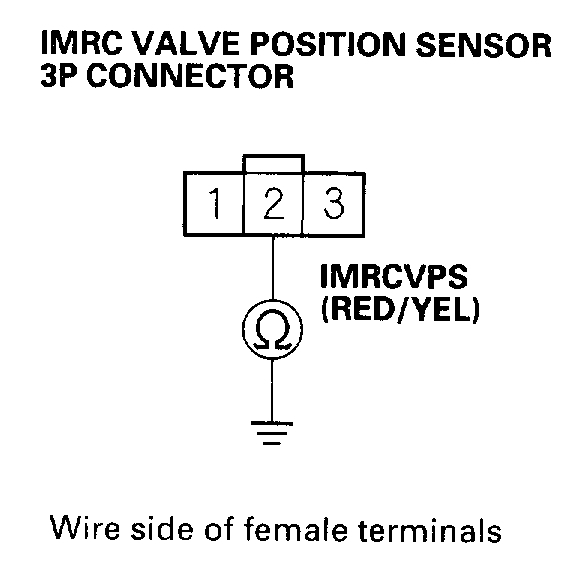

3. Turn the ignition switch OFF.
4. Disconnect the IMRC valve position sensor 3P connector.
5. Turn the ignition switch ON (II).
pic 6
6. Measure voltage between IMRC valve position sensor 3P connector terminals No. 1 and No. 3.
Is there about 5 V?
YES - Go to step7.
NO - Go to step 14.

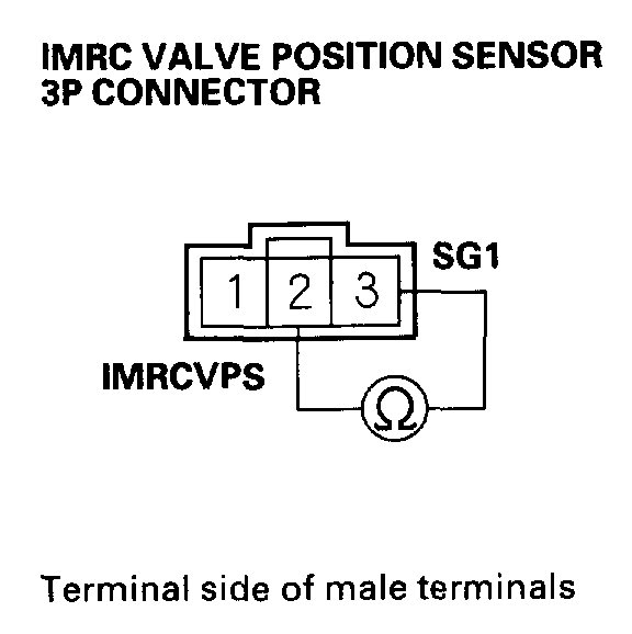

7. Turn the ignition switch OFF.
pic 7

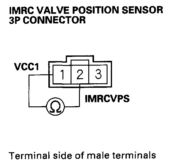

8. At the sensor side, measure resistance between IMRC valve position sensor 3P connector terminals No. 2 and No. 3.
Is there about 3.2 kOhm ?
YES - Go to step 9.
NO - Replace the IMRC valve position sensor.
pic 8
9. Measure resistance between IMRC valve position sensor 3P connector terminals No. 1 and No. 2.
Is there about 9.5 kOhm?
YES - Go to step 10.
10. Disconnect ECM/PCM connector A (31P).
pic 9

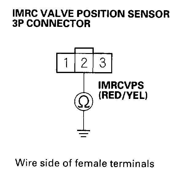

11. At the wire harness side, check for continuity between IMRC valve position sensor 3P connector terminal No. 2 and body ground.
YES - Repair short in the wire between the ECM/PCM (A8) and the IMRC valve position sensor.
NO - Go to step 12.
pic 10
12. Connect ECM/PCM connector terminal A8 to body ground with a jumper wire.
pic 11
13. At the wire harness side, check for continuity between IMRC valve position sensor 3P connector terminal No. 2 and body ground.
NO - Repair open in the wire between the ECM/PCM (A8) and the IMRC valve position sensor.
pic 12
14. Measure voltage between ECM/PCM connector terminals A11 and A21.
Is there about 5 V?
YES - Repair open in the wire between the ECM/PCM (A21) and the IMRC valve position sensor.
NO - Update the ECM/PCM if it does not have the latest software, or substitute a known-good ECM/PCM, then recheck. If the symptom/indication goes away with a known-good ECM/PCM, replace the original ECM/PCM.
_________________________________________

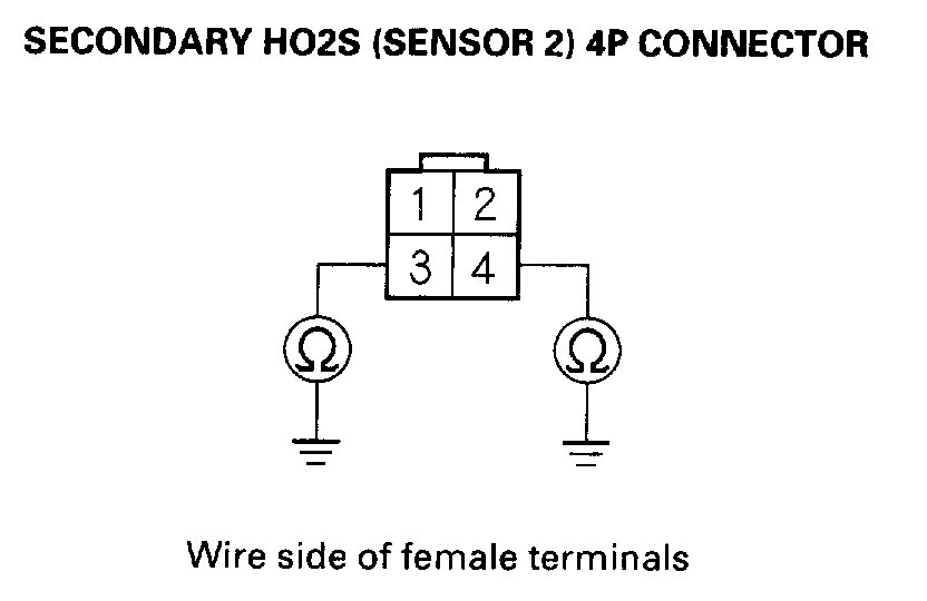

DTC P0141: Secondary HO2S (Sensor 2) Heater Circuit Malfunction
Is DTC P0141 indicated?
YES - Go to step 3.
NO - Intermittent failure, system is OK at this time. Check for poor connections or loose terminals at the secondary HO2S (Sensor 2) and at the ECM/PCM.
3. Check the No.4 ACG (10 A) fuse in the under-dash fuse/relay box.
Is the fuse OK?
YES - Go to step 4.
NO - Replace the fuse and retest.

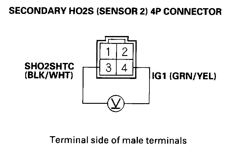

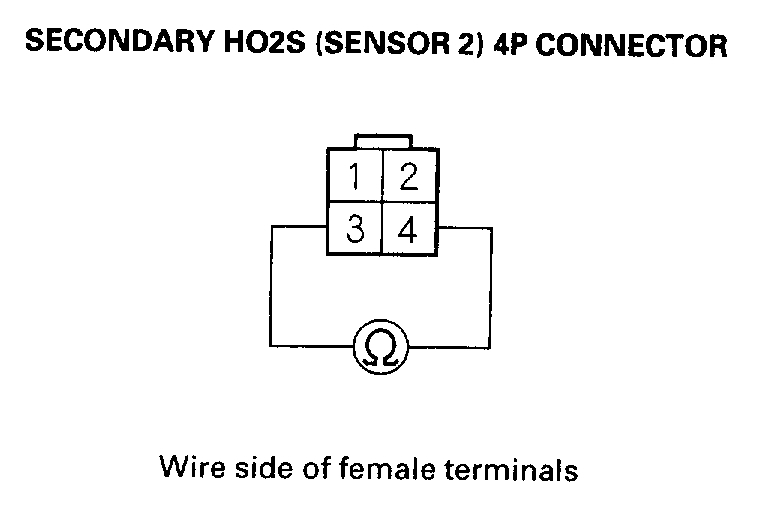

4. Turn the ignition switch OFF.
5. Disconnect the secondary HO2S (Sensor 2) 4P connector.
pic 13
6. At the secondary HO2S (Sensor 2) side, measure resistance between HO2S 4P connector terminals;
Is there about 3.3 Ohm at room temperature?
YES - Go to step 7.
NO - Replace the secondary HO2S (Sensor 2).
pic 14
7. Check for continuity between body ground and secondary HO2S (Sensor 2) 4P connector terminals No. 3 and No. 4 individually.
YES - Replace the secondary HO2S (Sensor 2).
NO - Go to step 8.
8. Turn the ignition switch ON (II).
pic 15
9. Measure voltage between secondary HO2S 4P connector terminals No. 3 and No. 4.
NO Go to step 13.

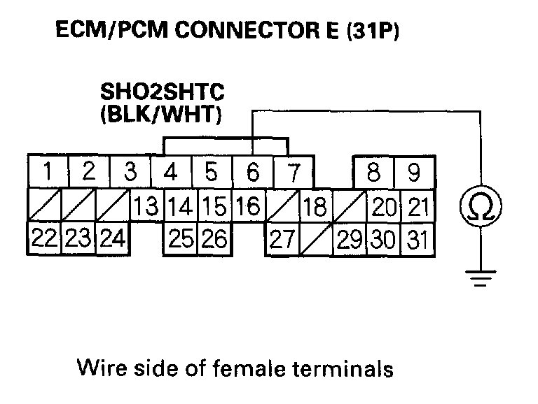

10. Turn the ignition switch OFF.
11. Disconnect ECM/PCM connector E (31P).
pic 16
12. Check for continuity between ECM/PCM connector terminal E6 and body ground.
YES - Repair short in the wire between the ECM/PCM (E6) and the secondary HO2S (Sensor 2).

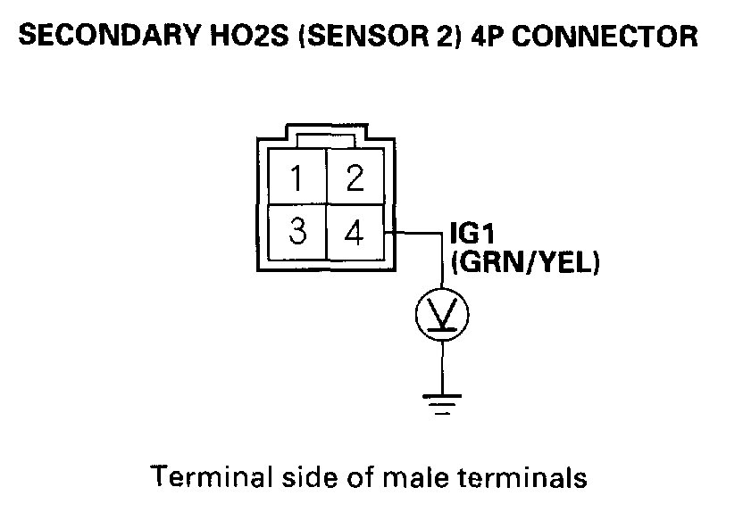

13. Measure voltage between secondary HO2S (Sensor 2) 4P connector terminal No. 4 and body ground.
YES - Go to step 14.
NO - Check the No. 4 ACG (10 A)fuse in the under-dash fuse/relay box. If the fuse is OK, repair open in the wire between the secondary HO2S (Sensor 2) and No.4 ACG (10 A)fuse.
