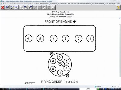

My spark plug wires got mixed up some how while i was changing the sprak plugs. I thought I had taken care to replace each one properly but I guess not. I need a diagram to rearrange the wires properly.
Model: 199 Wrangler
4.0 L - 6 cyl
129K miles
Thanks Merlin - You saved me!

https://images.2carpros.com/forum/automotive_pictures/62217_FiringOrder_1.jpg
