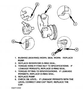

where exactly is the pwr stearing fluid located?
Dec 9, 2007 at 11:11 AM
SERVICE WRITER
  • 9,123 POSTS
I'll try to find a pic, but there is a reservior that holds the fluid. If you look aroung the belt area you should find the power steering pump, the reservior feeds the pump. Look at #6
https://images.2carpros.com/forum/automotive_pictures/30961_psp_1.jpg
ONLY USE AFT +4 TRANSMISSION FLUID IN THIS SYSTEM!!!
