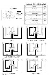

Ok lets do a test on the wiring and see if the right voltage is getting to it. You could have a bad motor too it does happen sometimes. Ok first make a jumper wire and disconnect the plug from the blower motor and connect battery voltage to a connector on the motor itself and see how it works then. Here is a vacuum diagram for the heater system too.
https://www.2carpros.com/forum/automotive_pictures/249564_heater_vacuum_1.jpg
Let me know what you find and we will go through the next step and check the switch ok. Thanks again.

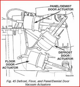

May I offer my 2 cents. I beleive you have a vacuum leak. The fact that you can hear the fan change speeds tells me that all electrical problems are ruled out. The air is blown into the heater box and then distributed to vents or defroster by a few doors actuated by vacuum switches. The doors remain closed until opened by the respective vacuum switch. This would explain why the fan blows but no air comes out. The vacuum switches are located under the dash board to the right of the gas pedal. You should be able to see them move when you switch from defrost to foot well heating modes. The recirculate option is operated by cable and would work even if you have a leak. Please switch between foot well to vent to defrost and let me know if you hear the sound (muffled thunk) of the doors closing. Or cram your head up into the drivers foot well and crane your head up to the right and then make the changes to see if the vacuum switches move. The first option is easier. Good luck.

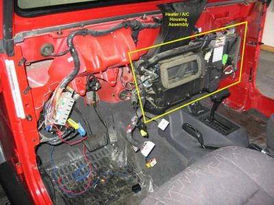

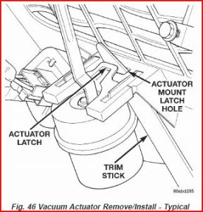

Well I feel your pain... I have been there. I live in New England so it gets cold but usually doesn't stay too bad for long. Here is a picture of the vacuum switches. They probably won't be arranged exactly like this because the image is from a 99 but it is a good representation. You can try to remove an actuator arm and open the door manually. I don't know if it will stay open but if it defrosts your feet it is worth a try. Good luck and let us know how you make out. The photo is from a write up on www.stu-offroad.com Just want to give props. The Vacuum switches are on the left hand side of the yellow box.

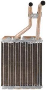

The heater core looks like a mini radiator...
https://www.2carpros.com/forum/automotive_pictures/283274_getimage_1.jpg
Air Flows through it and removes heat from the fluid that circulates inside it. If it were the cause of the airflow problem, when you switch to cool air on the heater control panel then the air would bypass it and flow unobstructed.
