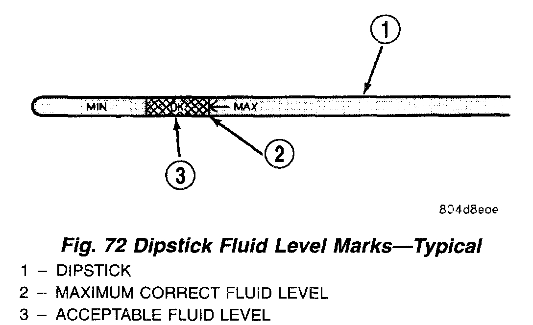

I have a the vehicle listed above Laredo, that won't shift out of first gear. I have to take the RPM's all way up to 4,000 before it will shift. I'll drive it after it shifts and it runs fine until it comes to a complete stop.

Is the check engine light staying on when the engine is running? If it is, then you need to scan the computer for diagnostic trouble codes. That will point us in the right direction,.

Next, have you checked and confirmed the transmission fluid is clean and full? Here are directions specific to your vehicle for checking level and condition. The attached picture correlates with the directions.

The transmission has a dipstick to check oil level. It is located on the right side of the engine. Be sure to wipe all dirt from dipstick handle before removing.
Fluid level is checked with the engine running at curb idle speed, the transmission in NEUTRAL and the transmission fluid at normal operating temperature. The engine should be running at idle speed for at least one minute, with the vehicle on level ground.
Transmission fluid level should be checked monthly under normal operation. If the vehicle is used for trailer towing or similar heavy load hauling, check fluid level and condition weekly. Fluid level is checked with the engine running at curb idle speed, the transmission in NEUTRAL and the transmission fluid at normal operating temperature.
FLUID LEVEL CHECK PROCEDURE
1. Transmission fluid must be at normal operating temperature for accurate fluid level check. Drive vehicle if necessary to bring fluid temperature up to normal hot operating temperature of 82 °C (180 °F).
2. Position vehicle on level surface.
3. Start and run engine at curb idle speed.
4. Apply parking brakes.
5. Shift transmission momentarily into all gear ranges. Then shift transmission back to Neutral.
6. Clean top of filler tube and dipstick to keep dirt from entering tube.
Fig. 72
See pic 1
7. Remove dipstick (Fig. 72) and check fluid level as follows:
a. Correct acceptable level is in crosshatch area.
b. Correct maximum level is to MAX arrow mark.
c. Incorrect level is at or below MIN line.
d. If fluid is low, add only enough Mopar ATF +4 to restore correct level. Do not overfill.
CAUTION: Do not overfill the transmission. Overfilling may cause leakage out the pump vent which can be mistaken for a pump seal leak. Overfilling will also cause fluid aeration and foaming as the excess fluid is picked up and churned by the gear train. This will significantly reduce fluid life.

Let me know what you find. Also, let me know if any diagnostic trouble codes are found.
