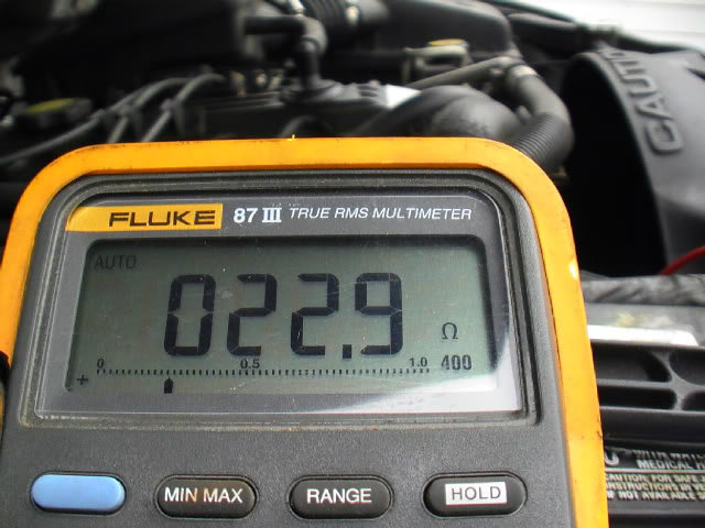

When the jeep is started in cold weather it will make a slight knocking noise until the coolant temp hits around 180. After it warms up the noise goes away. Then the jeep idles rough when in drive, but not so much when in park or neutral. I have noticed recently a faint noise when accelerating that sounds like something vibrating in the glove box, but there is nothing in there. So far I have changed the spark plugs, 02 sensors, checked all vacuum lines, cleaned the throttle body, cleaned idle speed motor, hooked the car up to a scan tool (no error codes). I have put a tank full of mid grade fuel in and it seemed to reduce the engine noise but my performance has not improved. During this time my mpg has dropped from 25-27 to 19-22. Please help.

Ok I need you to do some testing. So you will need a digital multi meter. Now if you would unplug the coolant temp sensor (not sender) and do an ohm's test on the sensor (not the harness) and if you do this cold then you can give the air temp at the time of the test with the ohm reading and I will see if it is in spec. Lets start there and see where we need to go from there. Now some questions, when was the last tune up done? When was the fuel filter replaced last (only on grand cherokee's). How is the air filter and how are the boots on the coil pack? Get back to me and we will go from there.

I went out and checked the cooland temp sensor and got a reading of 32.90 on a 40K ohm scale. My Jeep only has 1 coolant temp sensor for both the temp sensor and sender for the gauge. I believe the temp outside was about 30 degrees. I also took a reading for the air charge sensor which is the same sensor part number and it was 32.59 on a 40K scale.

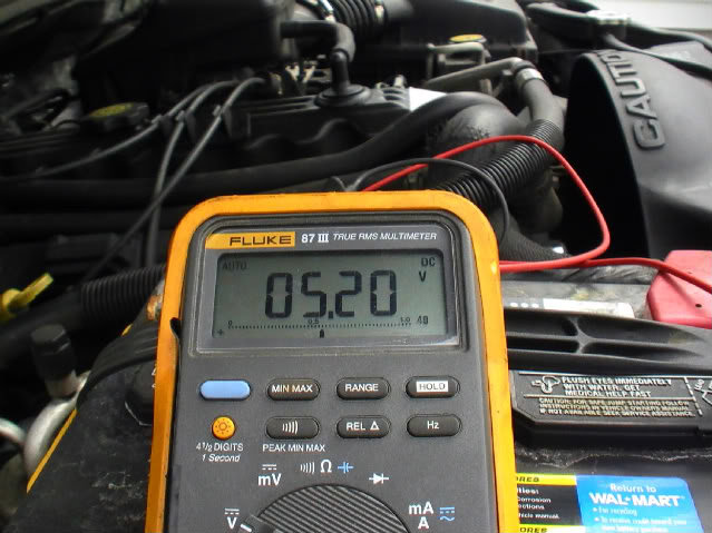

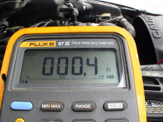

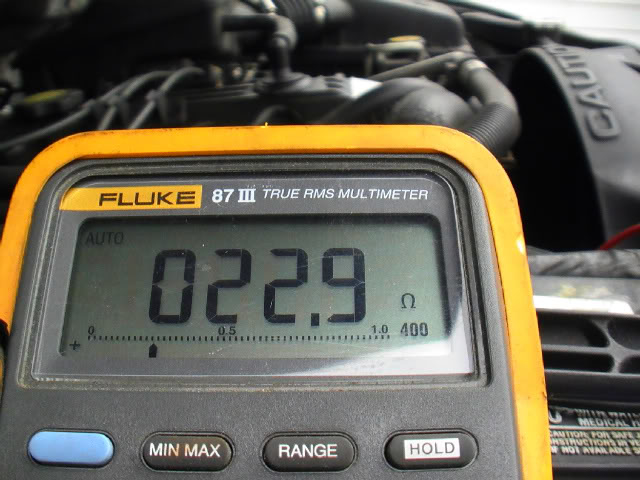

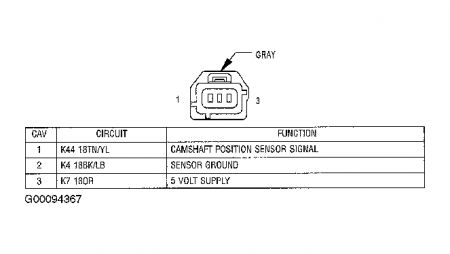

Ok where the distributor would be there is a camshaft sensor there. I need you to unplug it and make sure there is 5 volts getting to it. Then make sure with the ohms setting that the ground is good in the harness too. Here is a pic of the harness and what wire does what. If this is good then we will check the signal wire to make sure that the signal is correct ok. If this checkes out then we will move to the knock sensor.
https://www.2carpros.com/forum/automotive_pictures/249564_Graphic_56.jpg

Checked the camshaft sensor.
Here are the results.
https://www.2carpros.com/images/question_images/199241/original.jpg
Sensor voltage key on engine off

Ground Ohms ignition off key off

Key on engine off

Ok with all I can find what all you have already done it is leading back to the cam sensor. It should have steady readings not fluctuating. I am aprehensive about replacing it as you have spent lots of money already but nothing else makes sense with all that has been done and what the tests say at this point. Let me know how it goes.
