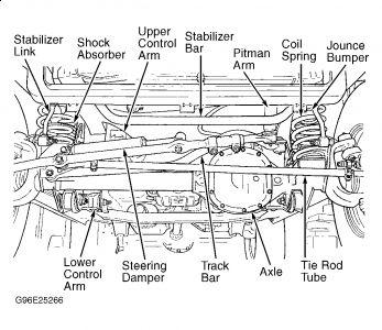

1996 Jeep Laredo 6 cyl Four Wheel Drive 200220 miles
when driving on the highway doing 50 to 60 mph, when i hit a bump or pothole the car shakes, i would have to literally stop short on the high way to stop it...almost got rear ended a couple of times
what's done so far ?
replaced upper and lower ball joint on both side, the U-joint
still there...what should i check / do next

Need to replace steering damper
https://images.2carpros.com/forum/automotive_pictures/198357_Graphic_442.jpg

Replaced the steering damper fix the problem for 2 days, now i am having the same shaking again...whatz next

Check tie rod tube to track bar ends for play should be zero
