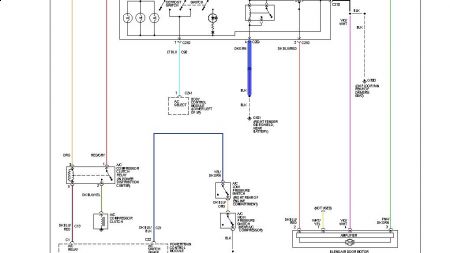

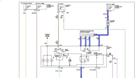

The blower motor started going off and coming back on; then one day it did not come back on. Replaced blower motor that didn't fix it, replaced the switch with no luck, replaced the resistor and that fixed it. Days later it stopped again the same way, so I went and replaced the resistor, but this time it did not fix it. What am I doing wrong?
Jan 20, 2010 at 12:14 PM
  • 75,992 POSTS
Hi karmacryptic, Welcome to 2carpros and Ty for the donation Check the ground point G101 at right fender side shield near battery and also test the high speed blower motor relay at right side of HVAC plenum
https://images.2carpros.com/forum/automotive_pictures/12900_h1_6.jpg
https://images.2carpros.com/forum/automotive_pictures/12900_h2_6.jpg
