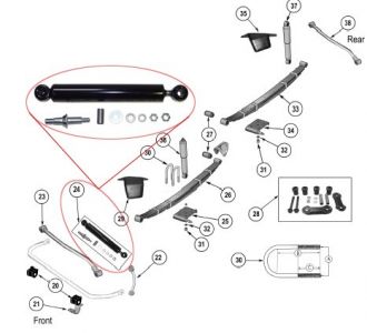

These have had a problem with a steering vibration dampner. You either need the superceded one form the dealer or a heavy duty one from the aftermarket. Probably safer going the route of the dealer on it, but you must tell them the reason for replacement. There is a service bulletin on this.
https://images.2carpros.com/forum/automotive_pictures/30961_dampner_3.jpg
