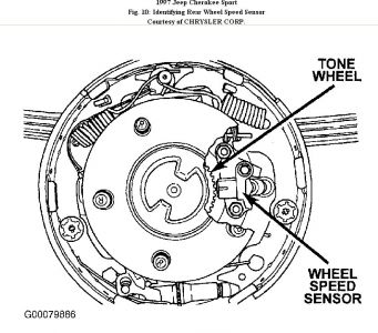

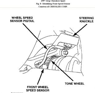

where the speed sensors and the ABS relay are located on the vehicle?
1997 JEEP CHEROKEE
4JPE

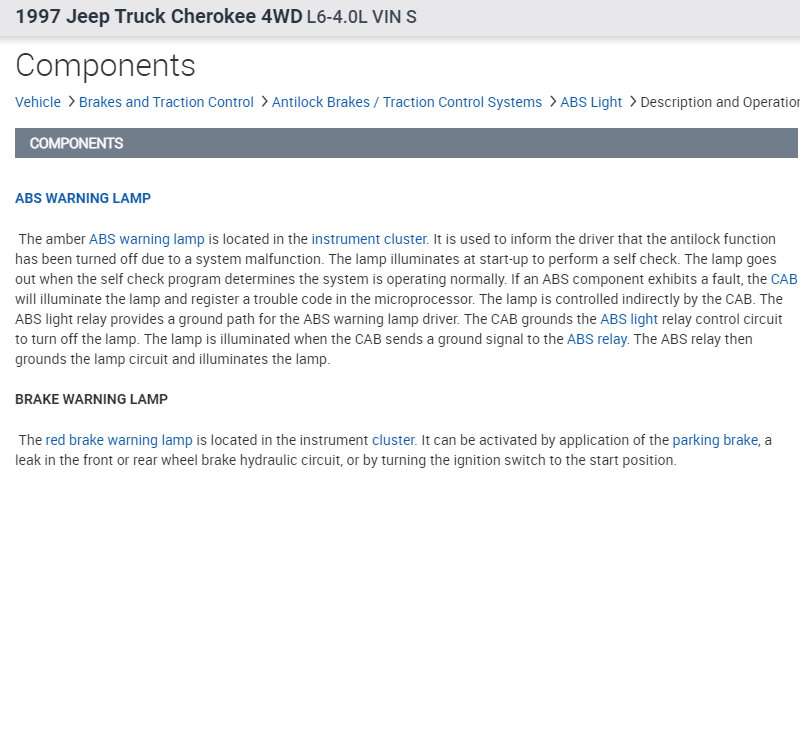

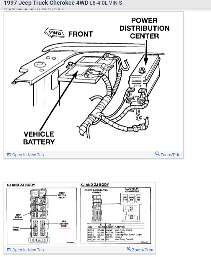

Hi there, could anybody tell me where the speed sensors and the ABS relay are located on the vehicle? My ABS light recently went on and I was told that one of the above might be the cause. I couldn't find any sensors by the wheels.
Aug 31, 2008 at 10:10 PM
SERVICE WRITER
  • 9,123 POSTS
Save yourself frustration and get the codes read from the abs module. IT may be a harness, sensor, cracked tone ring most likely, but you need to know which wheel to focus on.

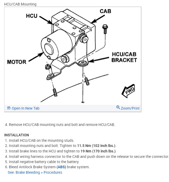

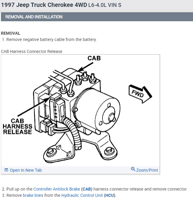

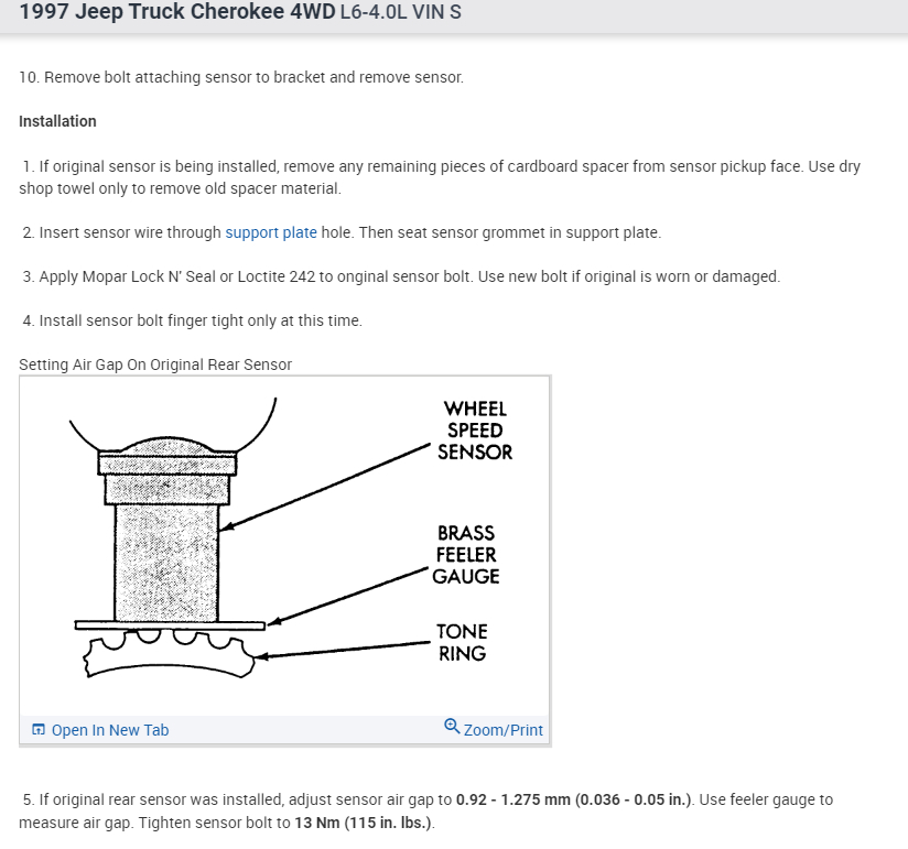

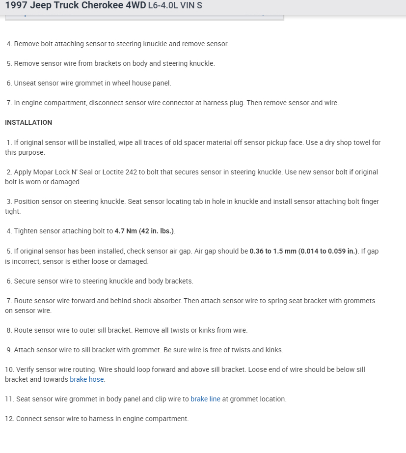

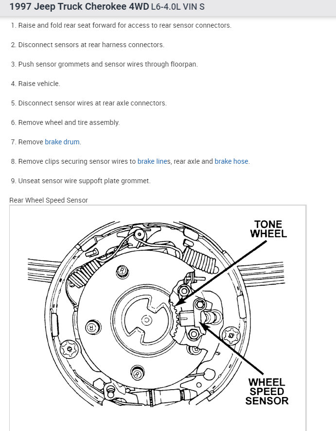

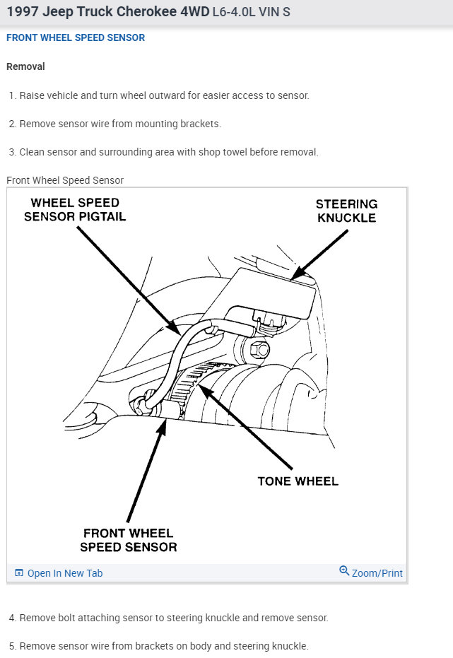

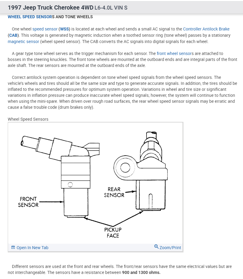

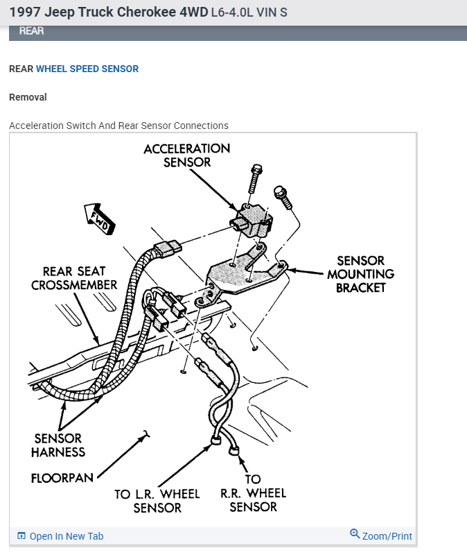

The ABS light gets triggered when the on-board diagnostic system detects a fault within the ABS system. It could be a sensor, wiring issue or the module. It can also be due to a loose sensor or connector.
The best course of action is to scan and retrieve the ABS codes, as that can help to figure out the issue.
Here is a helpful video that shows how to retrieve the ABS codes:
https://youtu.be/rTtAnsOlZU4

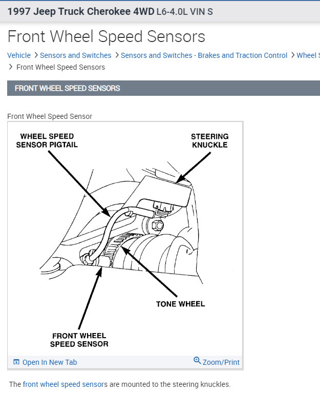

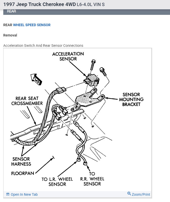

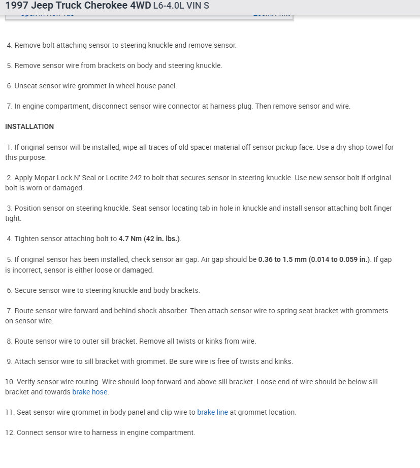

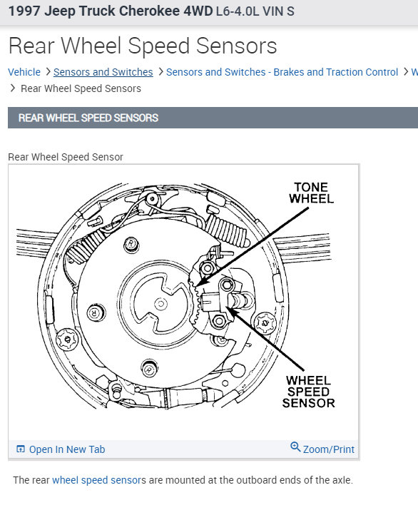

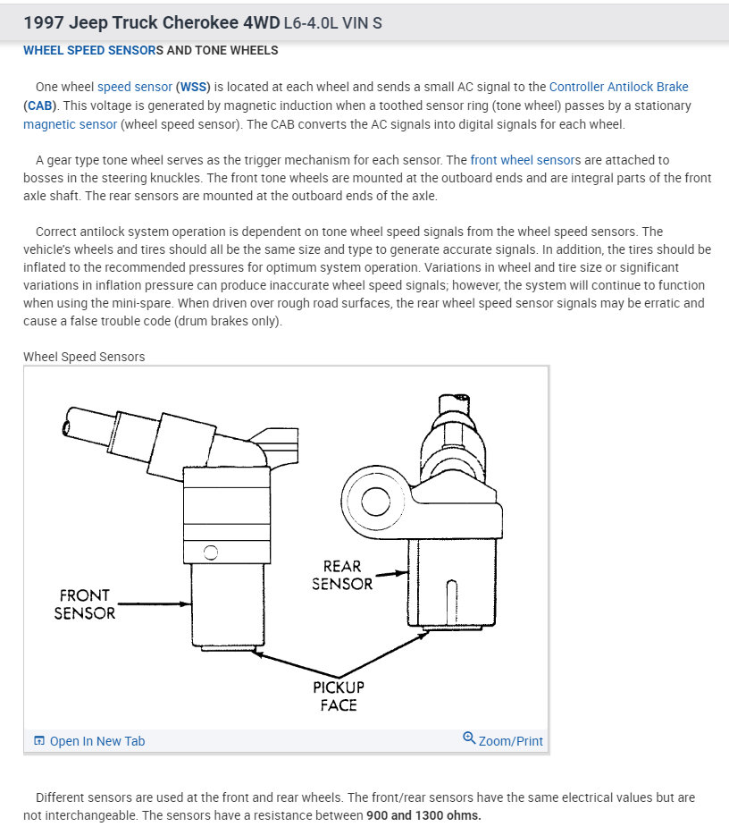

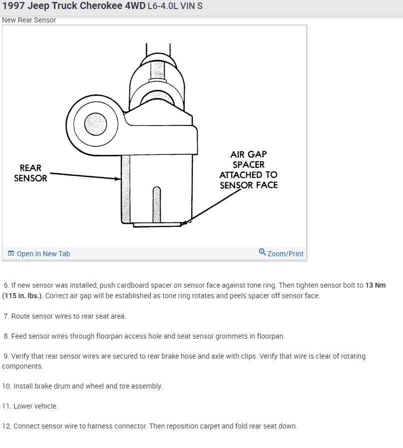

The rear wheel speed sensors are mounted at the outboard ends of the axle.
The front wheel speed sensors are mounted to the steering knuckles.

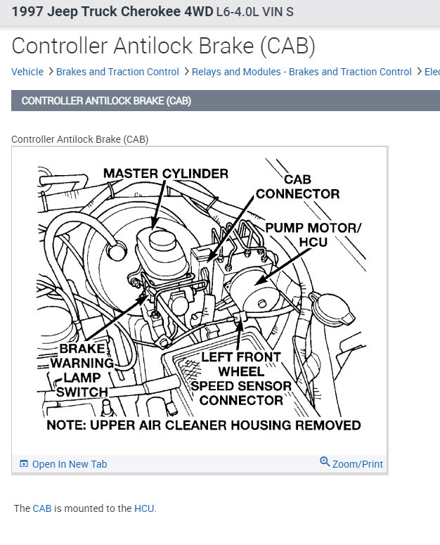

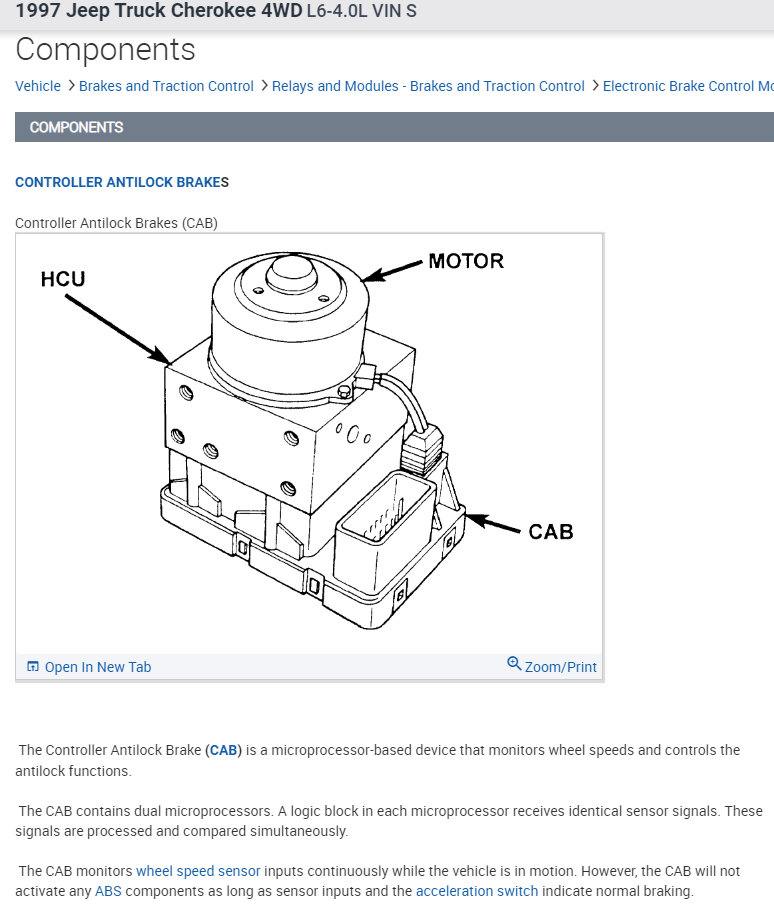

The ABS module is located under the hood.
I have attached diagrams for all those components and replacement procedures below.
