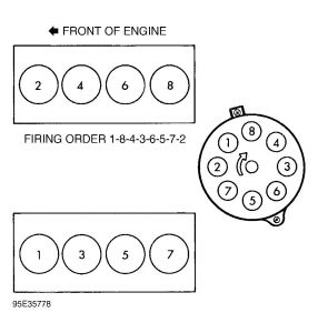

Can you tell me the correct routing for spark plug wires in my vehicle? I mad the mistake of pulling them all off, then having no clue which ones go back where.

Hope that can help
let me know
https://www.2carpros.com/forum/automotive_pictures/99387_jeep_v8_firing_order_1.jpg
