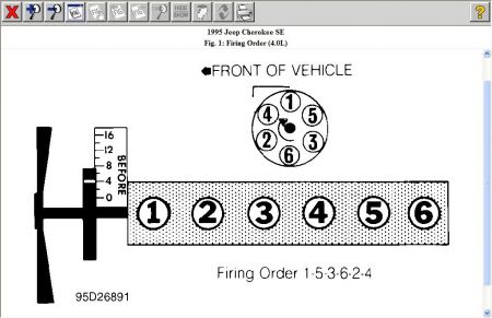

I own a 95 Jeep Cherokee and I did a tune up on it a while back. Somehow 2 wires got switched in the wrong place while it was idliing and it hasn't run the since. Is there a way I can tweak the engine to make it run like it used to and if so how do I go about doing this? Thanks.
Oct 23, 2008 at 4:43 AM
  • 75,992 POSTS
Hi Chris Haney and welcome to 2carpros Below is your 4.0L engine's firing order
https://images.2carpros.com/forum/automotive_pictures/12900_fo_20.jpg
