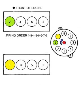

red is the coil wire
https://images.2carpros.com/forum/automotive_pictures/99387_jeep_v893_2.jpg

triple checked spark plug wiring and it is in order.
